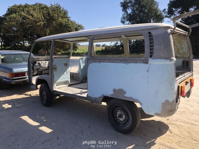

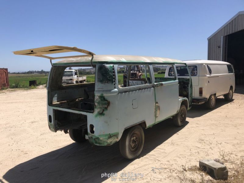

I see its also been more than 2 years waiting for this project.
The 69 bus was #3 at the sand blasters.
More pics to follow tomorrow as well as #4 bus. Progress has been a bit slow lately, so 2019 must see at least another 4 restored kombis put back on the road.

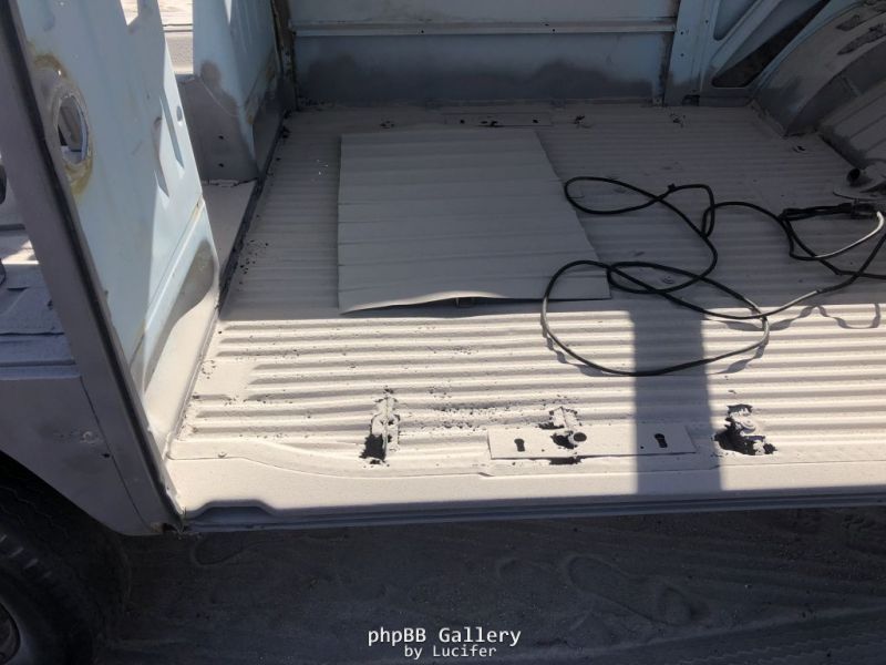

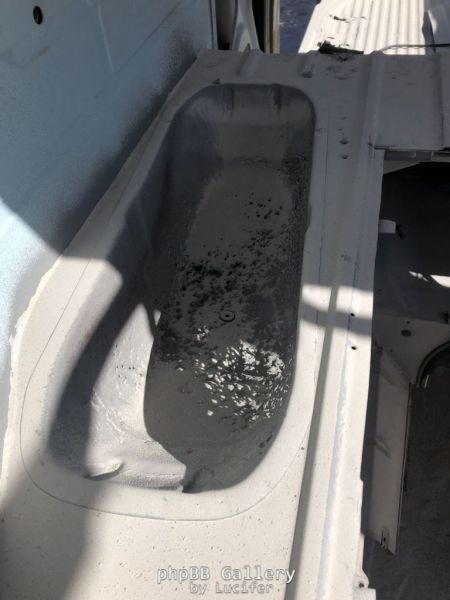

After sand blasting.
Spare wheel well full of holes. :evil:
Cargo floor also full oh holes. :evil:
