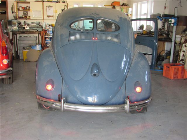

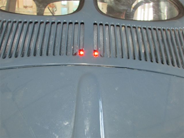

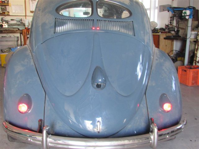

Managed to do a discreet job on the 3rd brake light, without it looking too bling.....
Made a "L" shape ABS section, and drilled two holes at the correct angle, and spaced the same as the center two ribs in the air intake.
Painted it all black and fitted it just inside the vents with the two LED's peeping through the slots.
Wired to the back taillights and here is the result.
When off, you can hardly notice the fitment,
Now hopefully, the other guys will notice the brake lights.....

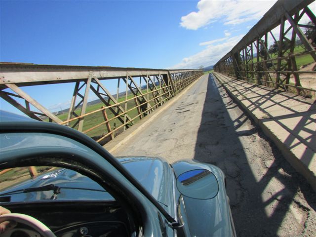

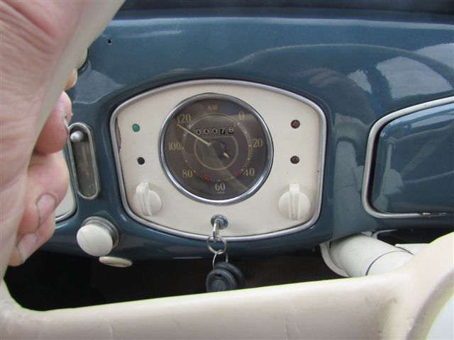

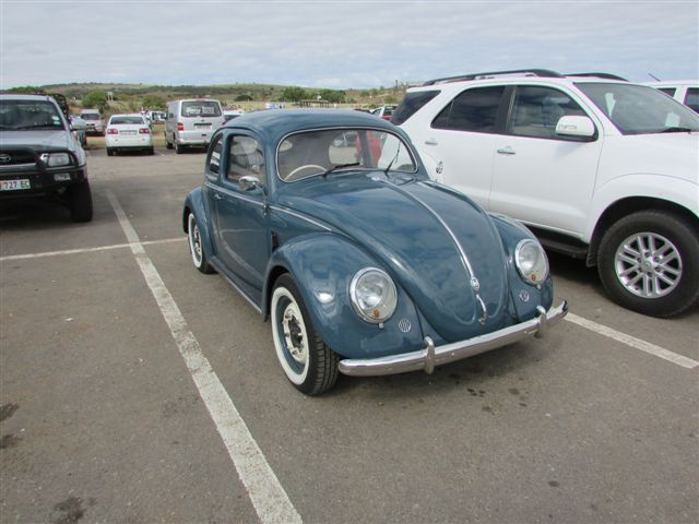

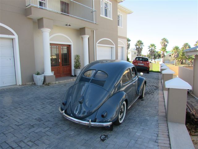

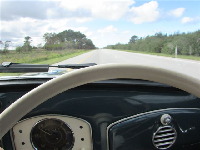

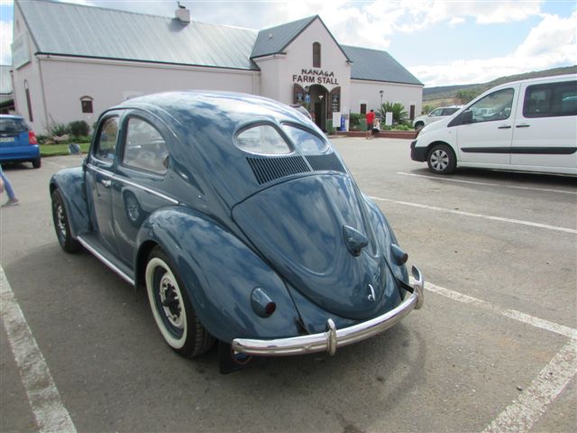

So I decided to take a trip from Jefferey Bay to Port Elizabeth and Back.
This went so well that it was extended to Nanaga Road Stall about 55 Km outside of Port Elizabeth on the N2
For safety sake I ran on the high way from J-Bay to PE, and then through to Nanaga.
On the way back we went the old Port Elizabeth to Cape Town road being the R102 as this was a much more scenic road and I had the confidence that the car was sound and would not break down.
She ran like Swiss clock work, only stopping a few times to set the timing.
This I always do on the run, as the engine will tell you where the sweet spot is, and where she will be happy to run for ever at a purr.
Made it back after 185 KM round trip, and she is now ready for her 1st Oil change, so we can see whats in and whats not in the oil.
Here are a few pic's, the rest is in the road trip thread......
Running out of J-Bay to PE on the Highway..
Running sweet ..
Stopped at Nanaga...

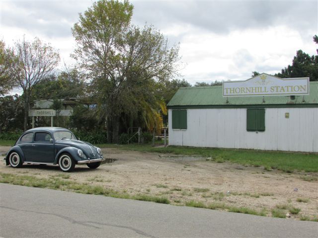

On the way back at Thornhill Station..

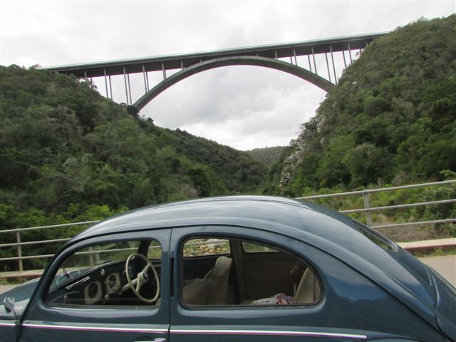

Van Stadens Bridge ...
Bridge over the Gamtoos river..
And back Home.... what a nice trip..
