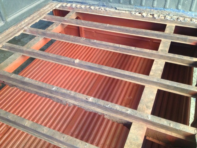

I also started removing the rear floor, it came off quite easily. I just started wracking with a hammer and was able to remove that floor like opening a tin can.
