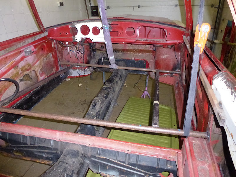

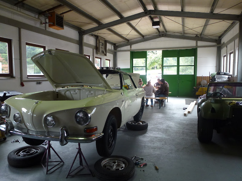

Hello,
here some pictures from my work...
new floor panels from Columbia
after painting
With greedings from Germany
Michael

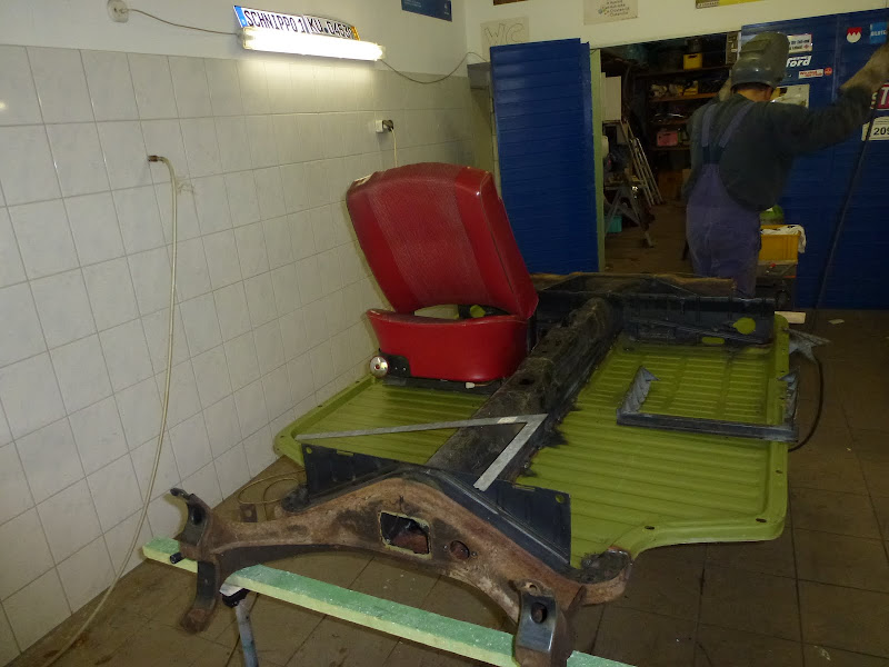

because after welding has been completed on my 1966 T34 and the body now needed to be dipped to remove the rust. After welding, the biggest issue is one of corrosion protection. To avoid any rust developing after the restoration was completed I decided to have the body completely submerged in a three-part process. The first dip is to remove the paint. Then we de-rusted the body in a second acid bath. In this process all of the voids which can’t be cleaned manually are taken care of. Then the body is submerged in the third bath which coats it with a protective layer of Cathodic electrophoretic paint. This gets into all of the cavities and protects the body against future corrosion.

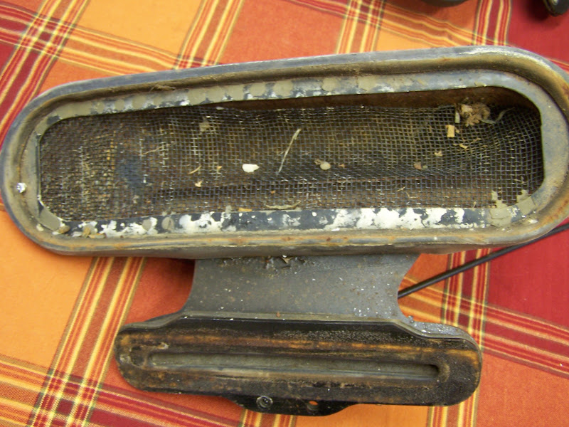

is a long way...
I think is better I need one or two years longer for the work, longer but than with good result ...
small parts cost always a long time
example the fresh air thing... :D
cleaning and powder coating
ready...
and now in the car..left and right

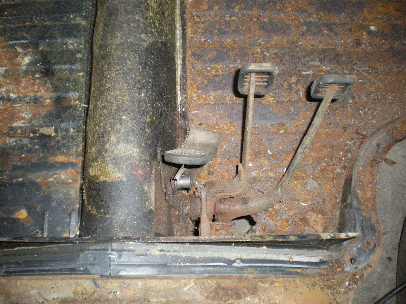

the floor panel was a nice work
corrosion complete..
new floor panels are from Gerson in Columbia... http://www.klassicfab.com/
fantasic material.. Quality is perfect.
for me was important to weld later the fix-points for the carpet and the seat holder on the correct position.
