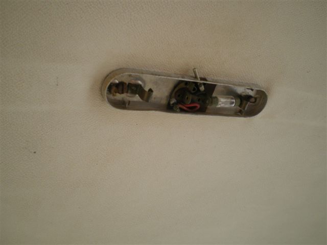

The interior light I believe is a Split type light ?? Only need the covers, will make the rest work....

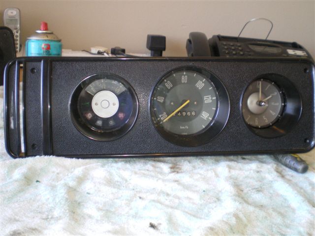

The instroment panel is looking good, still wish I had a clock for it.<>>>>

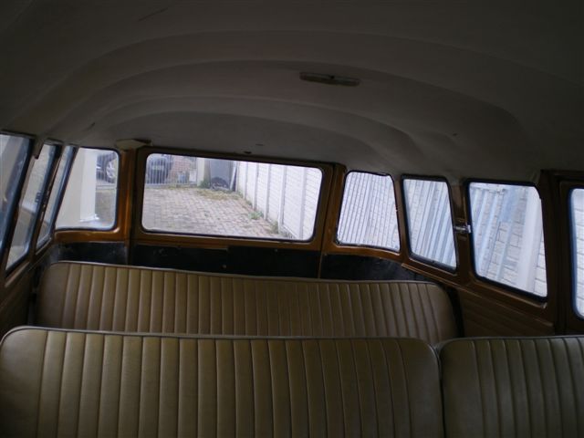

The inside of the Fugly, is not too bad, will bee fine for a few years..

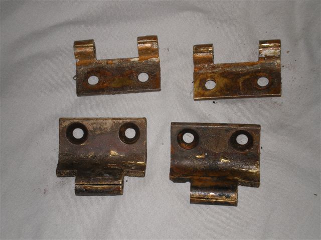

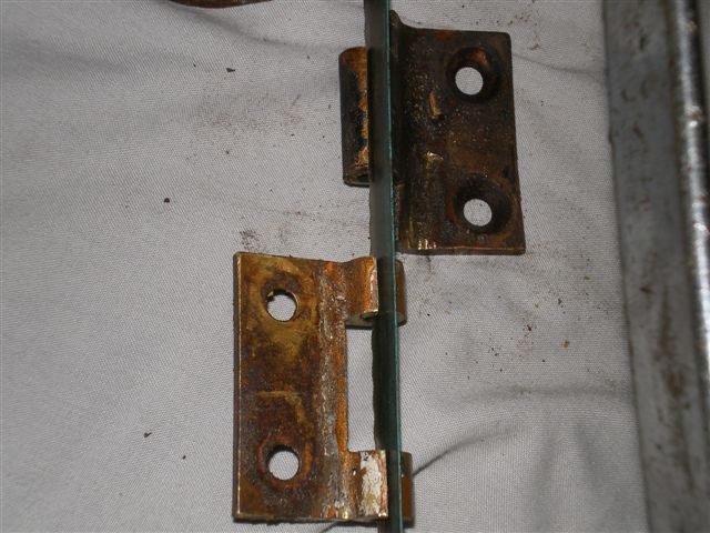

Could not get the pins out of the engine hatch hinges, as they had broken off, and would not budge, even with heat, so I cut the Brass hinge and freed the pin, then they cam out.
Now I will be making a new shaft and refitting them, all working....

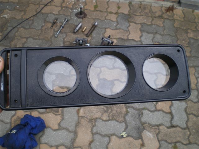

With all the rain, and the Fugly standing outside, there was not much to do.
Dragged the Dash inside, with a lot of screaming and shouting from the little women, but, a man must do what a man has to do.....
Striped all the parts I had, serviced them and took the best of both worlds.
Now I assembled it again, and I like the "New" look
Now some of you hardened VW Bus fans will be able to spot some discrepancy's here, lets see if you can spot them.???
Can say that the dash is made of 3 model's parts,
What is your comment of the final look of it, as I feel it matches the "mixed up" Brazilia thing.

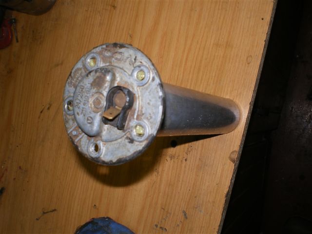

Well as above, the Bay fuel sender was to long, and as getting a correct one (think its same as Splitty) seamed impossible, I had to do the next best ting.retrovan wrote:......
The fuel sender unit is maybe the same as the Split as well, because the 211 919 051 will not fit
Opened up the unit, and ensured that all was working well, before the big hack job started.
Now those that need a Splitty sender, and can not get one, maybe you should have a look here....
Removed the nut from the bottom centre shaft.
This released the outer tube.
Remover the nut and unwound the thin wire from around the bottom spreader bar.
Removed the plastic spreader bar off the centre mounting rod.
Extended the M3 thread with a die nut, down the nut, for an extra length of 25mm.
Screwed on two M3 nuts and locked them in place 25mm down the shaft.
Fitted the spreader bar, and locked that in place with a nut.
Retreaded the thin wire back around the spreader bar and shortened it on the earth spring by re soldering the end.
Cut the outer tube by 25mm, and cleaned the edge, and filed in a short groove to locate the tube in place.
Fitted a lock plate and nut.
Cut the extra length of shaft that was now protruding from the outer tube, off.
Tested and fitted it back into the tank.
Now I have a Splitty sender for the price of a Bay Sender........
