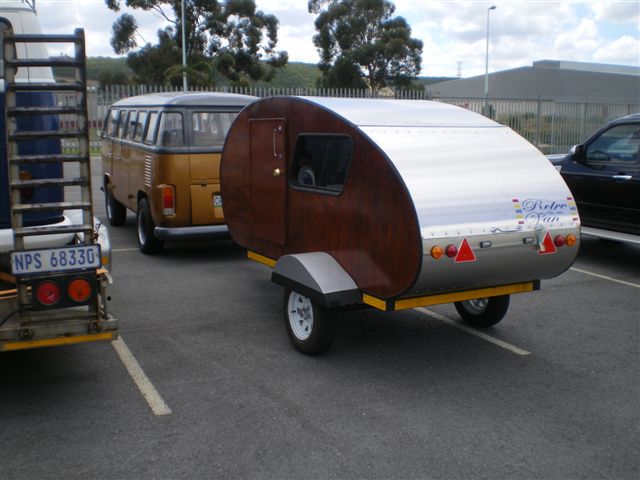

Well guys the Fugly made it.
With only a few Km on the clock, off it went on its maiden voyage.
Just to ensure a good test, I through on a Teardrop Van on tow as well.
So off to George, with only one minor problem for the trip.
