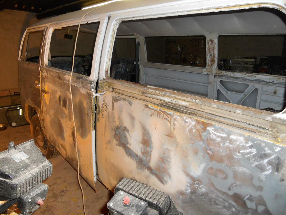

Hi new to the site, bought my baby "Bumblebee" a couple of months ago,, got her home and started right away,,loving every minuite of it!This is the dream,, will get here in the next few month's,,,I hope
This is the reality at the moment !

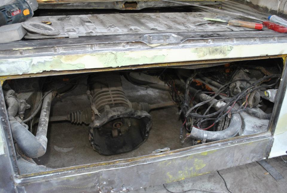

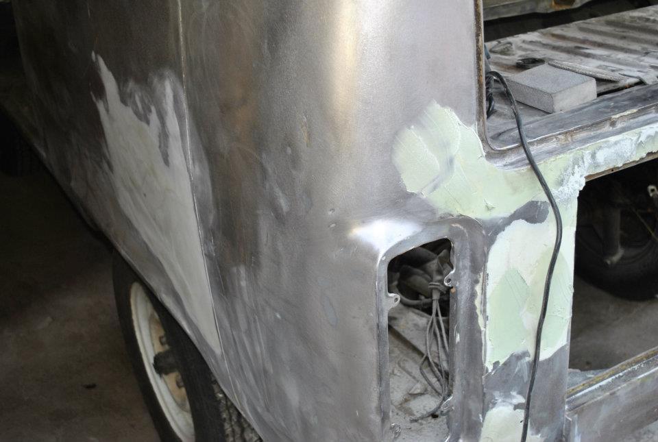

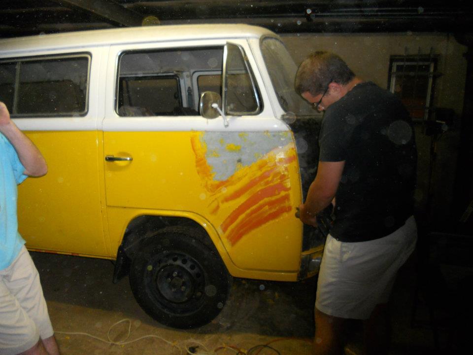

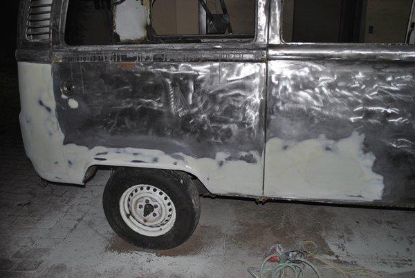

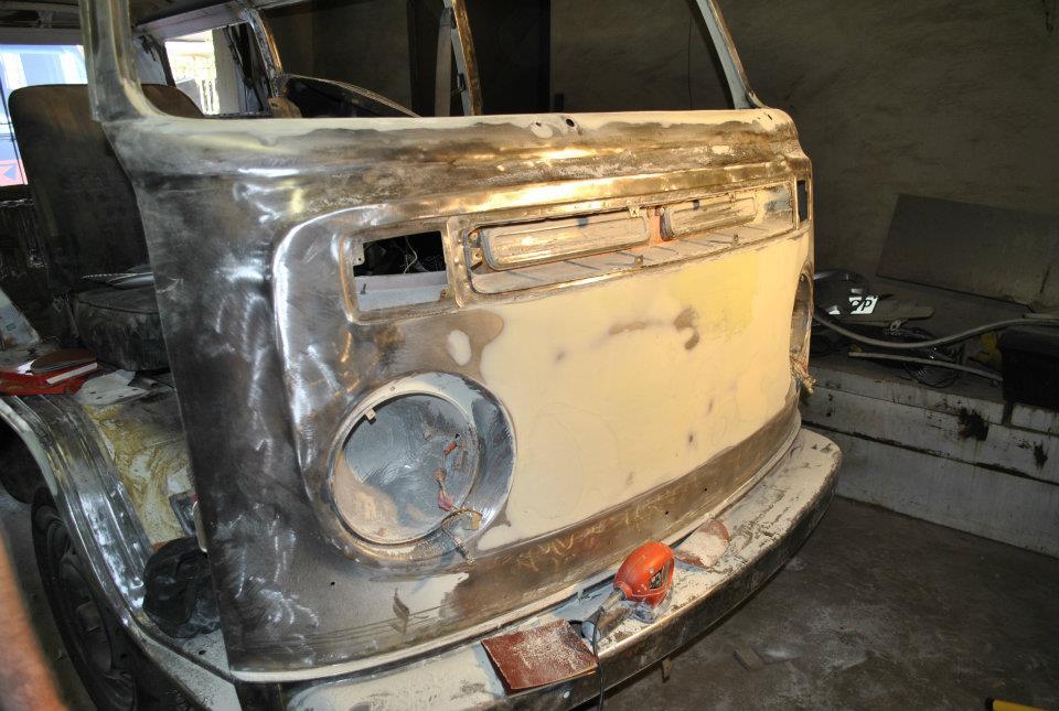

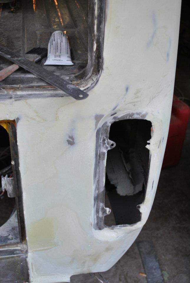

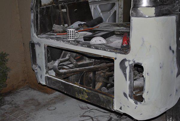

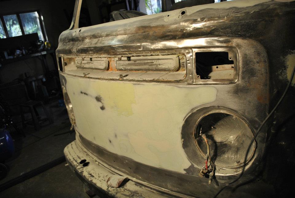

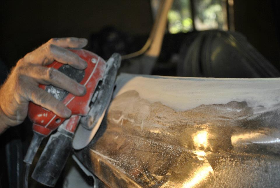

The bus came with a toyota TD motor with a blown head, have removed it and will be putting in an 1800 golf unit which I have purchased and am in the process of rebuilding as well,, the bus had been painted with yellow enamel paint which was a bitch of note to get off,, put a sanding disc near it and all you got was yellow cobweb's flying everywhere,, there was a bit of rust but nothing crazy,under the windscreen, under the two back windows and around the battery housing,, little bit's here and there which I have cut out and fabricated parts out of .8mm steel and welded in, there was a fair bit of body filler around which I have removed ,beaten and re done,, most of it 2 or 3 times as this is a huge learning process but I'm getting better at it as I go along, I will say I'm spending most nights and free weekends in the garage and loving every moment of it !!

Nice! I like Bays a lot. Was it necessary to take it down to the metal? How do you keep the surface rust away? Have you used paint stripper or was all the paint removed by abrasion.

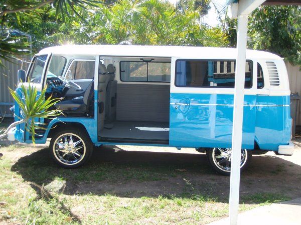

If you want non standard how about this:
or this:
or if you really don't like domes, what about:

Drusky wrote:Image
Oh my . . . !! Where is the droooooooooooooooooooooooooooooooooooooooooooool smiley ! :hangloose: :mrgreen: :hangloose: :mrgreen: I think I wet myself ! :oops:

Post by stuart1 »
@ Drusky,, decided that I wanted to only do the van once so thought it best to start with a clean canvass, have used very little stripper(just in the really crappy places) used a heat gun, wire brush and sanding discs, I will use deoxidene soon just to remove any surface rust and coat the steel before spraying, this is the first time I'm doing anything like this so it's a serious learning curve for me,, looks so much easier on you tube LOL !

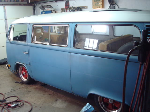

That looks like a nice solid bus. That first pic of the blue and white bus, is that what you are aiming for ?
Best of luck with the rest of the project, keep the pics coming, where about is your steel fabrication business ?
Cheers
stuart1
Posts: 31
Joined: Wed Feb 15, 2012 8:48 pm
What model do you have?: 71 bay (I think)
Location: Centurion
Re: My mid life crisis !
Post by stuart1 »
@Jolas,, yes thats the look and colour I am aiming for,, my business is in Centurion !

Hi Nice work
Do support the gearbox in a horizontal position, You run the risk of damaging the cvs but more importantly the gearlinkage
Regards
