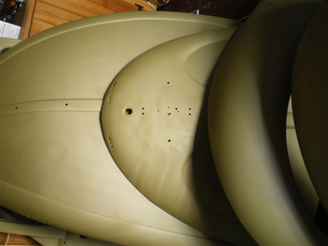

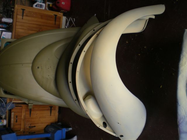

So the Soda Blaster was a Total Failure.
In all this time, he just managed to blast the bonnet, and half a door.
The bonnet, has totally rusted again, and the door, I was told "was not possible to clean" due to body filler.
Got so mad, that I removed the parts from him, and handed it to a local powder coater, here in PE, and he blasted it perfect in two days.
Even cleaned the body filler, and when asked, he asked,"what problem?"

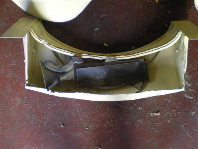

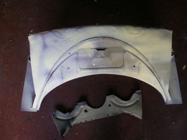

Due to much body filler on the apron on the engine bay, I decided to cut the whole back off and split the double skin, so that I could panel beat it.
When done, I copper primed it before doing MS epoxy primer. This will keep the rust at bay.
As I have now got the apron off, I decided not to weld it back, but as has been done here before, I will be bolting it on when painted.
This will allow me to fit the 1835, OOOPS, did I type that ....., The engine in and out with out having to remove all the carbs, and other parts to get it in and out.
Make life easy I say...
