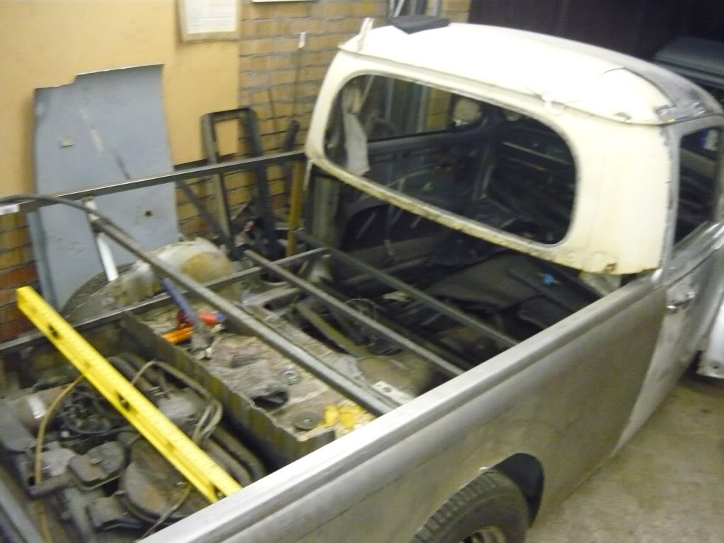

[quote="MINCE"]Image
WHO can identify the Back body section that he has welded on here, which car is it from......??? :?:
Fits darn well, Nice cut and paste..... :shock: OK , sorry, :oops: nice cut and weld..... :roll:

MINCE wrote:Image
Hey, what's happening with the rear hubs on this 'dub?
Lost in transport or is that photo shop ?
Certainly keeps the drums cool :)

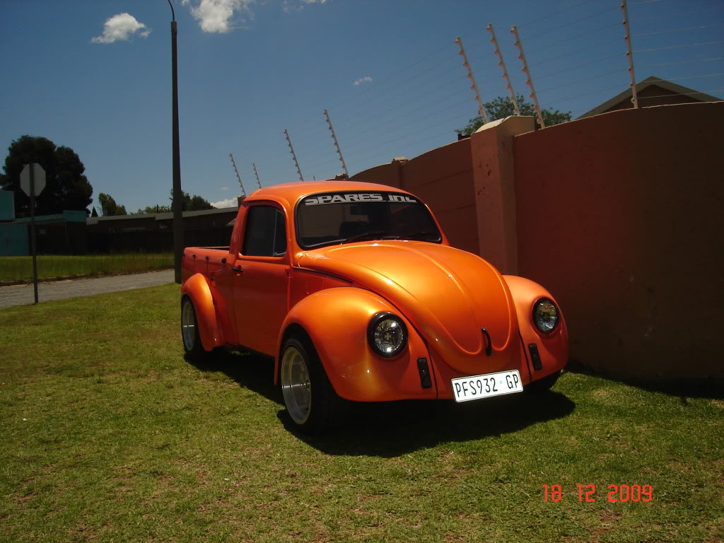

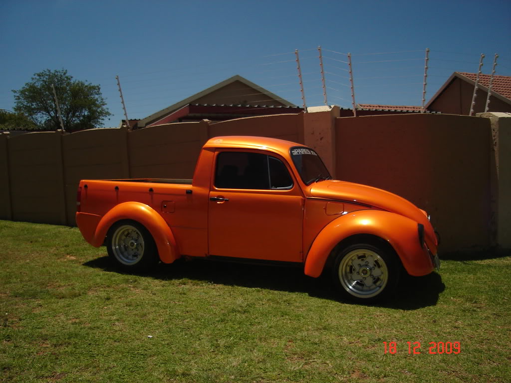

Ive been having the same idea in my head for a long time and the orange one is my insperation
I would fit two identical roll bars --one inside the cab—to shape the body around and to support the roof.This will be extend to the front under the door sills. The other r/b will be outside the canopy witht extension to the torque tube and another brace to the shock tower –this will be underneath the loading platform.
The two roll bars will be bolted together with shiny bolts with rubber grommets where it goes through the body. The insde one can be covered up if you don’t like the look of it.
Load platform- I will use a Nissan 1400 floor and sides (inside)cut to size.
Engine- t3/4 flat engine with engine cover open at the top.
Air intake on the sides between cab and rear fender.
You can also go d/c
Or you can find the owner of the orange bakkie and buy it -- Much easier – That bakkie is realy cool and well build
cheers baron

retrovan wrote:
MINCE wrote:Image
I saw this post on Volkzone - the guy took a profile and had them rolled out at work. Being in IT, no one around here is going to roll something like that out for me (except in photoshop I suppose!)
*EDIT*
Ok, now that I read your post properly - the rear section is from an old Austin Truck - not sure whether one would be able to find something like that around here...

davetapson wrote:I saw this post on Volkzone - the guy took a profile and had them rolled out at work. Being in IT, no one around here is going to roll something like that out for me (except in photoshop I suppose!)
*EDIT*
That is a nice cut and weld. You can check the work in progress on the right hand side!! I guess one could use any bakkie with a lekker profile or an old 2 ton truck!

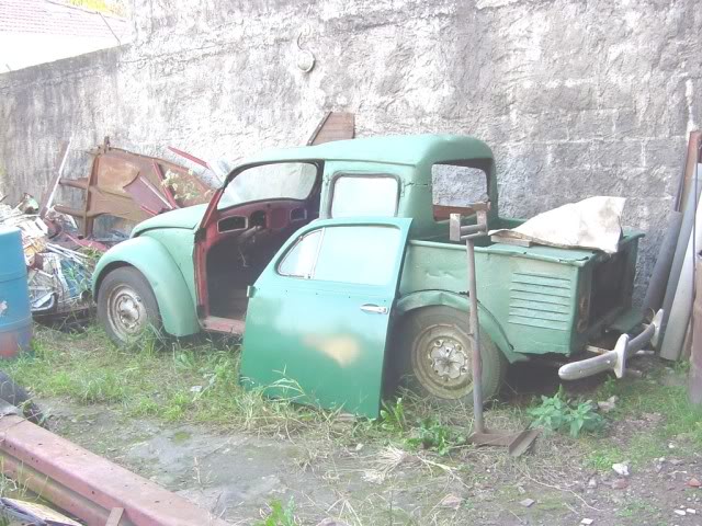

this was seen just past, Westgate shopping center, its taken me a while to find the pics
BAB
