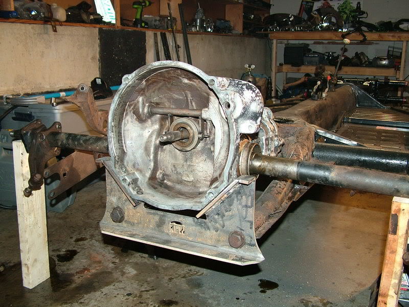

Re: Porsche 356
Going for the "Select-a-drop" on the front beams. And the rear end - lift engine/gearbox by 50mm then a couple of splines on the torsion bar.
Gear lever is the only trouble I can see.
"Shit happens"
- Posts: 4195
- Has thanked: 36 times
- Been thanked: 50 times
Re: Porsche 356
50mm lift on the engine gearbox would mean not needing to adjust any splines. KCW in the states reckon that you can do a 2 inch (50mm) lift without moving the gear lever.triton wrote:Going for the "Select-a-drop" on the front beams. And the rear end - lift engine/gearbox by 50mm then a couple of splines on the torsion bar.

Re: Porsche 356
How does that work?flatfourfan wrote:50mm lift on the engine gearbox would mean not needing to adjust any splines.
- Posts: 4195
Re: Porsche 356
Maybe this thread should be moved in projects Eben???
You lift up the gearbox/ engine from the nose cone and the frame rails as well as install a midmount. (this mod is not for the feint-hearted)
http://www.kustomcoachwerks.com/forums/ ... php?t=2739
In a stock AC set up you have to look at the following.
-Clearance partial shelf above the bell housing
-Clearance partial shelf above the nose cone.
-Cut rear and side engine seal areas out of the engine bay
-Notch frame horns and weld mid mount in place.
-Re-dimple hockey stick so that the shifter work correctly
-Install nose cone
-Install 36 horse style fan shroud
-Fabricate or modify and aftermarket exhaust to clear apron.
This is a 2inch lift in a beetle.
-Install nose cone

Re: Porsche 356
If I lift the main engine/ gear mount up by "say" 50mm (Weld two engine mount together - top of each other) the rear one could move up by 25mm max( new bracket with old mount ). Would the engine/gear not be at an angle and cause oil problems. I would need to adjust a few degrees on the splines too get neg 1 degree on the rear wheels. Any thoughts - I see this done on http://www.volksrods.com forum.
Shame - I just tossed the old skocks and got new ones on. I need to drive the little first to see how hard it is.
