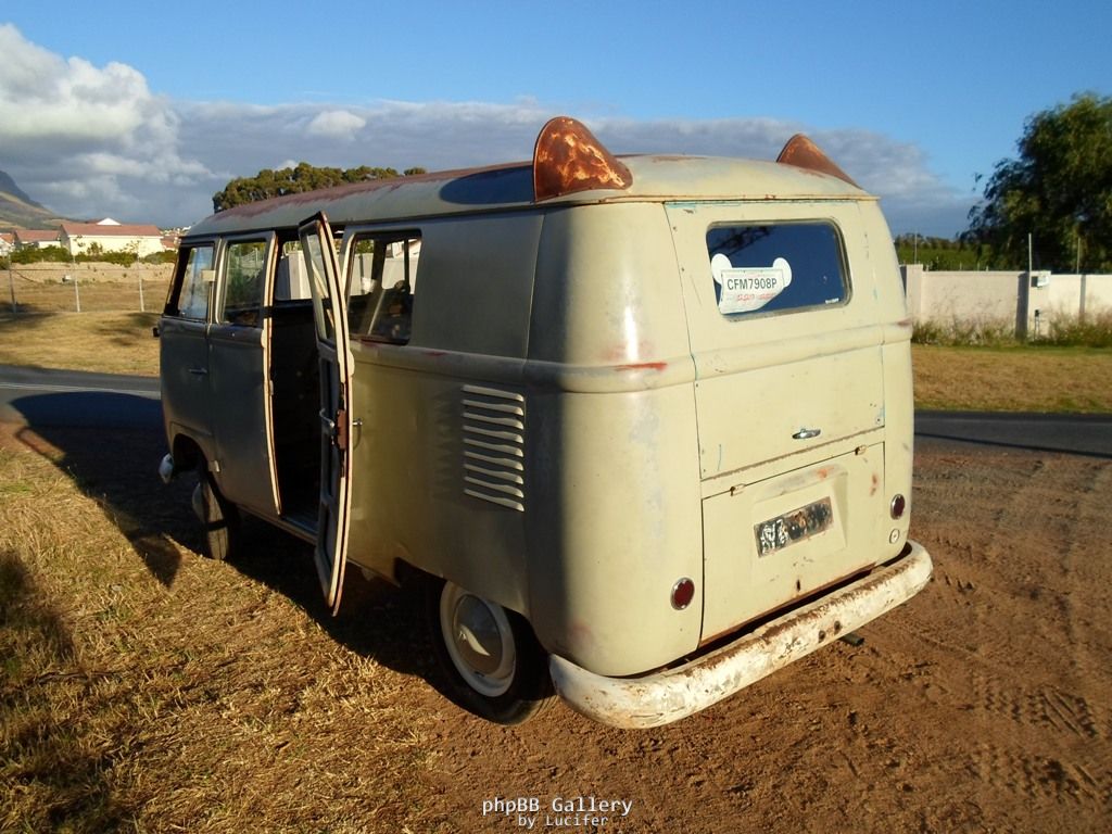

Well this last holiday hasn’t gone by without doing any work on the 59.
I have finished with the blending in of the new panels. It came out better than I expected it!
There are still a few more ideas I have to try blend it in to the patina that its not such a distinct line between the old and new paint, but will experiment a little later with that.
400g of fibrespan bodyfiller and about 100g of the ultra fine filler is all that was used to complete all the blending of the body panels. A few coats of primer, flatting it out and then a few coats of the top coat revealed quite a “new look” to the worked on areas. I normally flat the top coat with a 2000 grit wet/dry sand paper but this proved too soft for this blending, so opted for a 320 grit which worked quite effectively at dulling the new paint. I finally went over with a 1000grit and gave a it a light polish (the whole bus now) with Maguires quick detailer, (quick polisher / cleaner) which gave the whole bus a bit of a shine, but still leaving the dulled effect on the new paint.
The colour match in some places is near 100% and other panels a little off, but overall I am pretty stoked about how it’s come out.
Oh, and the wheels look a little new at the moment, think I am going to give them the same treatment too.
Enjoy the pics.
