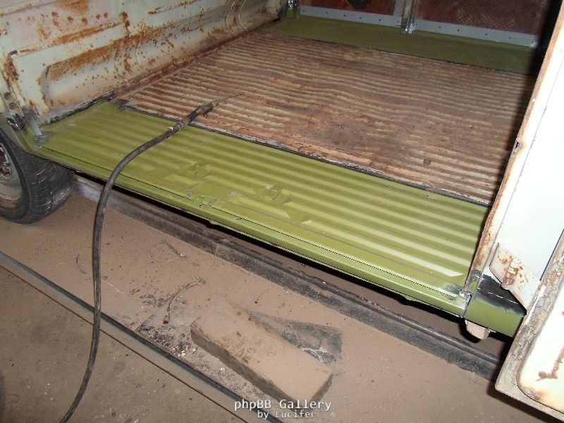

I moved over to the cargo floor repair sections too. It’s quite a job drilling out all the spot welds; my Fleetline for some reason was much easier to remove, I just folded the floor over and hit the hell out of it which broke the spot welds, not on this German bus though.
In the process of removal.
Trial fitting floor repair sections.
Since this pic I have tried straightening the middle part of the floor since it was seriously wobbly from loading over the years. I managed to line it up with the new sections but it isn’t great. I am going to carry on next weekend with this job.

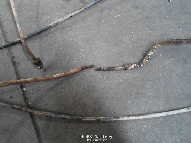

Lastly I was a bit gatvol from the back braking work inside so opted for underneath. I tried to see if I could blow the brake lines clean, but didn’t have any luck. I then decided to remove them and it showed why I had no luck. They are completely rusted, basically everywhere where it went through the chassis sections.
Here’s just one part. I will send these in to have some new ones made up.
The clutch and accelerator tubes were also rusted beyond repair, I cut the old ones out, bent up some new ones and welded them in.
The accelerator tube was relatively easy as the pipe was quite bendable but the clutch turned into a real bastard. As the pipe was too ridged I had to bend it in the pipe bender beforehand and then try to fit it through the chassis rails.

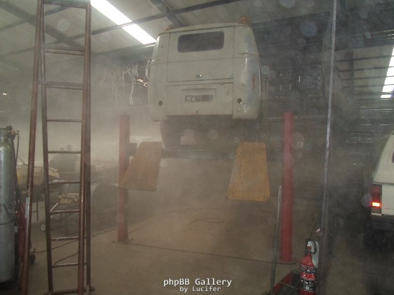

With the floor sections out and before I welded them in I made sure all the sections were clean from all the years of dust and mud. I made use of the air gun which worked well, but it turned the entire factory white and covered me head to toe in dust, what I hideous job.

sean wrote: it turned the entire factory white and covered me head to toe in dust, what I hideous job.
should have done that outside rather...
that must have been quite funny :lol: from the pic it looks like you are working in the mist ! :lol: Gorillas in the mist....luckily there were no staff at work !
