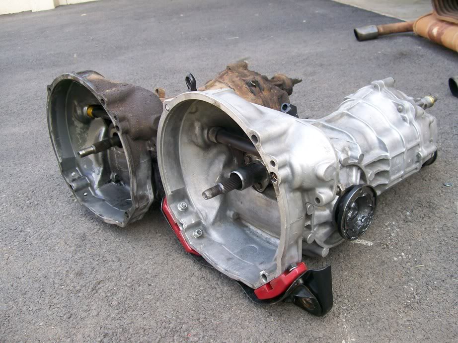

Eversince I got the Khaki Cruiser, she would occasionaly jump out of fourth gear, especially when flooring the accelerator, in other words when more power was put through the transmission. I've adjusted the gear lever, and the problem even went away for a few months, but came back worse than ever a few weeks ago. According to the guys who know, it is most probably due to long-term wear (hell, the poor car is 40 years old this year) either/or due to low gearbox oil levels, or because the previous owner drove it with his hand constantly on the gear lever, causing more friction and wear in the long run.
So on Saturday morning HW2 donated its gearbox temporarily to the Khaki Cruiser, and I did the exchange. Unfortunately I only realised late Saturday evening that I need a different release bearing, and I could only get a new one yesterday morning.
By around 16:00 yesterday afternoon, the Khaki Cruiser was running again with its new Bugger box - and the 4th gear stays put!
The two boxes next to each other, old Type 3 IRS to the left (the remains of some river crossing recently with all the rain here in Gauteng can be clearly seen on the top..), and HW2 1303 IRS box to the right.

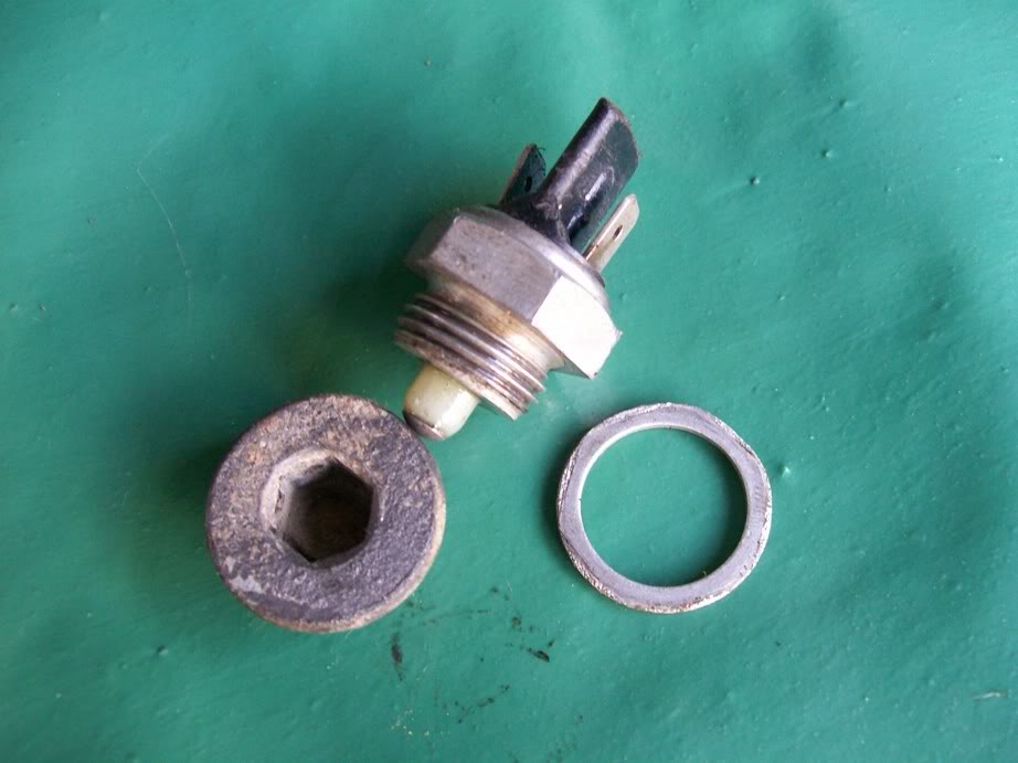

Although the Khaki Cruiser has reverse lights on its rear lenses, the reverse light circuit wasn't fitted in the factory, and the bulb holders were blanked off. (Reverse lights were not compulsary in 1970, and fitting them was probably only a dealer/factory option for higher spec vehicles.) So installed the reverse light switch, so that she can have functioning reverse lights for the first time in 40 years! Pictured next to the switch is the old factory-fitted plug.

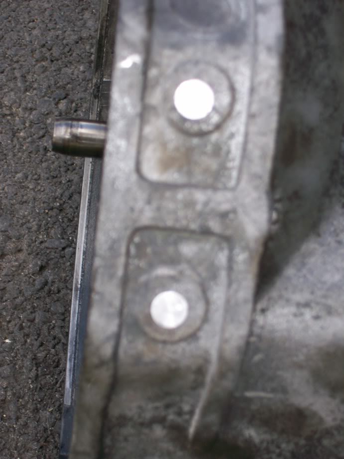

There was however a small glitch, which I didn't mention earlier, and that was that I did not have reverse gear at all since last week when I put the other box in Bugger helped me this morning to do a small modification on the dimple of set screw of the 'hockey stick' below the car. It seems like there is an eversoslight difference between the Beetle and Type 3, but it is A-OK now.

I got this reply from TheSamba, after my reverse gear problems, something to keep in mind in the future...
Yes, very common problem. The bug trans shifter shaft has the dimple on top, while the t-3 has it on the bottom. Some of the later tansmissions use 2 dimples, but the bottom one will be off.

What Pine is trying to say is that even some bug Hocky sticks have both dimples one on top and one facing down to mother Earth
The one facing down to mother Earth is not on the right spot where a Type 3 dimple hole is
When this dimple hole is used then you will only be able to engage the 4 forward gears and the inner Gear shift rod will be to much to the right as to be able to move more to the right to select Reverse Gear
As when I did the HW2 Tranny it had a 2 dimple hocky stick on and Pine thought the bottom hole would be right but it ended up off center so all I did was to help pine not to remove motor and transmission just to change to the original Type 3 stick I used the Pencil gringer and slotted the shaft to the level position and now he had his 5 speed transmission what he Paid for
