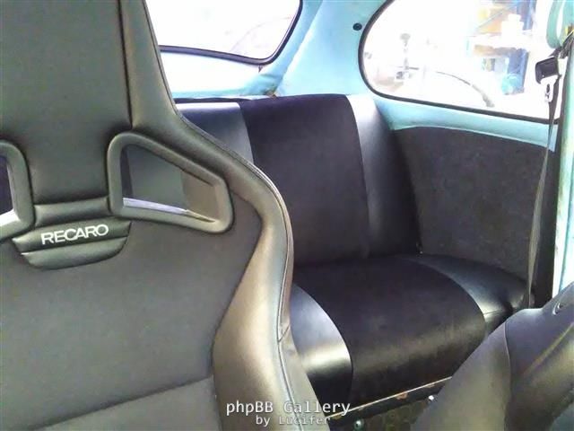

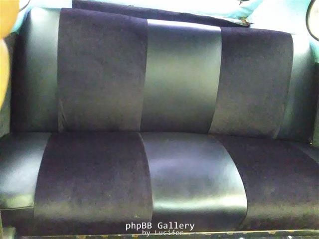

Since I will be needing an upholsterer at some point for my 1302, I decided that after 22 years of owning Angrrr, its about time to get the rear seats done to match the front. The tatty old seat covers were really showing their age and the red leather underneath didnt really match the car...
The result was OK. Its not the greatest job in history but its not bad. And once he uses better materials for the 1302 I think it'll come out quite nicely.
Also, we tried to match my Recaros, but our material options didnt come as close as I'd have liked. That said, it doesnt jump out at you and you wont really notice through the window.
And again, this isnt a show car...

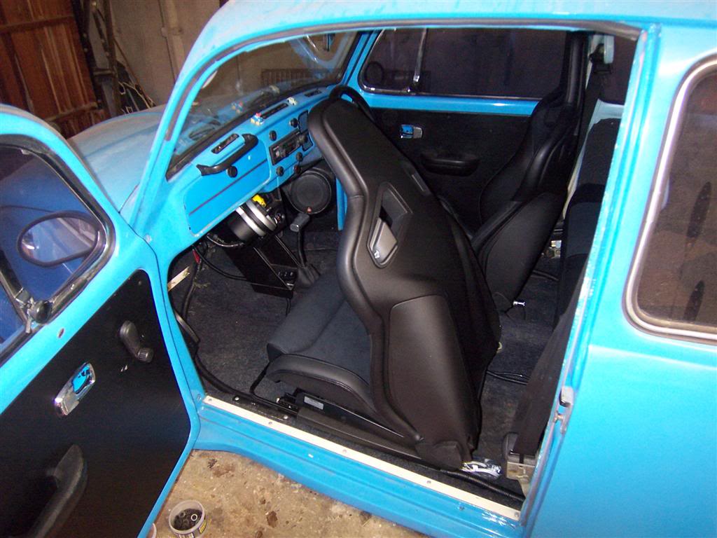

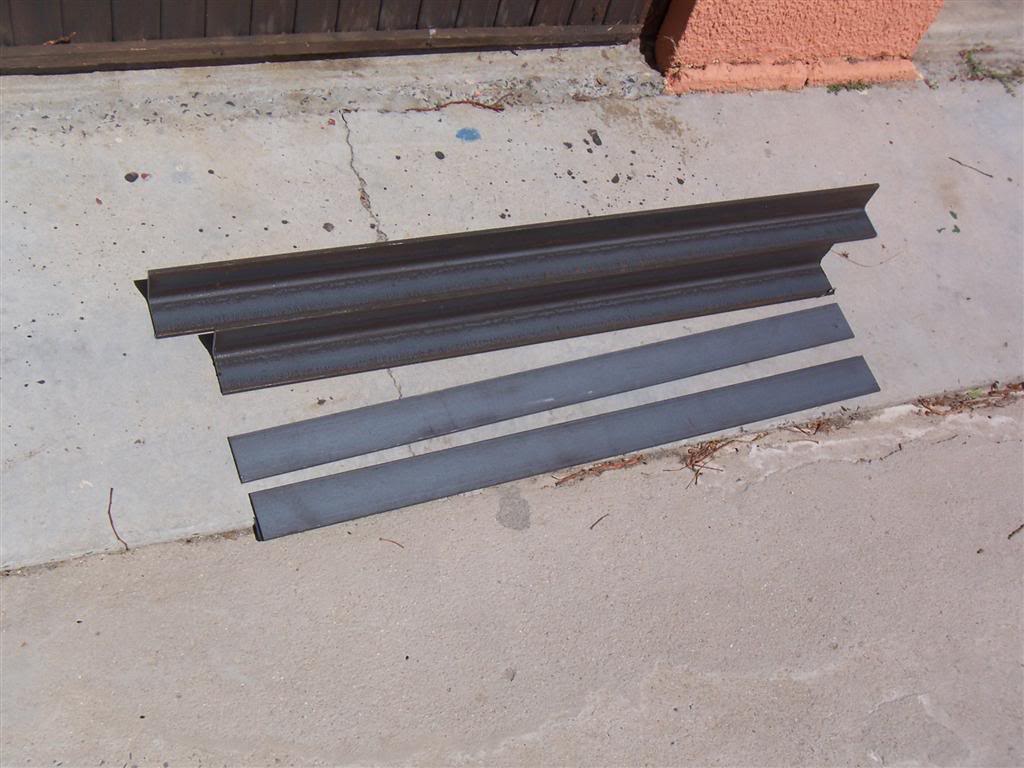

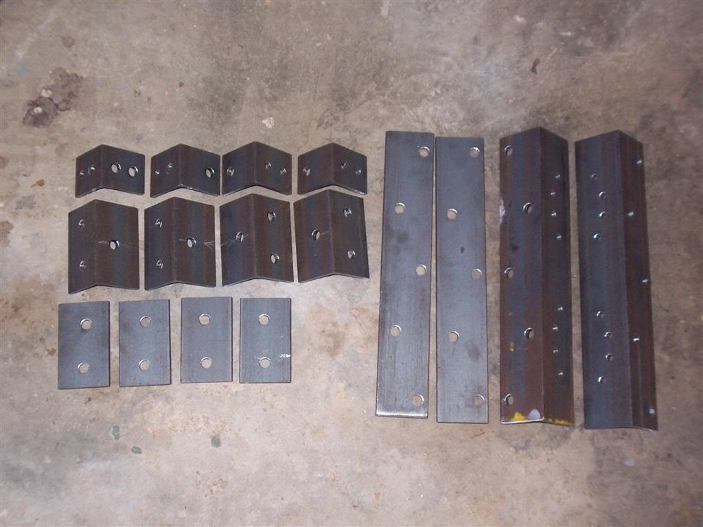

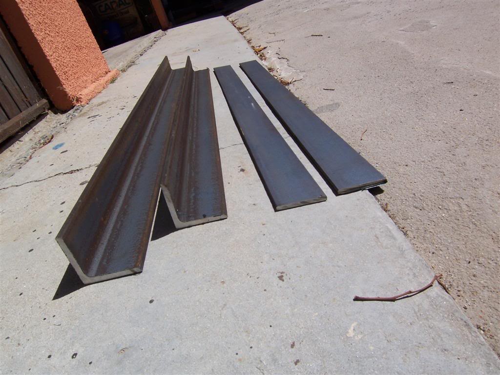

Over the last 10 days or so I have been making up the brackets to mount the seats to the beetle. Being that Recaro supplies a generic mounting system using 5mm steel and M8 bolts (which doesnt fit the beetle), I made mounts to bolt up to this system

@TonyZ
Did you retain the stock seatrails on the pan or were they removed and the new brackets bolted through the floor?
Posts: 14994
Been thanked: 487 times
I kept them.
These were bolted through the floor but I didn’t touch the stock rails.
