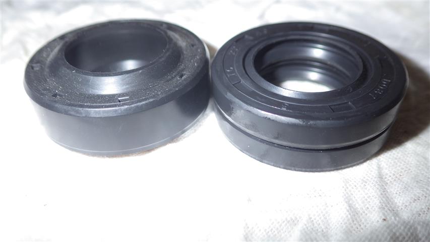

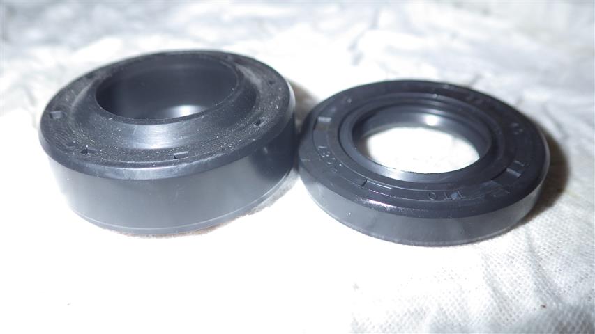

Then onto Angrrr. I had to pull the engine again for yet another gearbox shaft seal leak. The seal looked fine, but it was nicely leaking oil. This is now the 4th time I am replacing this seal. So... I decided to do things my way.
Step 1 - go buy a seal.
Step 2 - take it to a company who specializes in seals and ask them for something better.
result - smaller shaft seal with 2 sealing lips.
Then we thought, well, why not use two???
So now I have 2 seals in the place of 1... hopefully this is the end of my seal problems.
After putting everything back together, I took it for a drive. All is well but bizarrely the clutch now slips. Maybe from the seal leak, maybe it just needs adjustment.
Thankfully after adjusting the clutch, it no longer slips.
