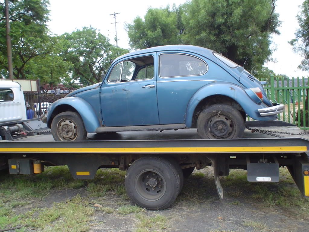

Acording to Eben's chassis number decoding, i've bought an October 67 Sunroof Beetle.
As can be seen from the photo, its been around the block a few times.

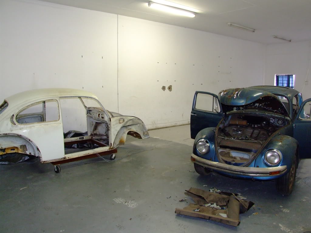

The main reason I bought the car is for the sunroof and heated rear window.
The plan is to transfer the sunroof to the white body in the photo and also to convert to Right Hand Drive
and repair the vrot pan with parts from a donor pan that i've got in order to retain the balljoint suspension and OEM 4 stud hubs.
Plans for the car calls for a Jaspis Blue (Mercedes colour) body with grey and charcoal interior. Some extrnal shiny bits will be used to highlight the body colour.

We have started stripping the car and found some horrors, but also some gems.
What a leaking sunroof will do when left for a few years
I knew it would be bad so was prepared for the floor, but not the rear shelf.
Check out the dual circuit master cylinder
The silver pipe in the foreground is the vent from the fuel tank to the filler - a bit different from the flexible pipe used on SA Beetles.
The front suspension is in decent condition and does not appear to be bent.
We definitely disturbed some creature's home - tough luck to the greenies
All the removable bits have been taken off and with some luck the body will come off tomorrow.
This mountain of work was done in one day by my colleague Andre - Kudos to him
