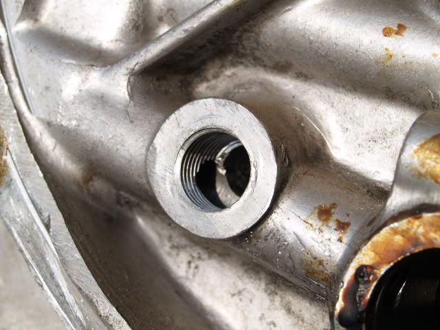

As promised, some more pictures,
In this one, you can see that once you remove the bronze fuel pump guide there is plenty of “meat” to tap into the oil gallery plug.

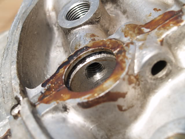

In this one you can see from the camshaft side where I have taped (M12) into the channel left after removing the bronze guide. I also taped in from the fuel pump side, thus blocking off both ends of the channel.

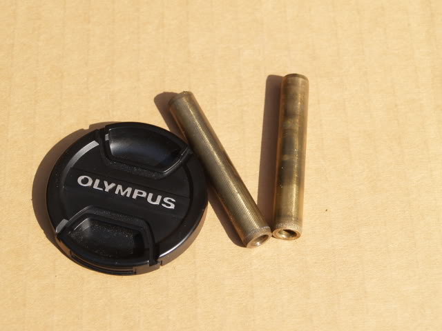

A couple of the offending bronze guides.

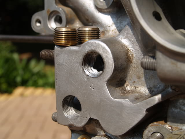

Close up of the front oil gallery plugs after they have been taped.

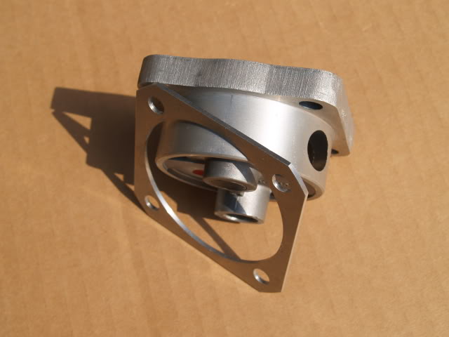

Oil pump with the 2mm spacer I mentioned in an early post.

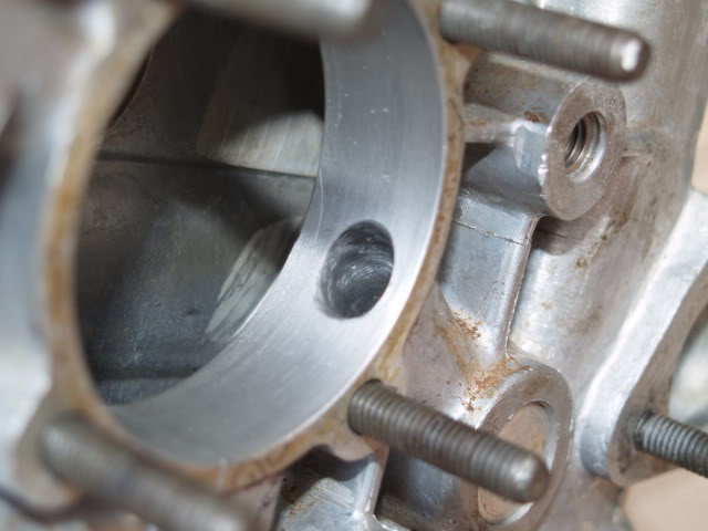

Oil pump port in the case after matching to the new oil pump. You can see if you matched the ports without the spacer the opened up port would be very close to the rear of the case. There is not a lot of “meat” to play around with in this area. (Of course, you don’t have to blue print the pump to the case, but every little improvement leads to a better engine)
