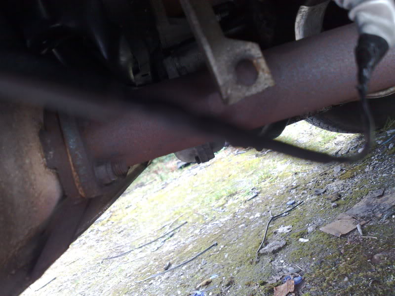

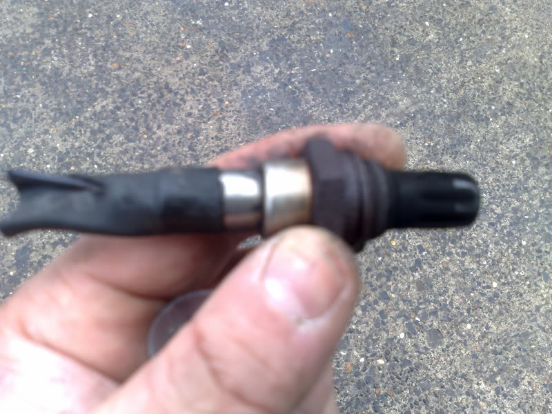

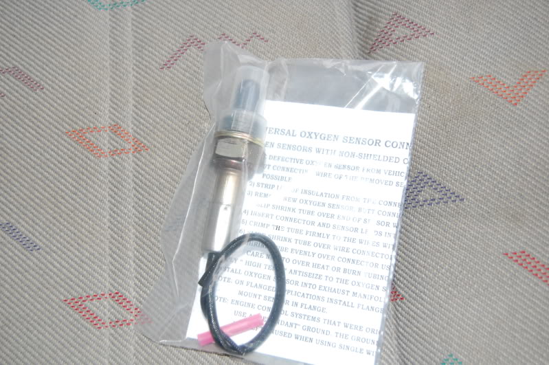

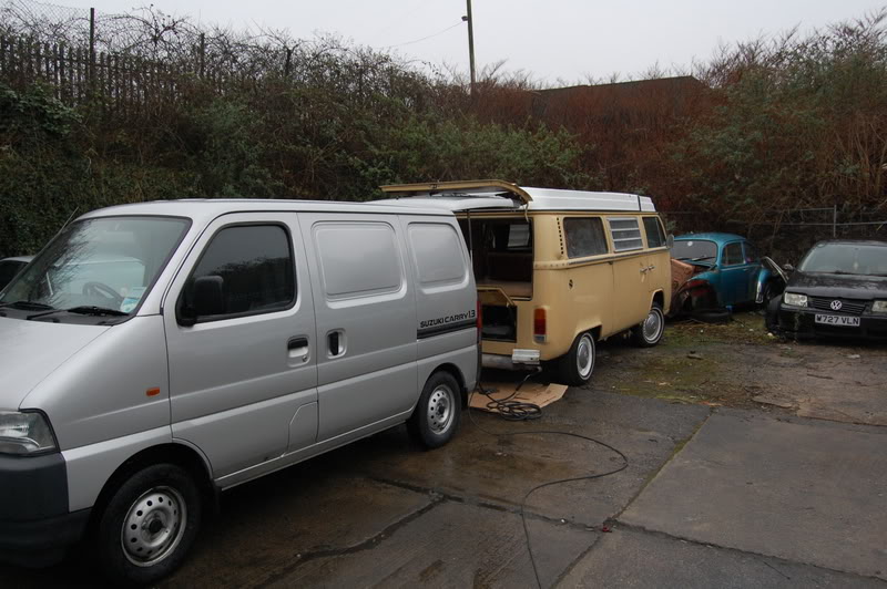

Right an update a guy called Nigel from Motolec came out today with his box of trickery, & done a diagnostic on the bus, he said the fuel system is fine so are the electrics but the injectors are pulsing to long & flooding the engine this he thinks is because of the Lambda sensor. Its the one wire type that earths out on the body of the sensor so I'll need to buy a new one, its fitted into the exhaust tail pipe. I'll ring him once I've fitted the lambda sensor & he can check it again.
This is Motolec down Deans yard, sorting out Milly:-

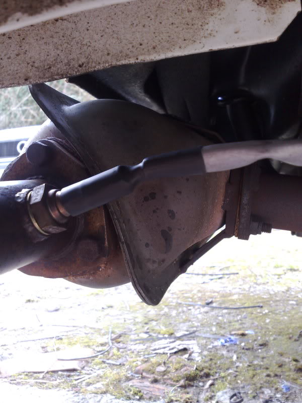

Fitted my new lambda sensor removed the old one, screwed in the new one, soldered the old wire to the new & heatshrunk it, I also heatshrunk over the sleave to keep any water out of the sensor body:-
Still not working so Motolec will need to pay a return visit.

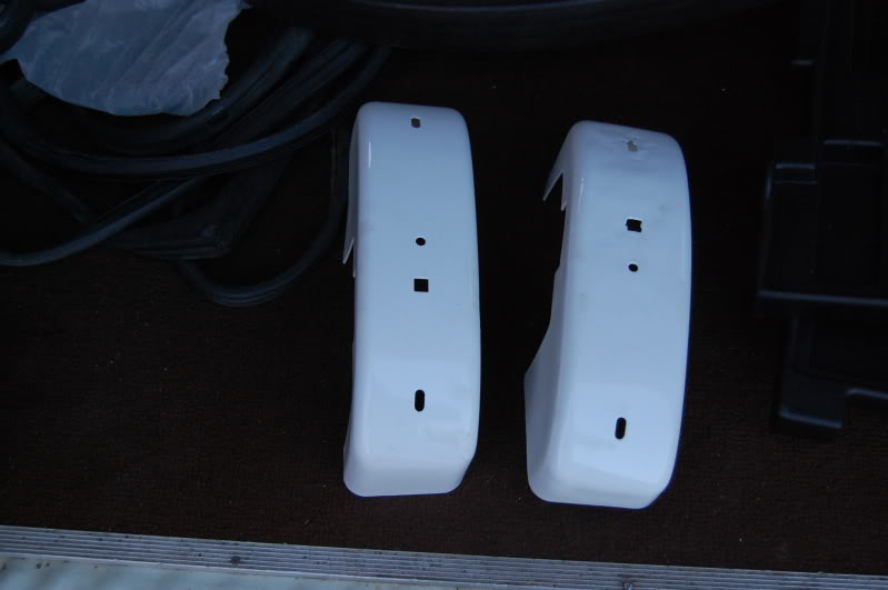

Got my bumpers & over riders back from being plastic coated. Cheers Dean! :vhp:
Got the front bumper on need my brother Richard to fabricate me some brackets then I can fit the deluxe trim & over riders.

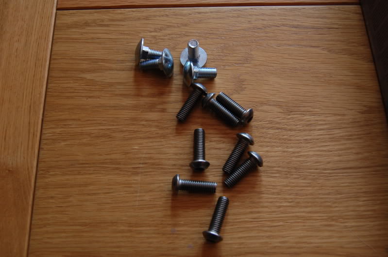

I need now to get some coach bolts so I can fit my rear bumper. I also need to purchase a Delux rear trim for it.

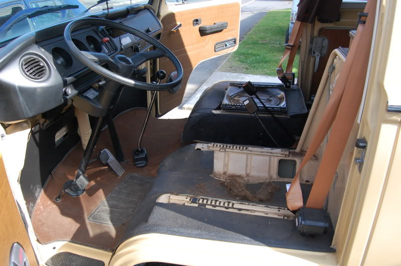

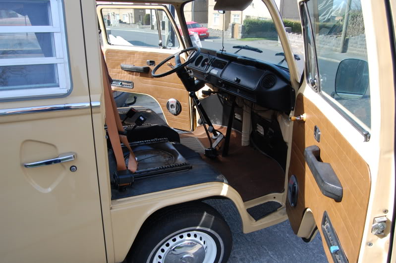

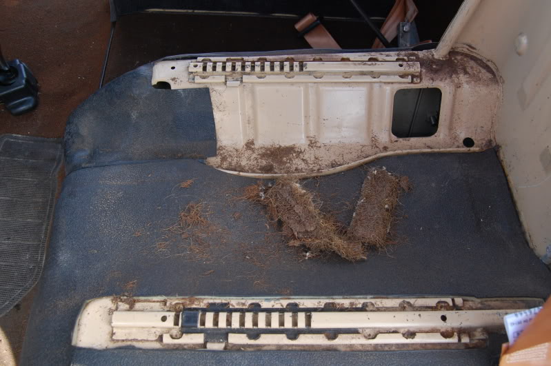

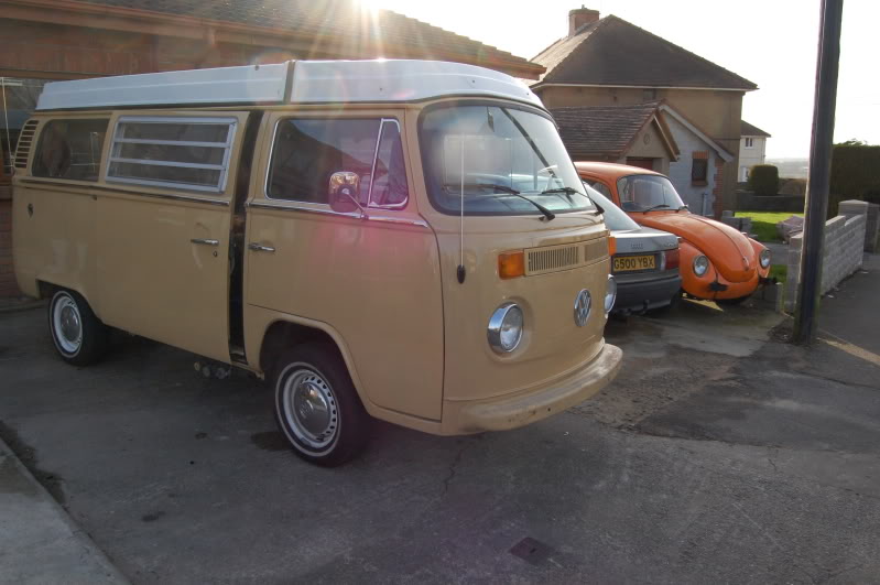

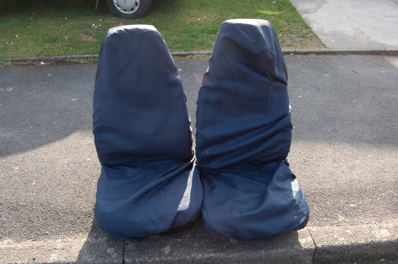

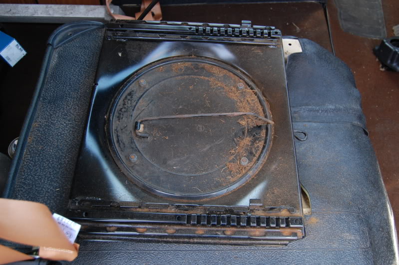

Removed the front seats today & took them to a bloke in Llandeilo called David Rall who I've been recomended.
Anyway here are a few pics of them & the van without them in the horse hair filling is going to be replaced because it is decaying & falling out:-

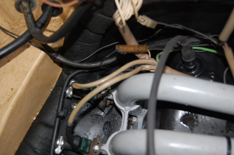

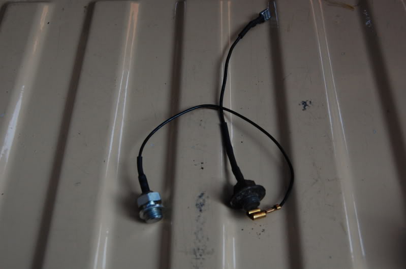

Fitted my temp sensor today & it works a treat now the old one was a bit manky which confirmed that its crap.
Old one in place
Old & new
New one in place

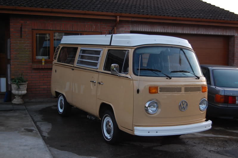

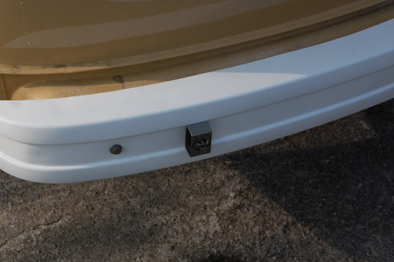

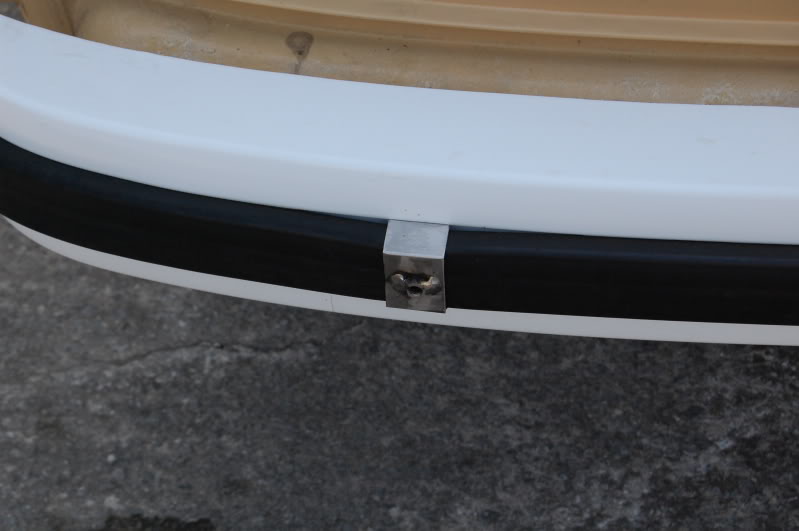

Got a master plan to fit my overiders, my brother is cutting out some 50mmX25mm box tube that just about fits over the rubber deluxe strip, this will be bolted to the bumper like so:-
Two holes will be drilled through the box one on each of the 2 long flats, then an 8mm stainless nut will be welded on the outside of the box section, the overider can then be bolted to the box section:-

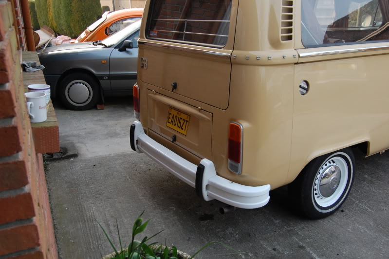

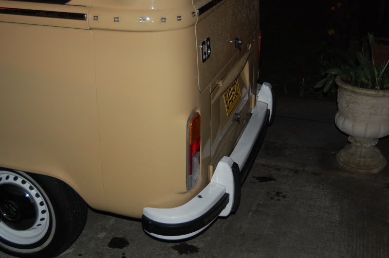

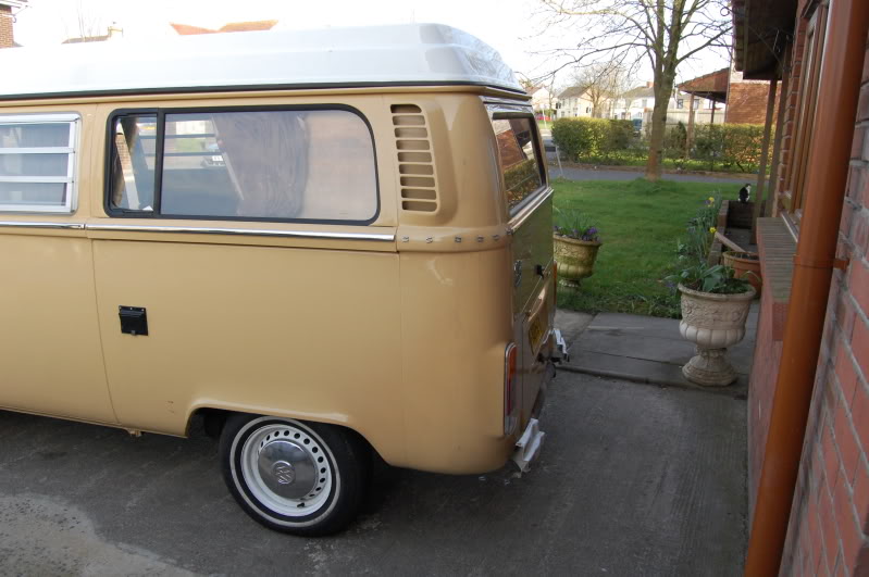

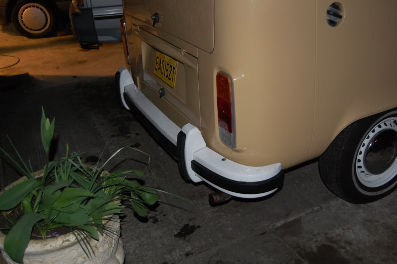

The back bumper is now fitted:-

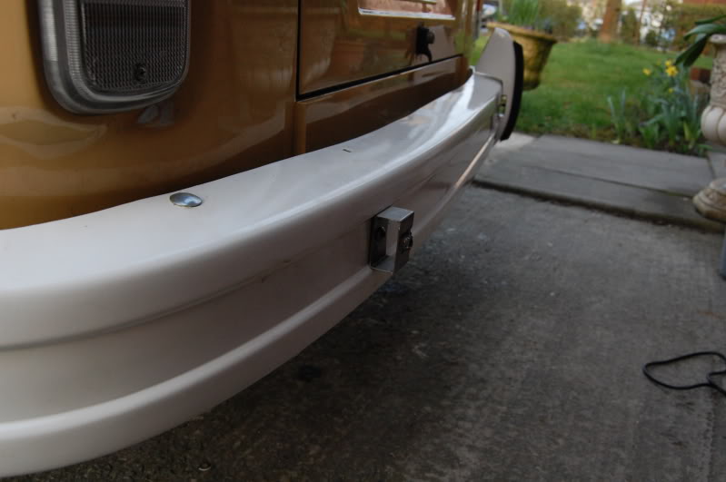

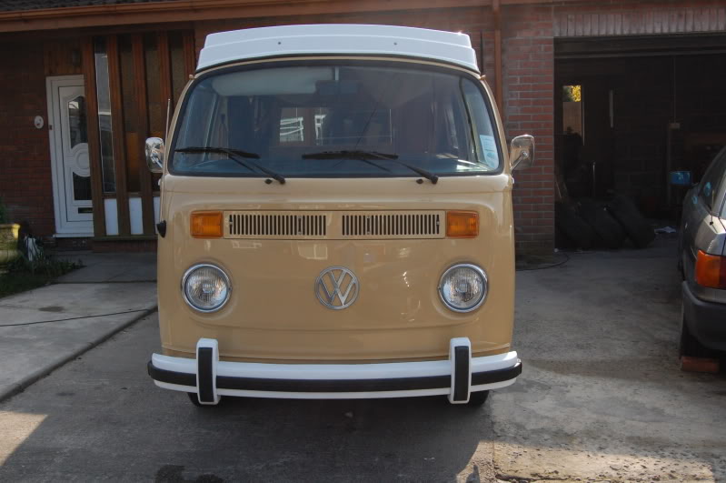

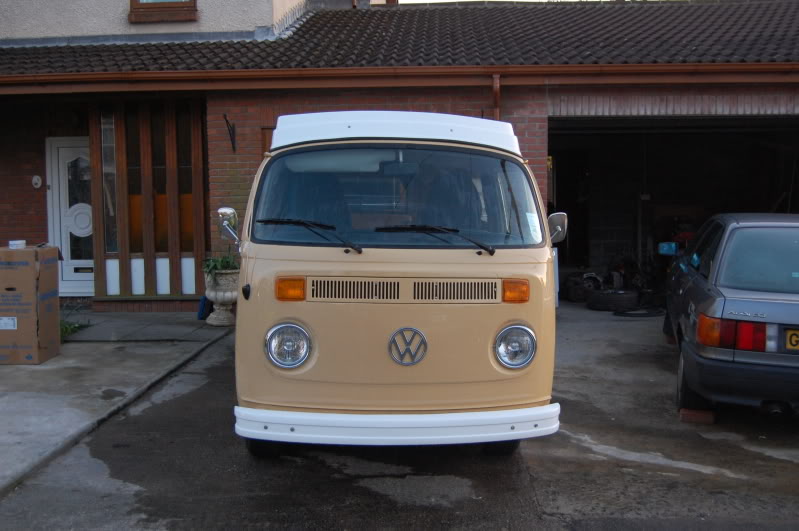

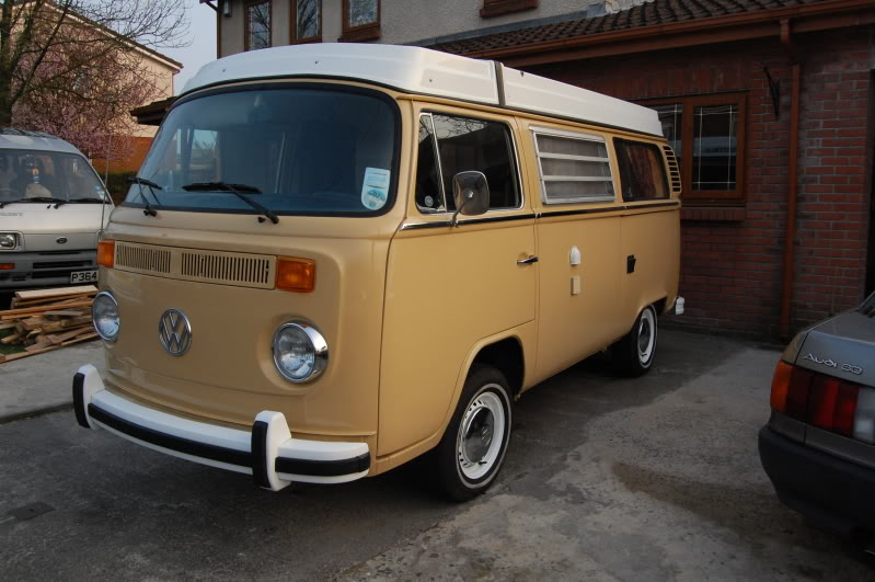

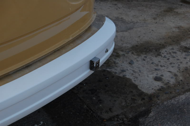

Thanks to my brother Richard I got my stainless steel brackets, & bolted the front 2 on. Its not that clear in the picture but there is a bolt welded to the outside of the bracket that will hold on the overider:-
Fitted my deluxe rubber trim on the front & my over riders, I think youll agree they look nice:-
Started then on the back, I had to remove the bumper again to fit the stainless brackets, I'll order the rear rubber trim on Monday the front one is off Chug Chug it survived the fire.:-
A couple more pics:-

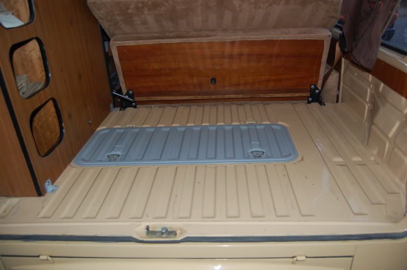

Refitted a part I left off a while back & forgot about & just had a general clean about.

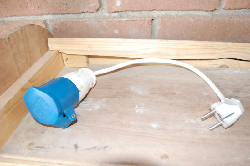

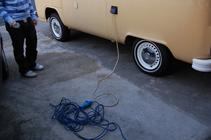

I started to fit the under dash tray (I'll finish it tomorrow) & I made up a mains hook up lead.
Bought a European adaptor & a UK 13A adaptor (got the UK one off Dean in Britania tow bars)
This is the part I forgot about its in the cupboard next to the fridge:-

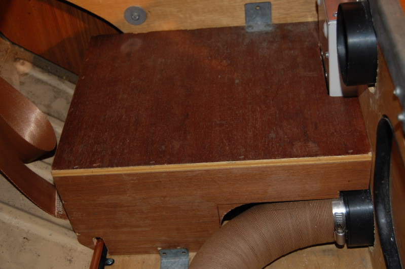

My M8 Kevin called around & cut the boxing in panel to fit snugly over everything (cheers Kev):-

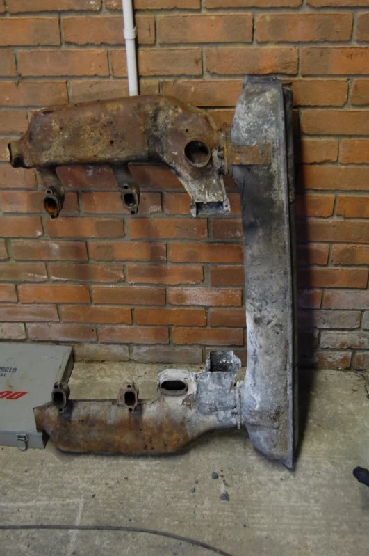

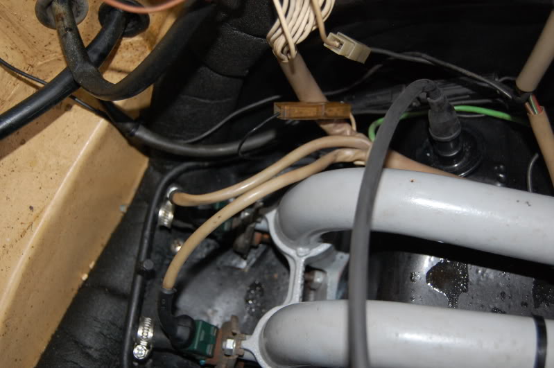

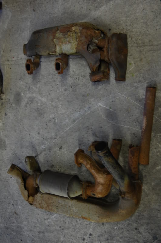

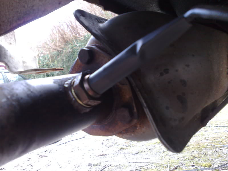

My M8 Simon called around today & we checked out the heat exchangers & exhaust system.
This is the old Chug Chug setup:-
This is the Milly set up:-
Simon's bus has the set up like Milly's one at the bottom on both sides, I think I need to do a bit of research to see which is the correct one.

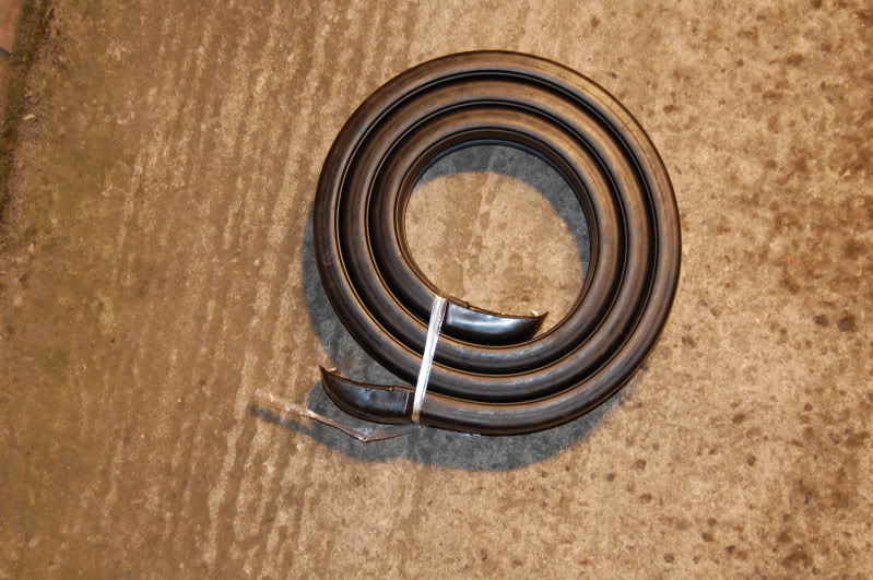

Rear Deluxe rubber trim turned up today, so I fitted it:-
So did the replacement deluxe trim but its just as shit as the last lot & I can't get it to fit:-
