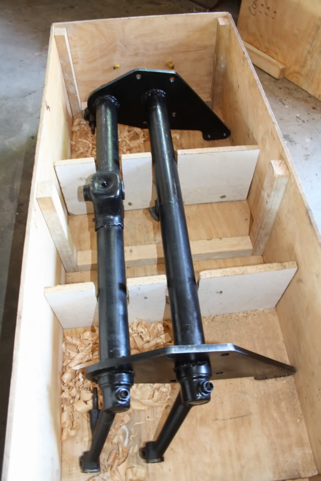

Looks like Christmas came early, I was away this week and when I got home today I had some unwrapping to do :hangloose: :hangloose:
My Beam !! Thanks Jacques, It fits like a glove :hangloose:

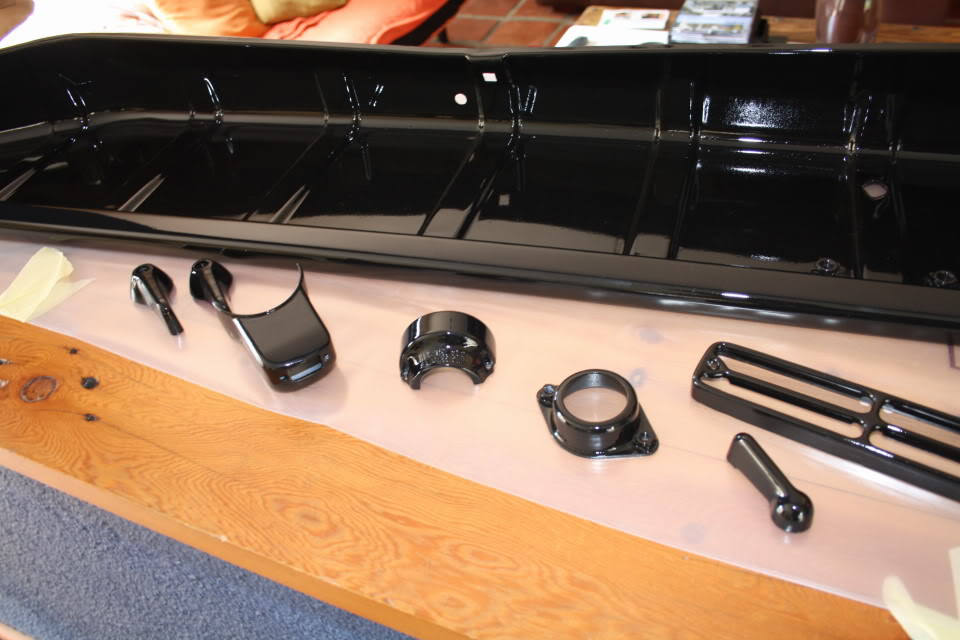

My newly painted bits

Has the beam got adjusters on ? looks like an adjuster on the one side - who what when How? :D

Looking good Donovan :wink: , Happy the beam fits let me know if you have any hassels !

Springer wrote:Has the beam got adjusters on ? looks like an adjuster on the one side - who what when How? :D
Yes the beam has two adjusters, top and bottom,, the who,what,when,how give Splitfan a call :D

Everything helps even cleaning/fixing the small bits, I sand down and filler up and paint everything I can, just to keep the project rolling
