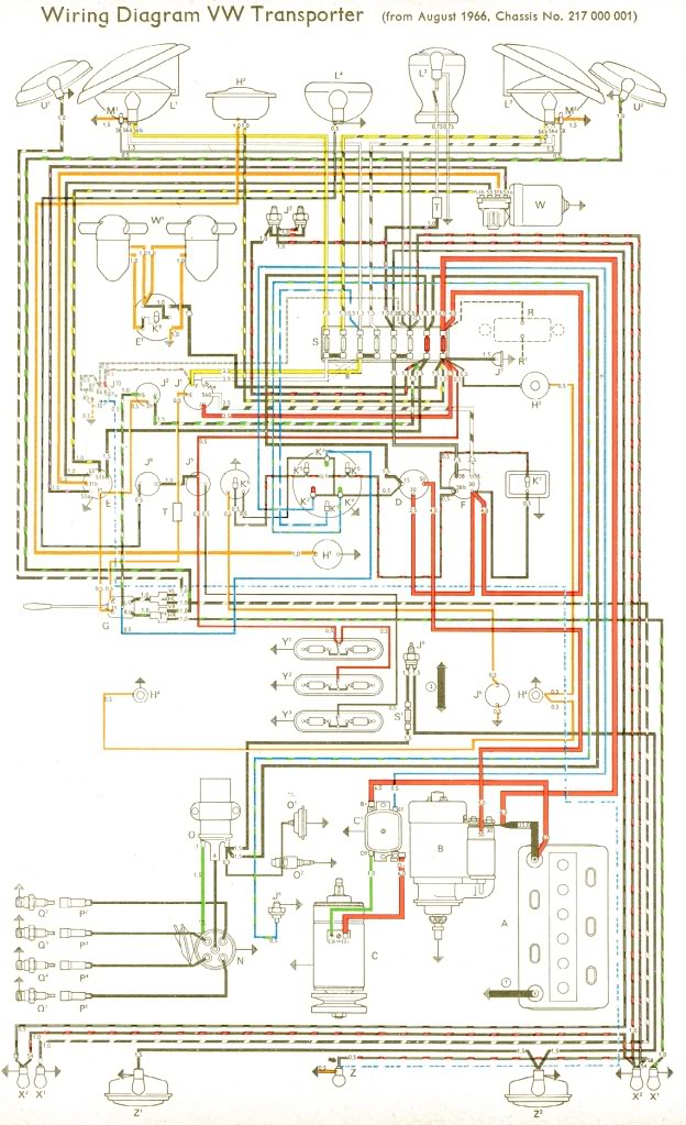

One fuse is missing from the unlabelled fuse box, and I have no hooter or interior lights ( I did check the hooter button and the wire is connected). Also checked the connectors on the hooter, and they were loose, but still no noise even after bending and refitting them. Same story with the interior lights, checked the globes and they are all fine, cleaned the contacts, checked the wires, but no luck, so my first guess is the missing fuse must be for these two, but the wire coming from that fuse is quite a thick guage?! Suppose I better check the book to see the fuse configuration right
If this is a aftermarket fuse box, what would be the easiest way (besides trial and error) to establish what fuse does what?

- Dutch_Diver
- Posts: 4028
Re: Fleetfooted - 75 Fleetline - We have ignition :-)
KK, maybe this will help......

Thanks Dutch
will give it a look see.

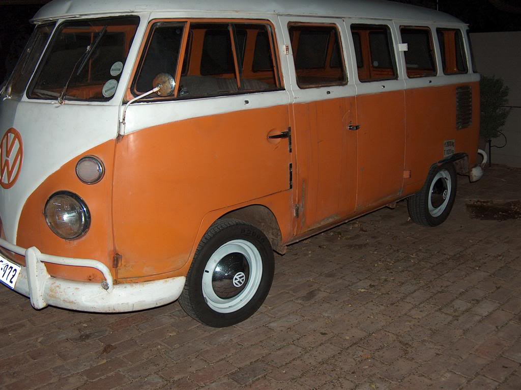

After getting back home from a succesful test drive, I had to take a pic!

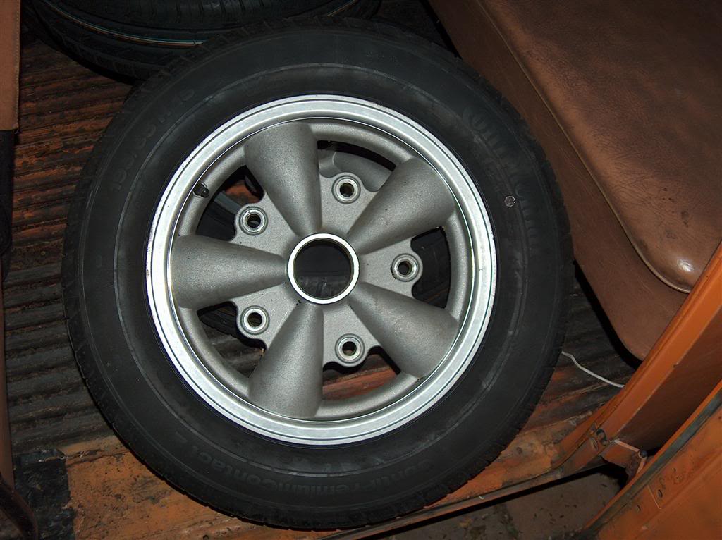

Got some new tyres for the bus. 195/65/15 Conti's on the Empi 5's. Should look great once I get the right wheel bolts and fit them
Bought some engine degreaser from builders, before I ruin the bus engine, any advise ???
While scratching around in the bus I found one bench seat floor mount
. So now I need only one more. Who has one lying around, will pay cash

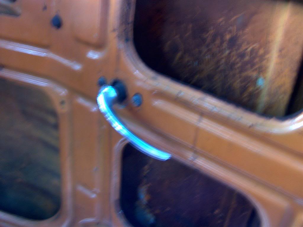

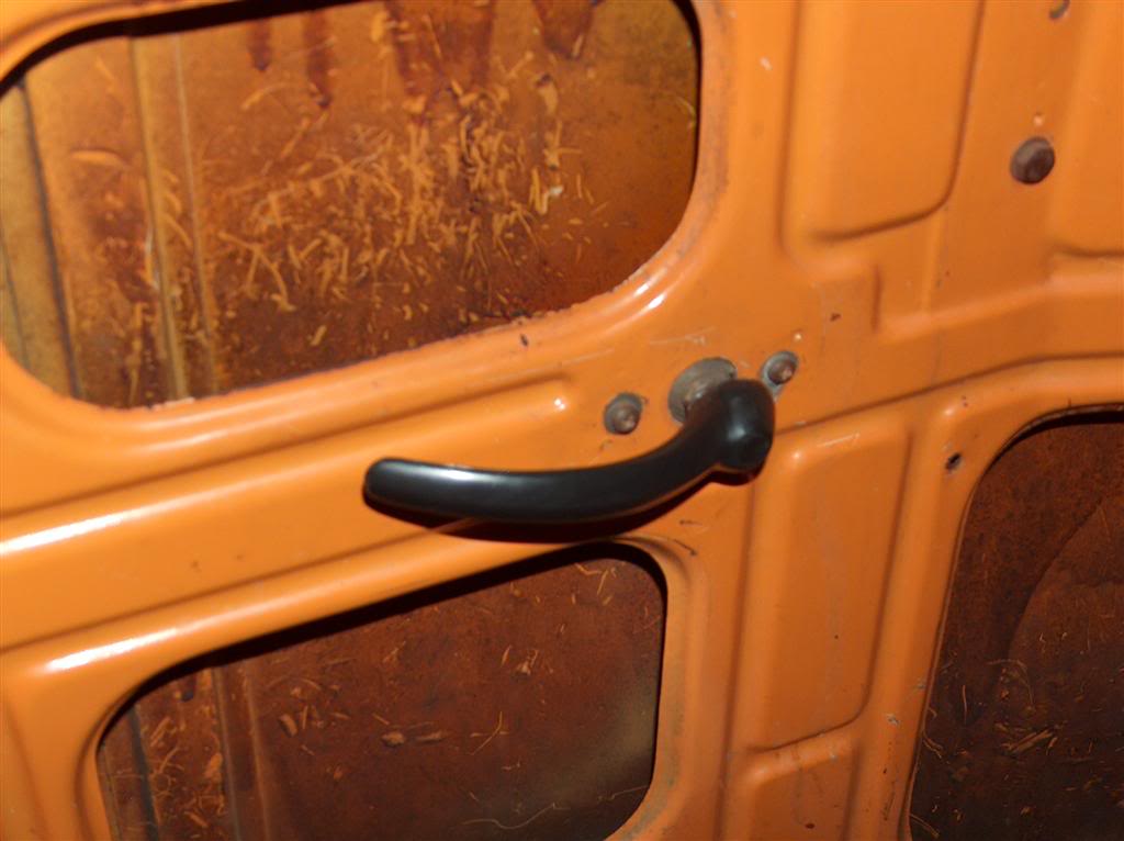

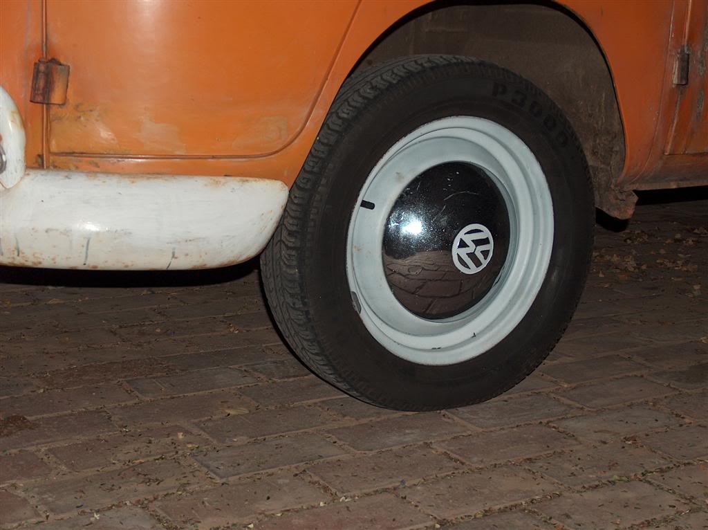

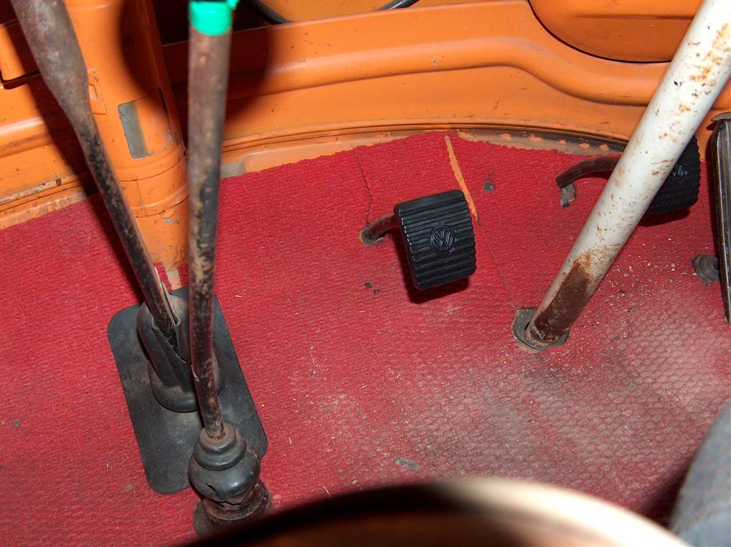

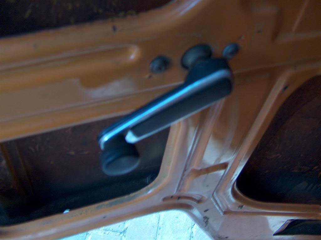

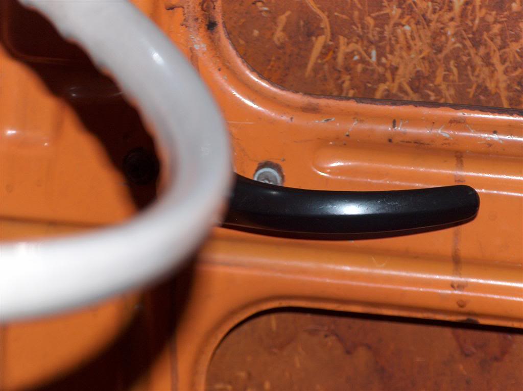

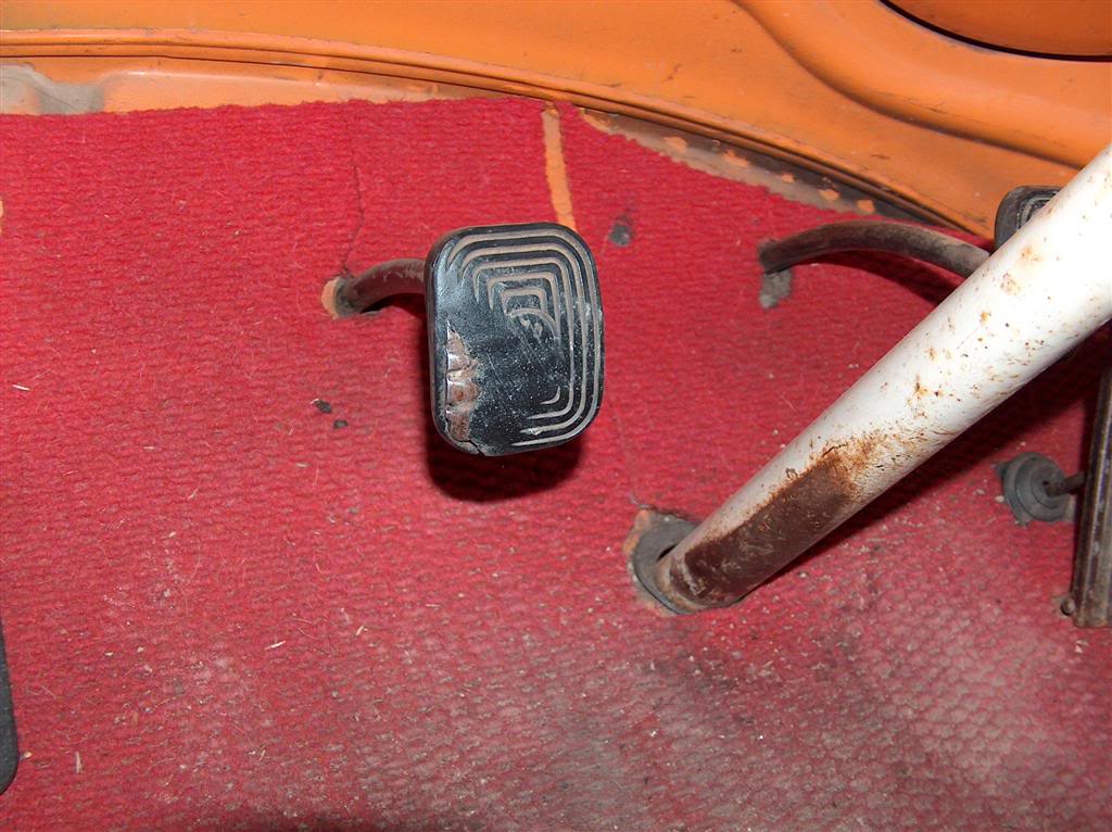

The other day I was working around the bus when I noticed that the white paint was coming off one of the hubcaps. So I got some metal polish, applied some elbow grease, and managed to get the paint off. Note of warning to anyone who wants to spray chrome, unless you prepare the surface very well, the paint WILL come off. Thank goodness the PPO or PO did not prepare the hubcaps for paint, so they look OK after the polish. Sure, there are some pits and scratches, but this is only a stop gap till I fit the empi's. Will perhaps use them on the notch until the rostyles are finished.
Two of the hubcaps where powdercoated white though, so no amount of polishing is getting that off. The bus thus has a shiny side and a white side. The logo was left white to stand out, and tell you what, if the Empi's did not have the tyres on already, and I had two spare chrome hubcaps, I might very well have retained the stock look.
Replaced those old pedal rubbers and fitted proper bus door handles, removing the old window winders doubling as door handles
Of course, I know you lot and pictures, so here you are.
Before and After pics below:
and last but not least, an Empi 5 ready to be fitted:
B.A.B., if you read this and can help, I am now just about ready for some centre caps
. Any other ideas anyone?
