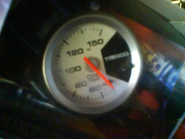

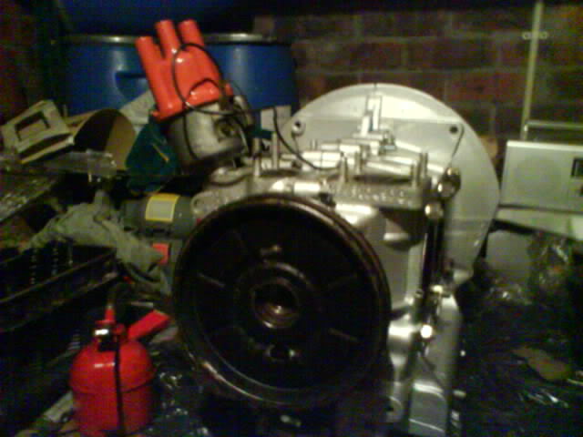

Some good progress was made today the casing is assembled still have to fit the conrods on the crank, I like fitting them afterwards.
Heres a pic of the casing
and the oil temp gauge
