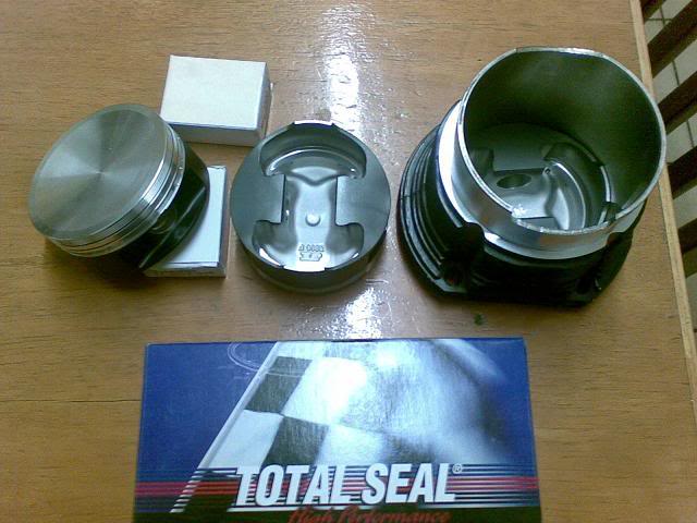

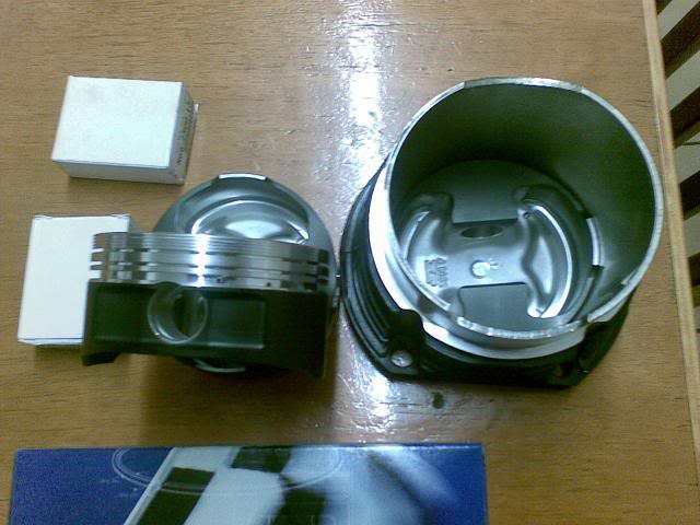

Got the pistons today!!
Measured the cylinder/piston clearance - 0.08mm. All looks good. (JE recommends 0.07mm as min)
Moly coated and compression height of 29.5mm (1.16 inch) Total seal top ring, limited interference top land, double oilers as well if I remember correctly.
Now I can go and sleep - been awake now for 30 hours.
