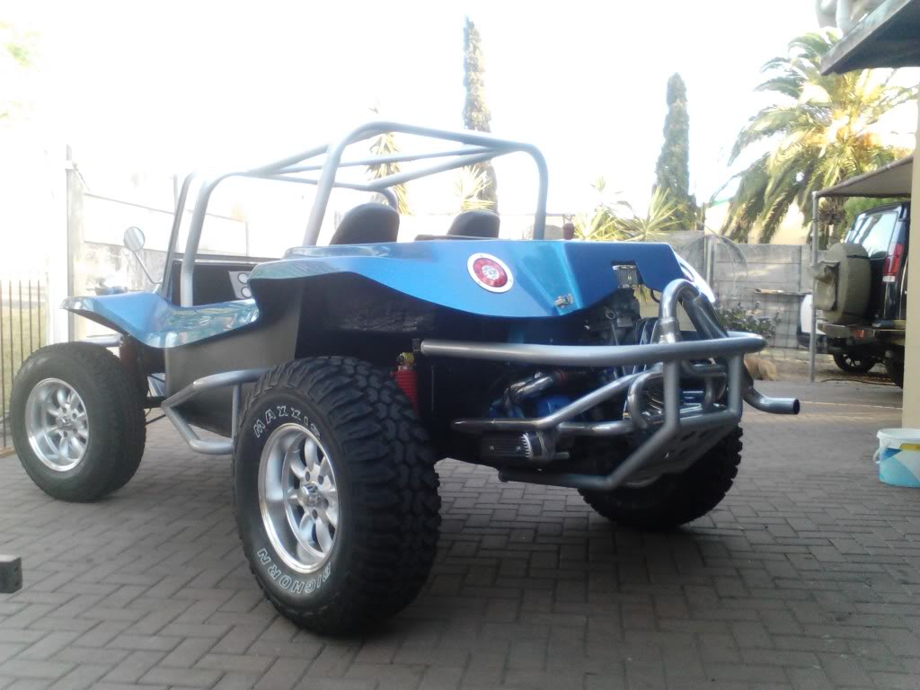

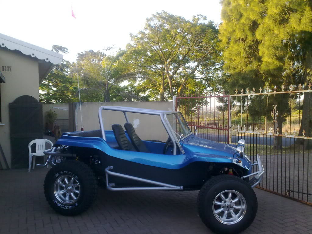

My beamish buggy rebuild & mod's
Re: My beamish buggy rebuild & mod's
thats looking good.
When can I send my buggy body to be sprayed?? :twisted:
Now that there be a owsum colour BLUE
Just love it, well done, that will look good with both white or black add-on's
Post by arnocill »
hitlers revenge wrote:thats looking good.
If you strip the body then we can talk, but obviously only in the new year
Post by arnocill »
retrovan wrote:Now that there be a owsum colour BLUE
I'm still working on the ad on's, originally i thought of making it silver but now i think it might be to much bling.
Now i'm thinking more towards a gun metal or dark silver, whatever you want to call it? Opinions welcome.
This is only my opinion........ :roll:
But if you look at my Fastback thread, you will see I have the simile finish on my RED paint, which too is a bright shade, and I had to "Kill the chrome" to stop it looking like a Christmas tree. more black, more white less chrome, even blacked out the chrome around the wind-up windows on the doors.
But hey! that just me...... :shock:

I have checked out you're fastback thread Herman and i think i'll go with the gunmetal colour and see how it look once it's done.
The side panels on the buggy will be black and not colour coded like ost buggies.

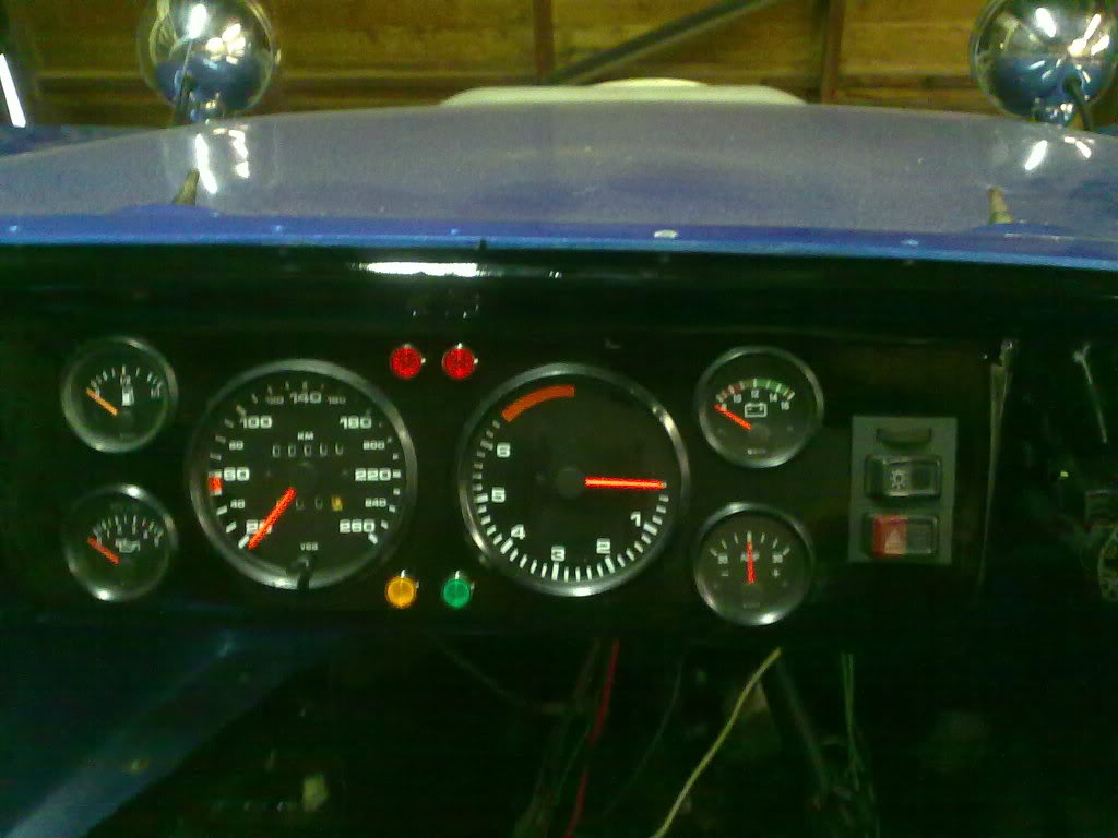

The dashboard with porsche 924 speedo and rev counter
Looks good sir, you have put a lot of work into the buggy, and it shows.
Well done
