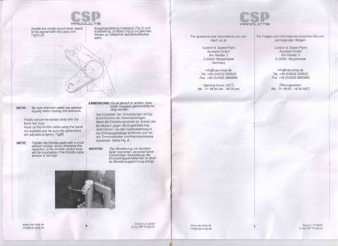

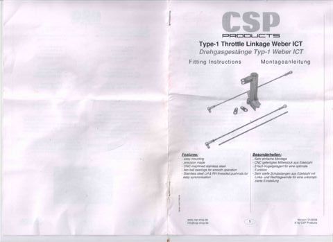

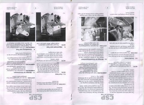

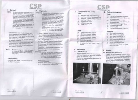

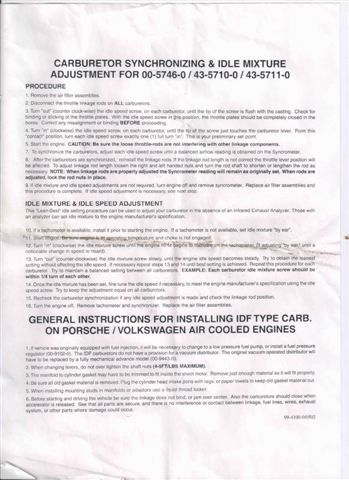

Do you have the setting sheet for these carb's....???VW0007 wrote:...... doing these dual 34 ict's webers .. is over my patience level... idling settings etc..........
If not, I can post one for you, its very easy to set these carb's, have them on all my Aircooled 's
They must be set in a set order, or you will be setting for weeks on end.
If you set all the links, and use a hosepipe, the jobs done.
- VW0007
- Oil Pump
- Posts: 218
- Joined: Sun Oct 14, 2012 10:30 pm
- What model do you have?: 74 1600
- Location: Kempton Park
Re: 1974 1600 twin port .. project
Hi
Could you send me the sheet, please --
I will try using the sheet... settings
Cheers
Please send it to
Cheers
Please send it to
Keep it real, keep it aircooled....
- Posts: 8710
- Been thanked: 541 times
Here you go....
Have also placed it under "Advice" for others to find, maybe the green mods can make it a sticky.
http://www.aircooledvwsa.co.za/viewtopi ... =4&t=32346
