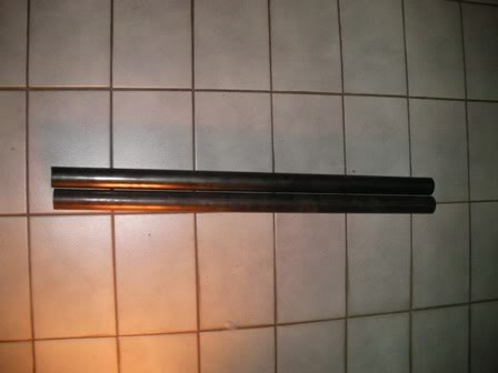

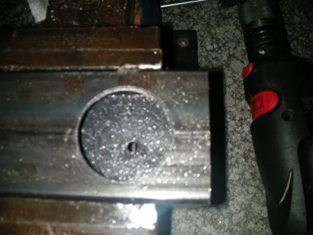

So the beam tubes are sitting at 1m lenghts at the moment, untill I have made sure what the lenght of a standard beam is and then they will be cut to lenght once that is done the "weld on" adjusters can then be placed and welded.The beam which is sitting @ 6" narrowed will at a later stage be built up but for now this beam im building will be used.The uprights are a piece of rectangular tubing that gets 4 holes drilled which will look almost identical to any upright found on a vw beetle beam,once the holes are cut using a hole saw the rectangular tubing will be cut straight down the center creating two identical uprights, once this is done the two mounting holes that sit on each upright will be drilled.Once the uprights are done they will be put into a jig where they will sit at the correct distances between the 4 holes (that hold the beam to the pan) with the pipe lying above it where with alot of carefull measuring will be tacked together. (wow if only it was as easy as this

So have some info and a few pics of what has been happening on the beam....
