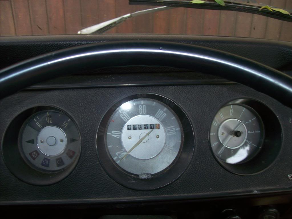

Hey! Dave that's one smart dash..
Did it come with the van, or have you also "accumulated" it from other parts.
That clock looks like the real Bay clock, and worth more then the whole bus on e-bay...
My speedo is of the old type, with the mileage counter in the bottom half. the date on the inside is 1976, same as the bus.
Very good form there old chap, well played....

the dash came just like that with the van, when I got it.

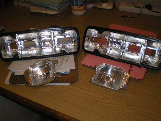

So been doing some work again on the "Fugly"
Found that the lights would work very intermittently, due to dirt, bad contacts, rust and broken plastic.
Went looking for fittings locally, but just got smiles and "you must be joking"
So now I am in restore mode.
Have got tail cluster lenses, and have repaired the base fitting, have also , as always, "foiled" the inside of the lamp holders, to ensure good lights,and to make sure no body rides into the back of me, because they did not see the lights.

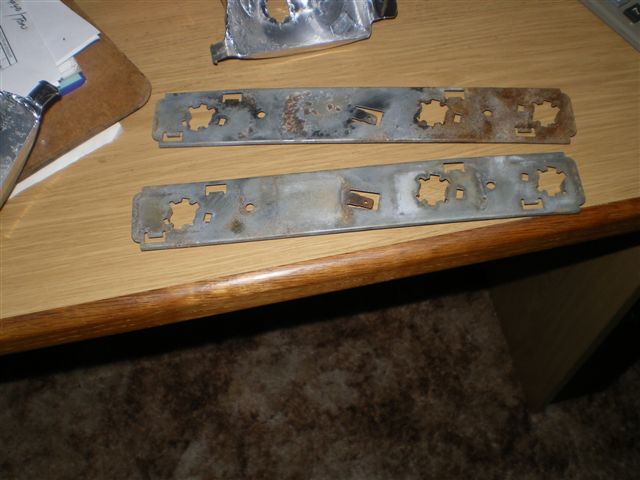

The lamp holder steel plate will have to be re-plated to ensure good contact, so here is the "before" ...

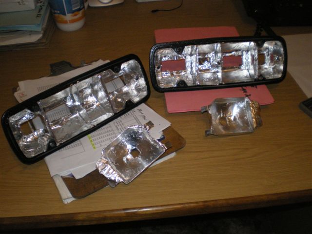

so here are the reworked bases for my tail lights.
As can be seen, I also did the front indicator bases, BUT still need lenses for these as the old ones are real BAD.

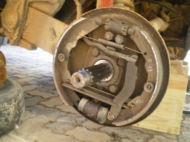

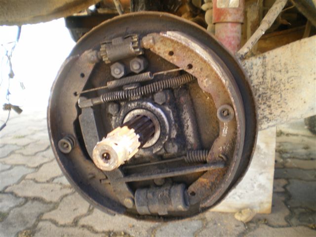

Also started stripping the rear end, got the drums off, and started cleaning up the reduction boxes for seal replacements.
Will be doing the drums and brake shoes this week, and getting all the seals.
So far all the bearings are fine, and as they are original FAG German bearings, I will leave them in.
Here are the "Before" photos of the back drums...

how do u make sure the foil stays put in the lights? is it ordinary kitchen foil?

No, sorry, should have explained how I cheated,MarshallGTi wrote:how do u make sure the foil stays put in the lights? is it ordinary kitchen foil?
This will keep it stuck for ever, and makes the old car lights as bright as modern cars. The 59 Beetle snow Flake lights are as bright as any Merc tail light.

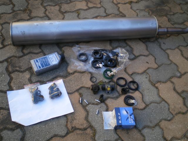

Got some more toys today,
All the rubbers seals for the slave cylinders, for all the wheels. With a spare set for the box.
New bleed valves
One new slave for the back wheel where the Bleed valve broke off. Now I know you going to say, "why not fix the old slave" well I will, but just to make sure that good old Murphy does not stick his head out and I trash the slave, then sit without one, I would rather have one spare.
All the seals for the Reduction boxes. With a spare set for the box.
All the seals for the drums to axles. With a spare set for the box.
As well as an Stainless Steel type 4 exhaust so now we need the engine......
So now we have the job card sorted for this weekend.
