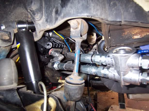

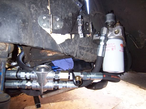

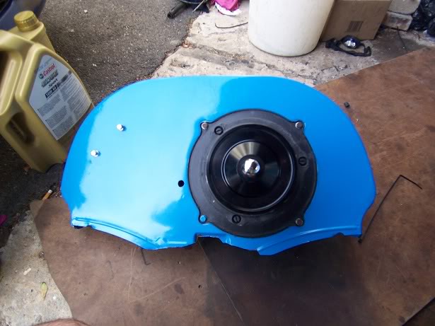

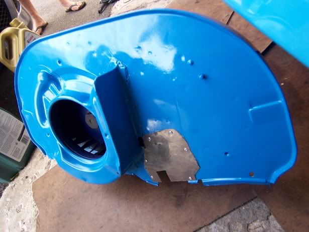

After having done plenty of thought about the stock oil cooler and its method of operation, I decided to remove it from the system altogether. A oil cooler bypass is now installed and the cooling tin has been modified - and some bling added to it. The oil now passes through a thermostat and a thermo-switch so it is fed to the cooler when needed and the fan is only used when needed.
The thermostat fits onto the exit from the oil filter, diverting the hot oil through the cooler and then to the engine or when the oil is cold, sending it from the filter straight back to the engine. My oil temp now sits about 20degC cooler than with the stock oil cooler - and I still feel this is due to the design of the stock system, not its capabilities.

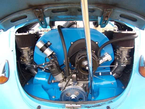

The fan housing which is now looking pretty damn good even if I have to say so myself
The engine bay has been cleaned up a little.

Where did you buy the oil cooler setup? I seriously need to put an external cooler on the bay. These AC cars were definately not designed for our heat and traffic. I just want to buy something decent. I don't have a lot of faith in the quality of the Empi stuff. The oil cooler looks OK, but the oil temp switch looks like real crap. I can just see it packing up when you don't need it.

Yes, my "windows" are to get to the carbs and the plugs.
The cooler I sourced a few years back but never installed it until now. The thermostat is a CB item and the thermoswitch is the crappy EMPI unit.

Hi Z , now that i saw your placement of the oil filter and cooler i have a better idea of where to hide everything , although i still have to hide a turbo as well. :mrgreen: . My oil cooler is bigger as well. Might have to do a little body modification as well.

I looks real good! Nothing better than seeing the results of your hard work! I had a thought the other day, but forgot to post it here. But now that the thread is up top again..... I thought that the chicken wire looked crappy, however I understand why you have it there. So I thought if you paint it black from a BBQ rattle can, at least it wont look that obvious and it will actually look good. If you dont give a rat's about looks UNDER the car, it can stay silver :D

I know what you are talking about... problem is access - I should have painted it before I put it in. I even have some of that paint but didnt even think of using it at the time.
Getting the cooler out now just to paint the mesh is a massive job. Its also something you dont see unless you really look for it. Remember, those pics are taken with the wheel off and the car jacked up.

Yup, just the point I was making about "if you are not bothered about the look under the car" (iow: hidden) :lol: If the install was anything like when I installed the cooler on my Fastback, then you have my sympathy! There is nothing that sucks as much, as trying to install something in a tight spot where you NEED to get the drill in, but there just aint f'n space(the drill doesnt FIT) and you cant get in with any kind of hand tool to ''drill'' either, because there aint no space for leverage :evil: I was swearing like a sailor, and I had a dealine to have it done for Spa!!! I worked until about 2am that morning and f'n bleeding knuckles all over!!!!
So yes, now that it is in, leave it alone!!!!!!! :lol:
