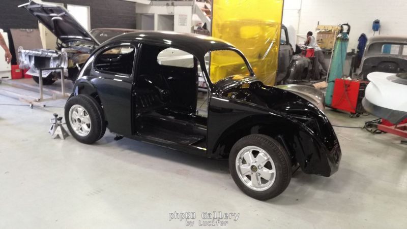

The old girl is finally home. Now my work starts and the first hurdle has almost let me to leave the beetle at the painters.
Got the gearbox and front beam in on Friday to get it rolling and ready to roll out onto the trailer on Saturday.
The rear tires are right up against the springplate and unable to move. Went down to the local automotive store to get some spacers and they dont clear the centre of the drum.
Im guessing I just need some spacers, or would the long axle tubes be a better bet ?
So in order to get it rolling I had to put the front wheels on the back and vice versa
Fronts are 165 and rear 195.
Safely in the garage
The color on it is straight from the gun, once Ive assembled it and done all my work it needs to go back for a 3000grit sand and polish and a fixer upper of all the scratches thats yet to come.

Makes me jealous
Did you had it sprayed with clear cote and what brand of paint was used?
What front brake disc conversion did you install? Are you keeping it drums in the rear?

I was told it is sprayed with base and clear.Riaan.N wrote: Mon Dec 10, 2018 1:19 pm Makes me jealous
The front discs are from Dave at FFR, he made them up for me to accommodate the 130pcd of the wheels.
I am keeping drums at the rear.
Anybody know the size/width of the rear drum for an oval ? I had a look at the rear wheels again and cant figure it out.
Currently it has the 165 tyres on the rear and it just misses the spring plate. The 195's wont move when I get them on.
Is running a spacer my only solution ?
Also looking for the spring plate rubbers as the empi ones are too big and does not fit.
The rear drum as not been tightened yet.
...give or take without tightening
