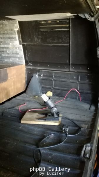

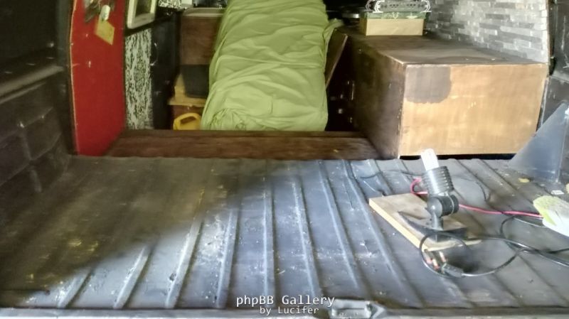

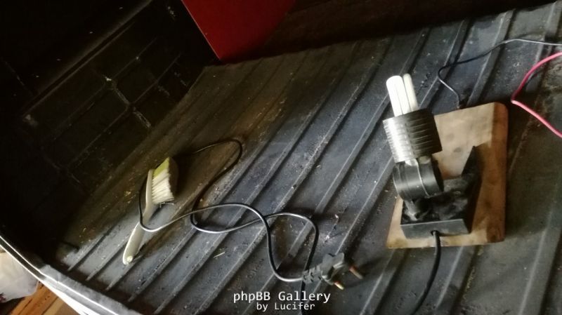

Removed the rear cupboards to get to the sagging area above the engine bay.
Its not that clear from the pics but its sagged quite a bit and almost sits on top of the fan housing in the engine bay.
I also want to see if I can fix the hatch hinge and rust.
