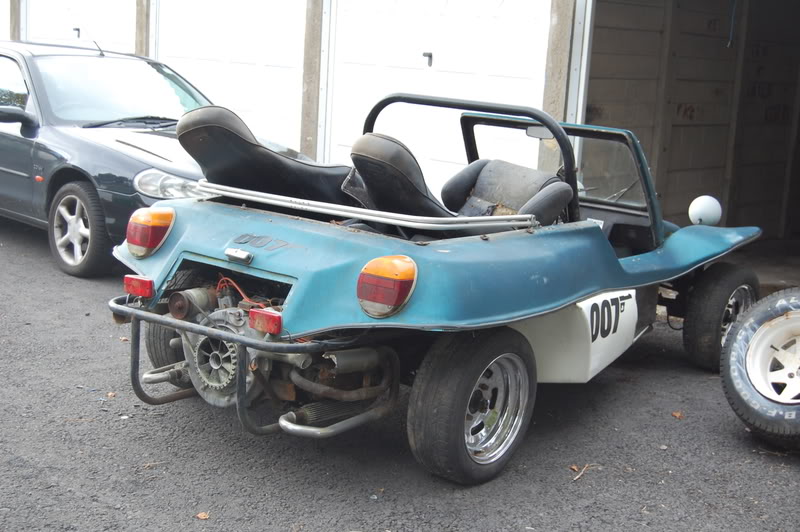

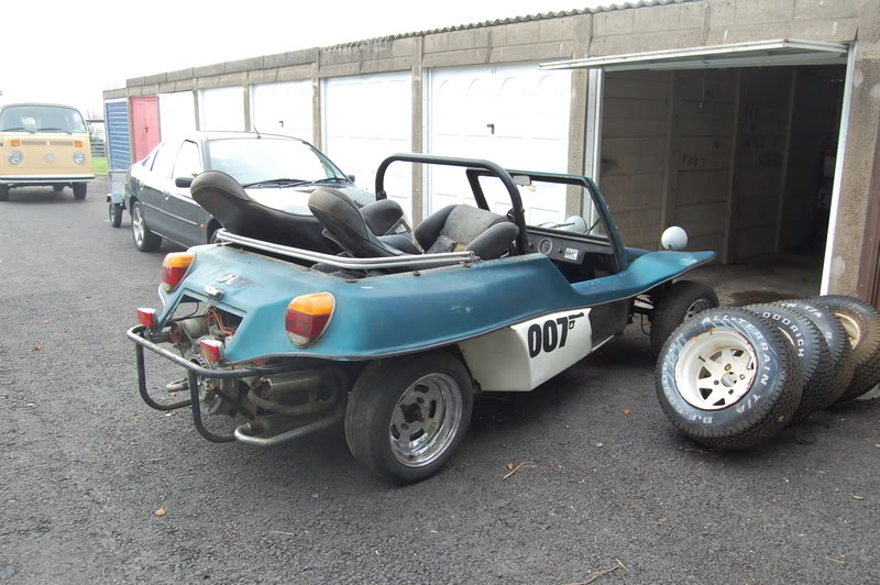

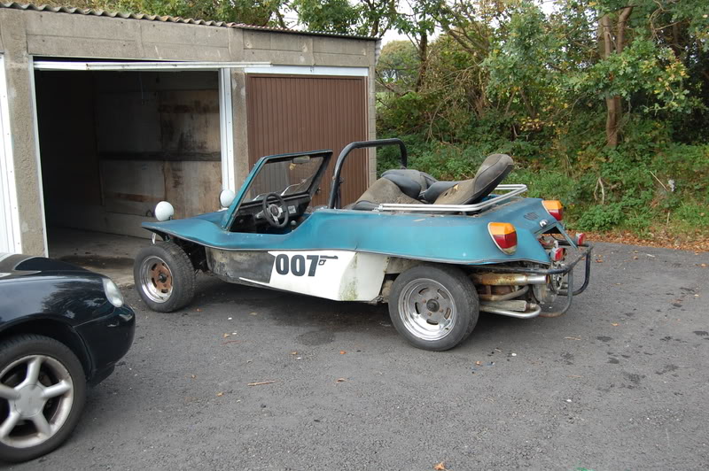

A nice chap called Suart called in to see me for a chat & I ended up going down his lock up to see his Beach Buggy, it was actually in a James Bond film in 1985 & the good news is that he plans on restoreing it to how it was then.

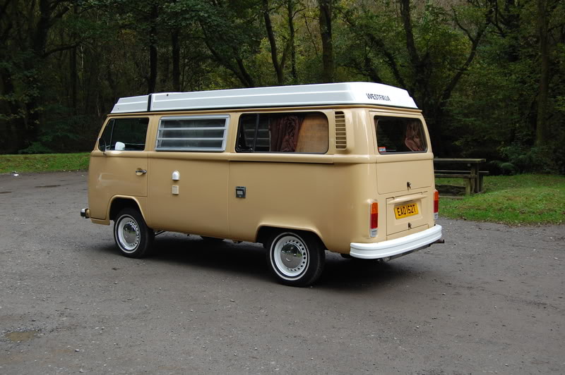

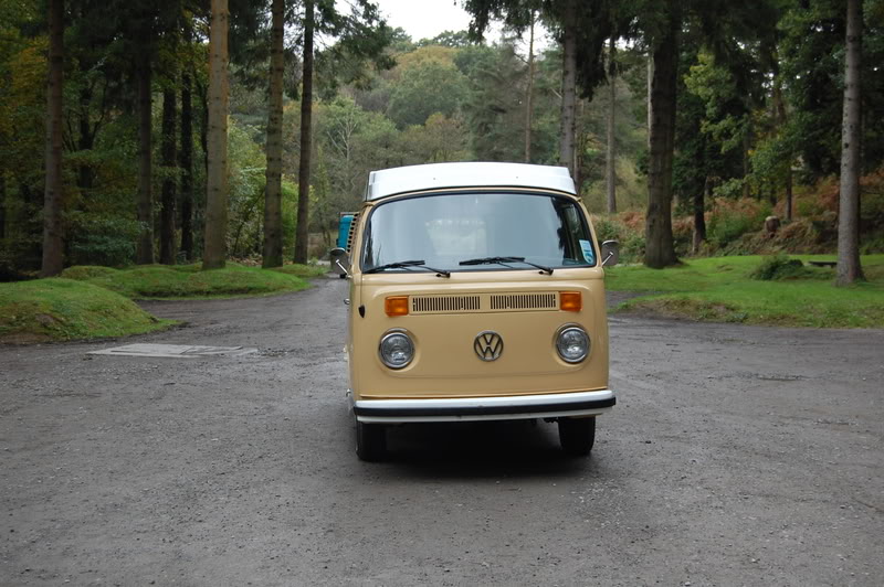

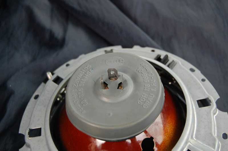

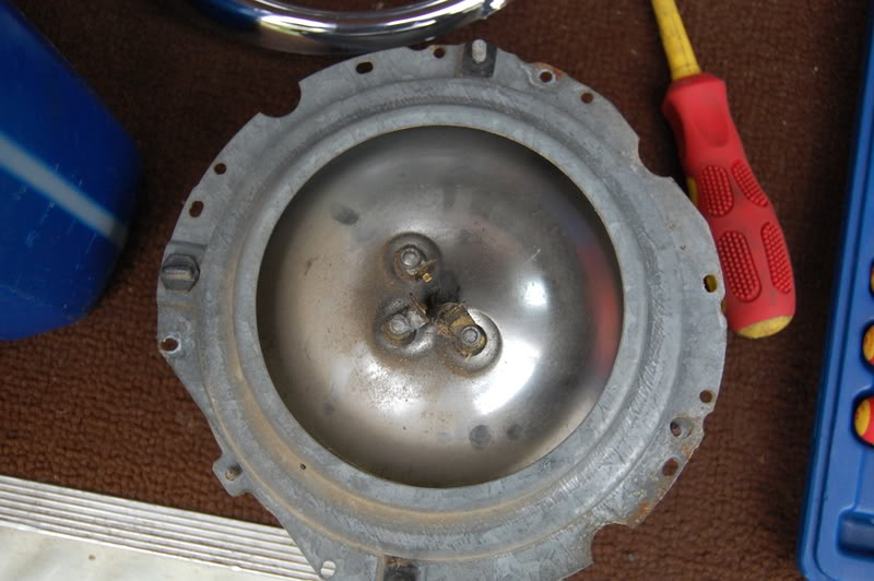

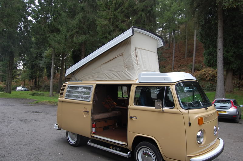

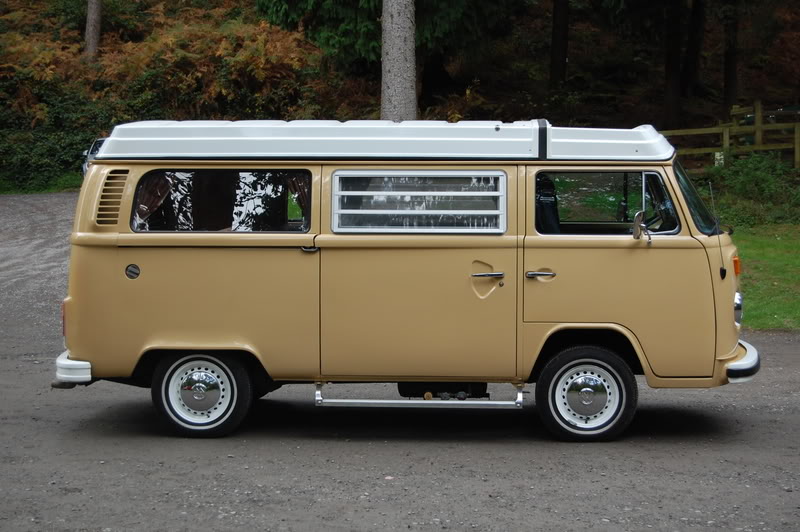

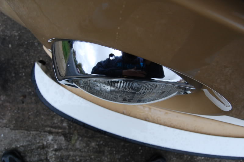

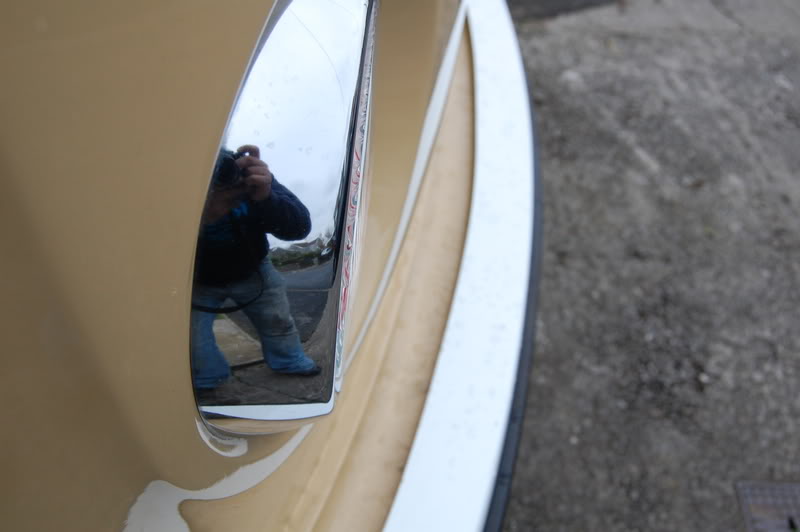

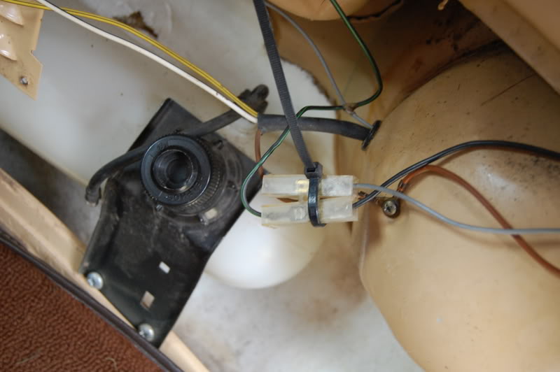

Spent yesterday afternoon playing with my lights, I removed the USA spec General Electric sealed beam units & disconected the grey wire from the front indicators (this is the side light feed) pushed this wire into the headlight bowl through the standard grommet kept the original spade so I didn't have to modify the wiring. I wouldn't recomend breaking any cables that are outside the vehicle so I ran a new earth cable put a ring on one end & secured it to the headlight bowl on the inside ot the bus to the location already used. pushed the cable through the grommet & fitted a size 2 red spade, used a brown wire to be consistant with the VW colours. Notice the UK spec indicator it has a twin fillament lamp & a small sidelight lamp so three separate light sources as opposed to the UK's one.
Fitted a pair of H4 lamps to the new Hella units I picked up & the side light bulb holders I salvaged from Chug Chug.
Connected them all up & now they are UK road legal. You'll notice that the UK Hella units glass is flat where as the USA versions are curved.

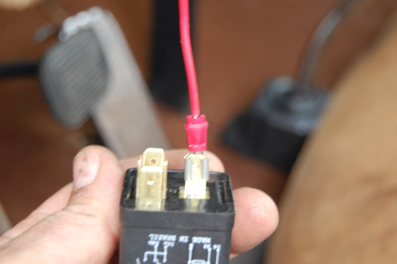

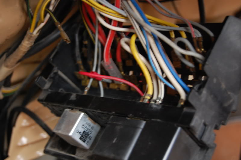

Decided to sort out the Flashers while I was playing the USA lights only flash when the lights are on where as the UK ones flash with them on or off. I removed the standard relay which as it happened was a 5 pin anyway fitted a size 3 red spade & red wire to the terminal 30 opened up the terminall location on the fuse box & refitted my new 5 pin relay. I connected this to a permanant live so now I can flash the headlights with the lights & ignition off (they just stay on untill you let go of the stalk) they also flash on & latch when the lights are on (drop off when you flash again). I may alter this so it only works with the ignition on I haven't decided.

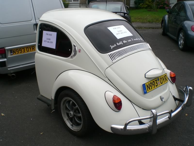

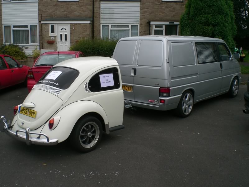

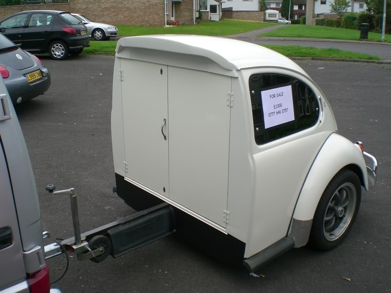

Got the Westy tow bar that was on Chug Chug off before he was scrapped. Had to weld the tag for the electrics back on because it snapped when I straightened it. My M8 Dean got it picked up shot blasted phospher coated & white powder coated for me. & now it looks the dogs bollox. The black marks are from where I trial fitted it. It won't fit properly because the Previous owner fitted J-tubes instead of the heat exchangers & this makes the exhust sit higher, when I get heat exchangers back on I'll fit it then & wire it in then I can tow my new Beetle trailer:-

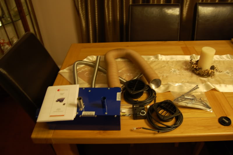

Got my new Propex heater yesterday, looking forward to fitting this I'll post full details when I do:-

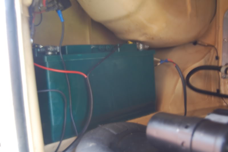

Wired up & fitted my fresh air fan & it works so happy days, I also got my fridge working off the leasure battery, not sussed out the tap yet though, the split charging system isn't working its been wired wrong & I'll need to sort it.
Pics of batteries both will be changed soon:-

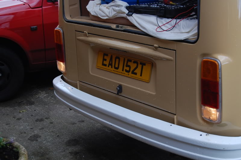

Checked my back lights & I had a reversing light out so sorted it, happy to report my back lights are as new if not new & are Hella:-
