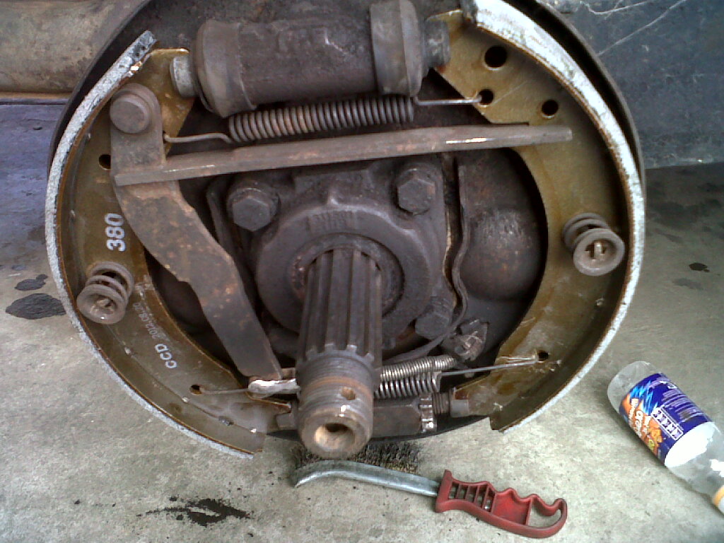

Re: My Bug - Never ends
never bloody ends does it. went to visit the parents last night and as i pull onto the pavement theres an almighty bang and the right rear locks up. drive into the driveway and alls fine. then on the drive home i take it slow and by the time i get there i can smell somethings not right. right rear drum is way too hot to touch and is giving off a wonderful combination of smoke and burnt brake smell. i think one of the springs has broken/come loose.

Eish man !! Yeah you'll need to take the drum off and see what went wong.
I once cooked my bus's rear right brake drum so badly it smoked like a veld fire in winter. It was adjusted too high so it caught on the shoes all the time I drove on the highway. Luckily nothing broke but I had to replace slaves and rubers afterwards.

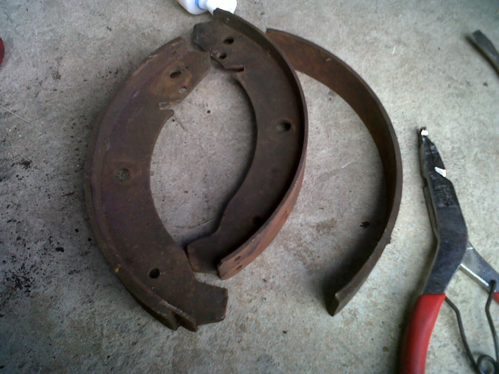

right so this past weekend got some work done. after much swearing to get the 36mm nut off the drums (stupidly tight and some old age) and lots of hammering to get the stuck drum off, i succeeded. turns out the last time the bug had brakes done they used cheap shite. the friction material had come loose off the backing plate and got jammed in the works. went and got a new set of shoes and fitted and cleaned alas, then ran out of daylight so i kinda dont have a working handbrake for now
anyways heres the old kak bit
and heres one side all new and nice

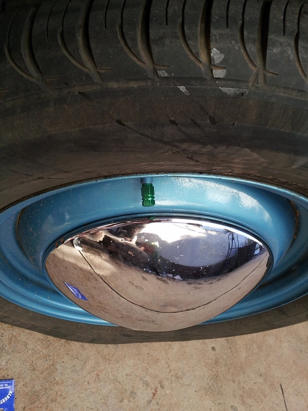

also gave my smoothie caps a bit of love and finally fitted them.
