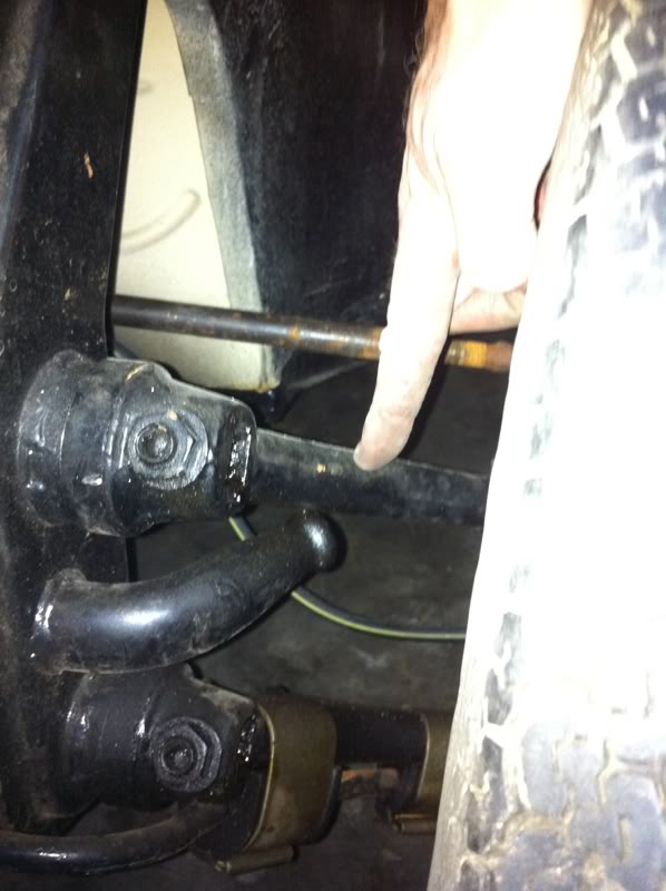

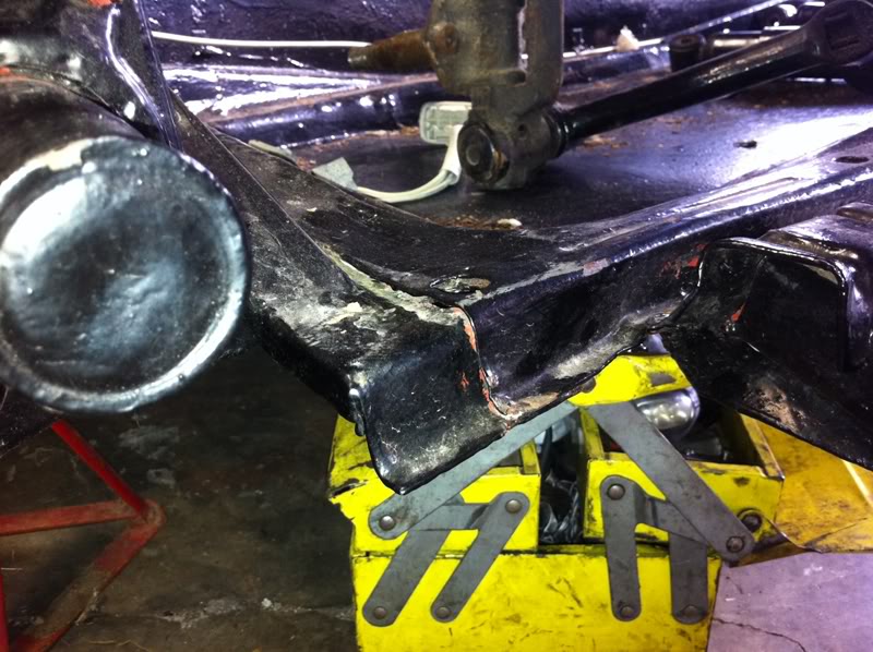

Bit of the chassis that needs welding. Found this when trying to jack the car with the body on. The jack went through the body! But, that only happened because of the rust on that part of the body.

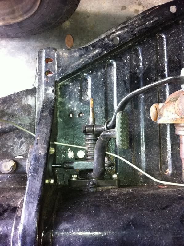

Pedal assembly. As you can see, the accelerator is not present. Need help with this guy. I have the rod that connect the accelerator cable, which is a few pictures below.

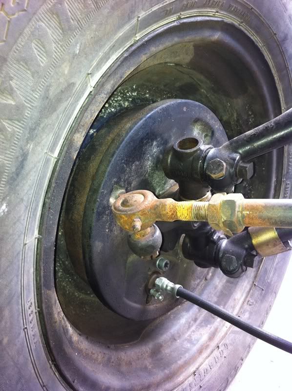

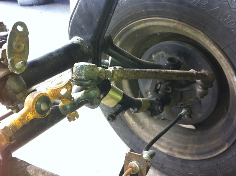

Left front tyre. The Tracking rod (amI right in saying that?) is rather crusty indeed, but should be fine after a solid clean and paint. All the rubbers need replacing.
Front right tyre. Same story as the left. All rubbers need replacing and also need a steering damper.

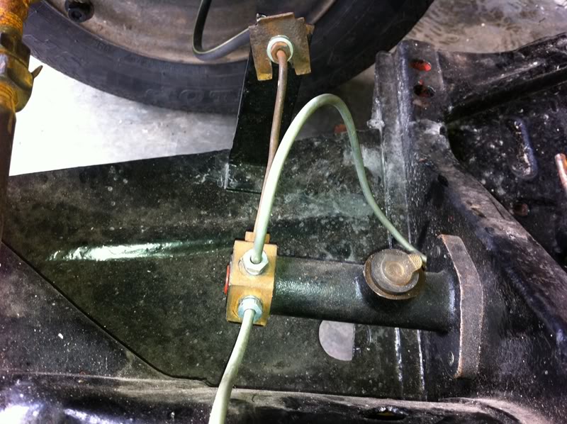

Need the brake switch and Brake fluid tank. Anyone have a period correct brake fluid tank?

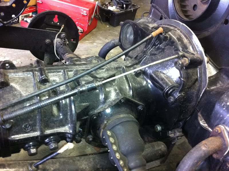

Clutch and accelerator cables by the gearbox. Few parts here missing. Can anyone assist me with letting me know what I need and if you can help with parts? (I really need a technical manual.)

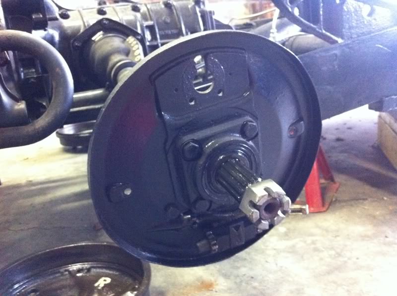

Rear brake drum. As I opened it. The seal are leaking gearbox fluid. There is no wheel cylinder or shoes. need to replace both sides completely. Drums look skimmed but in very good condition.

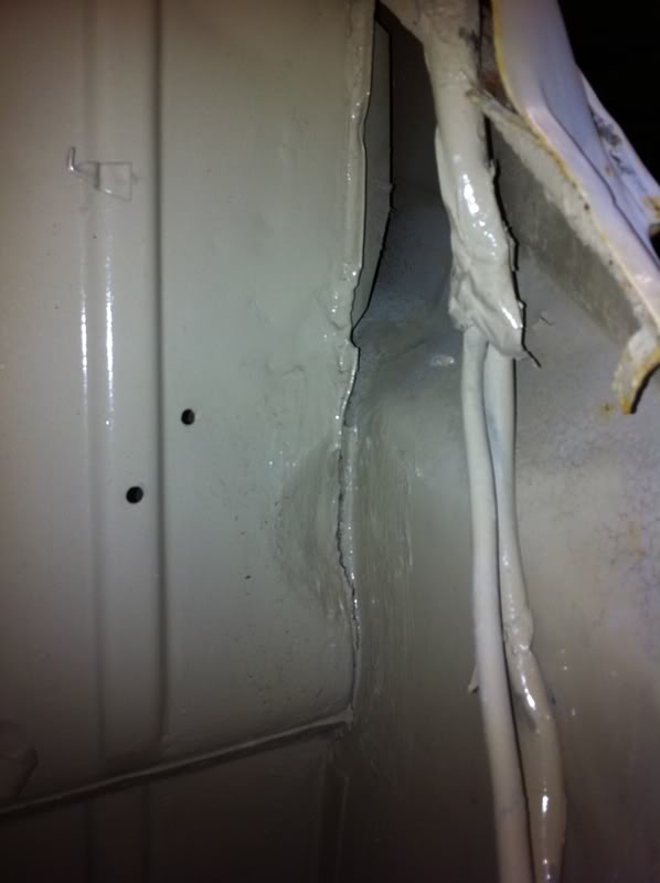

View from engine compartment. Needs to be welded closed. Same story on the other side.

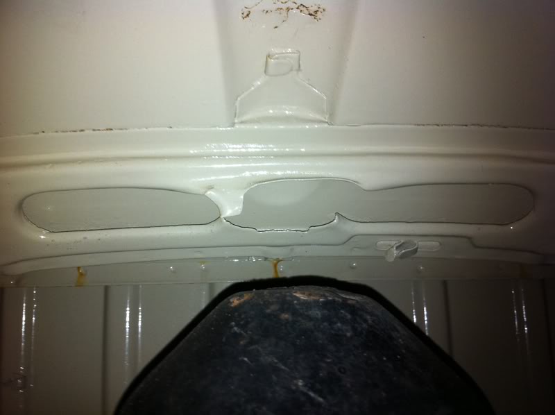

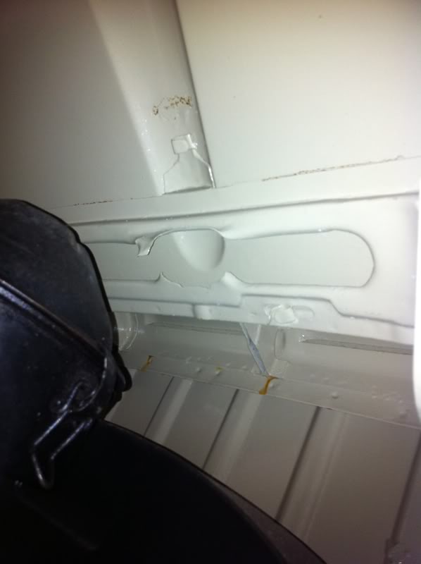

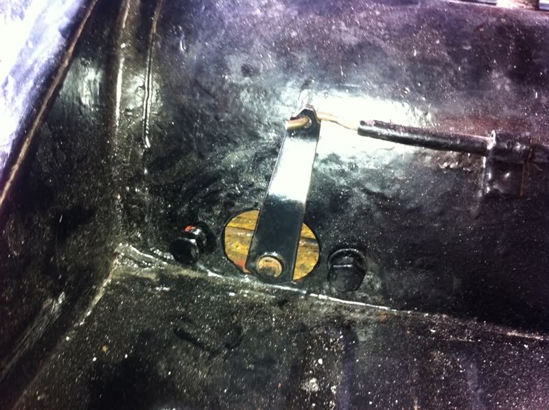

Underneath the decklid. Need to repair this otherwise I cannot fit the spring to keep it up.
Another view. Can someone advise on how to do this?

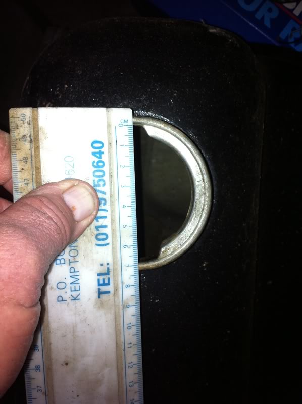

Petrol cap. I need one, this is how big it is.

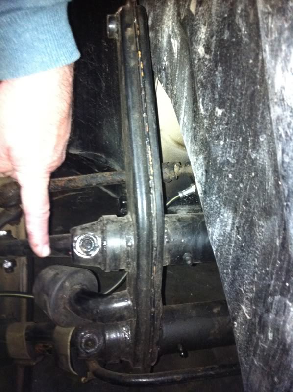

A bump stop? Cone shaped rubber on the right side of front suspension.
And here it is missing on the left hand side. I need that too.

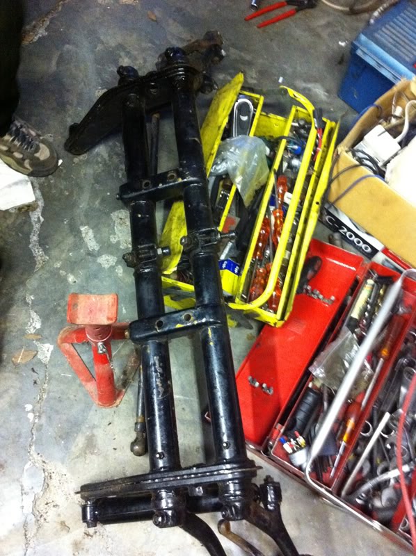

Close up of the adjuster system on the spare front end. Anyone seen this before? Looks like an old method.
Here is a shot of the bean. It looks like it is a LHD beam, judging by the brackets for the steering box. If anyone wants this, PM me with an offer. I am not going to be using this.
The beam currently on the car is standard, but instead of adjusters, I want dropped spindles. Will do that once the chassis is completed. So no need to do it now.

Re: Betty the Oval - MINCE
That's a very common failure point on oval Beetles. Mine has broken in the same way.MINCE wrote:
I haven't had a look at the differences, but VW must have improved the design on later Beetles. Since the spring is identical to 70s Beetles, I'd say simply cut the relevant bits from a 70s engine cover and weld to the W cover. That's what 'm planning to do for mine.

Thanks Fig! Good to know!
anyone got a spare decklid for me to butcher?

You can get that cone shaped bump stop for the front suspension from Pro Auto Rubber in Killarney Gardens, they also stock a wide variety of rubber seals for the Beetle
