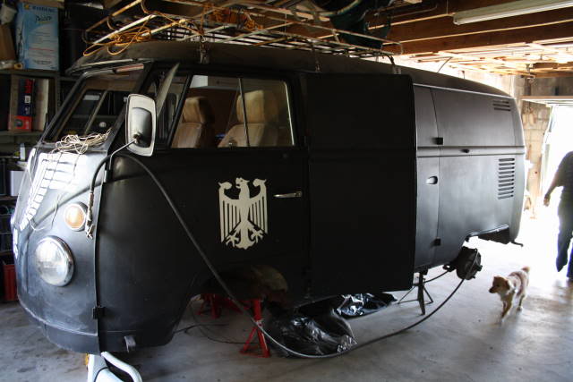

Starting to remove engine and gearbox today to get the beetle box in,
What do I need to swap over to the beetle box from the kombi box and why ??
Fleetline poked its head out yesterday

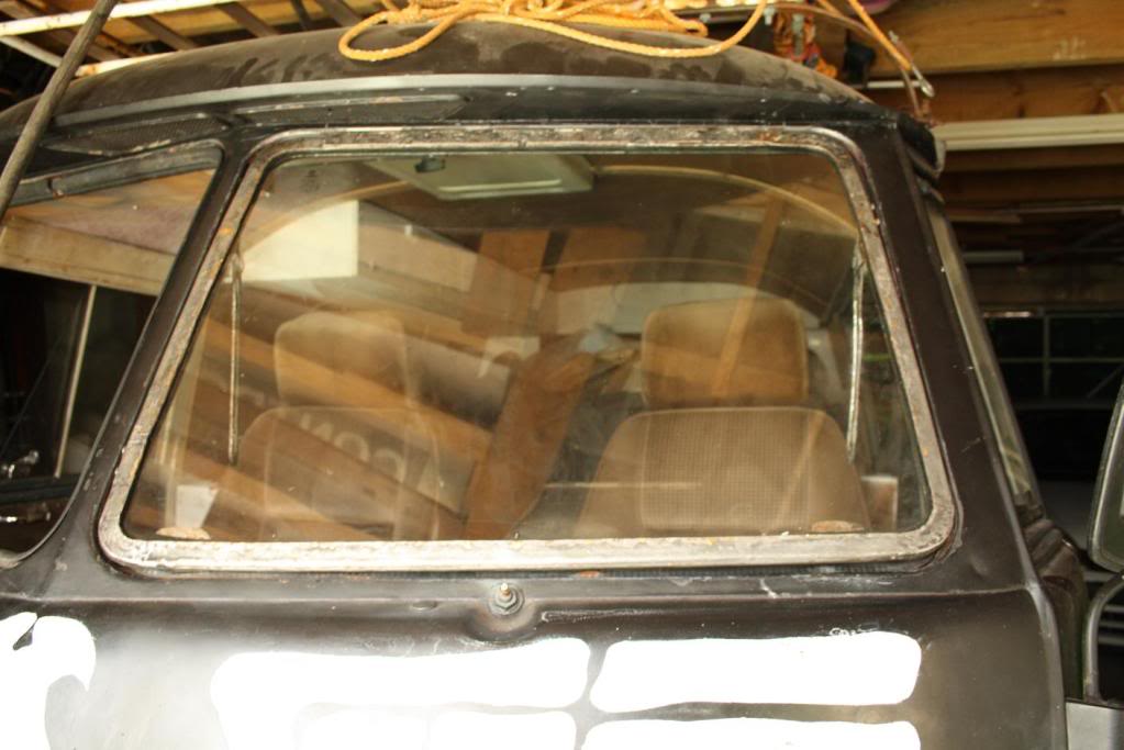

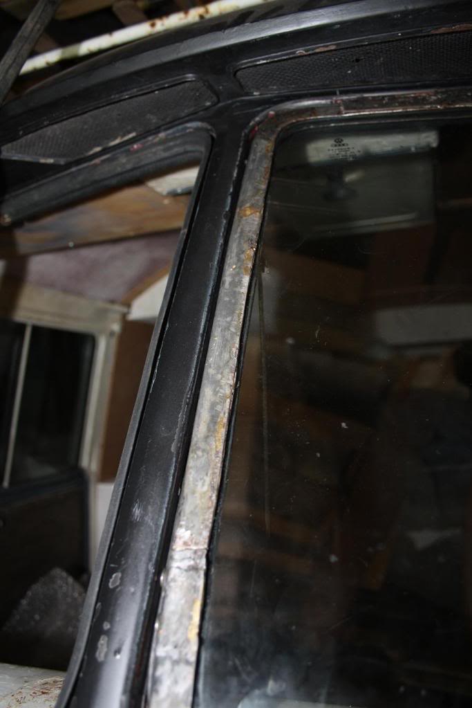

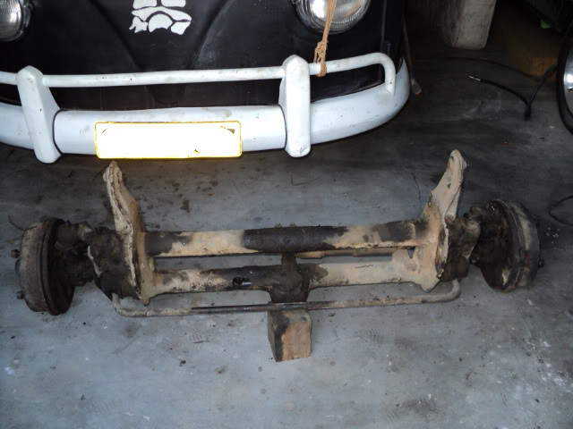

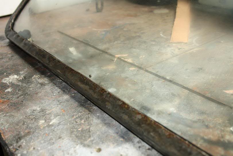

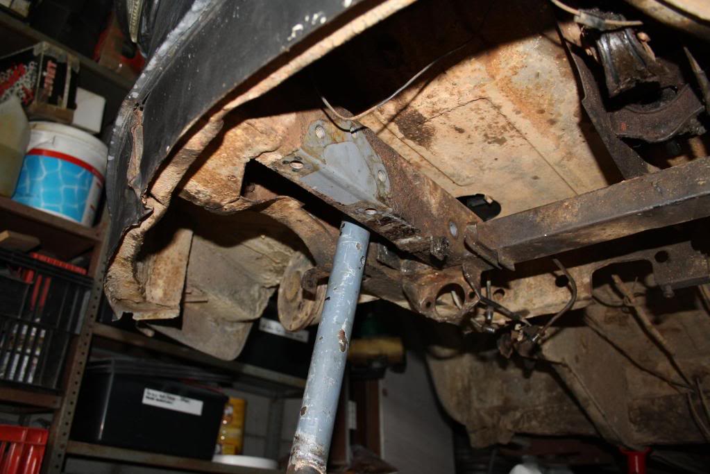

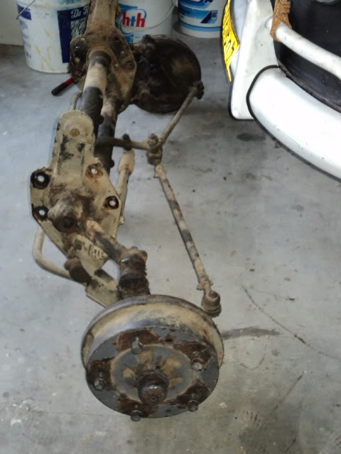

Quick update: The safari windows are done, Paint stripper and then some clearcoat on naked frame, started to fit them aswell,

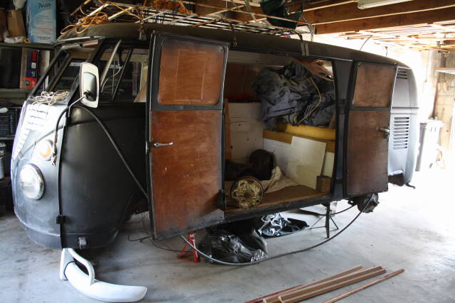

Stripping the front end to make room for the steering raise section

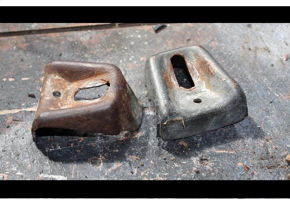

Removed roofrack+ladder to accomodate for lifting the bus at the front to get steering out and giving some workspace underneath, anybody have or know where I can get 4 more of these ?
