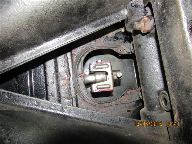

But tonight i got the gear shaft out, cleaned it and fitted the tunnel bush, re-fitted the shaft back.
Working in the small hole at the hockey stick side was a killer,Big hands small hole bad eyes, short temper... man was it painful.
Will post photo of this magic little dark hole of type 3
Fitted the hockey stick end box from old box onto the new, and made sure that the seal was good.
Need a clutch cable bowden tube holder bracket, as the new box has the bolt on type which did not come with the box.
Till next update....

As promist here is the photo of this tiny hole that these big ham fingers had to work in.
Well with blood sweat and swear words, I did get it done.

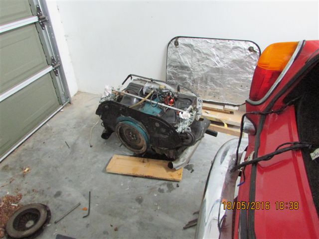

Here some more of the Fastback in for its pits stop.
Got the gear lever in and closed all the inspection covers, cleaned the side shafts ready for installation, and refitted the spare wheel well, with seal.

No, the engine is a Villiersdorp-ean and that is the colour Arno does his engines, so the box is just a copy to match,
She Is getting an SFAS box just to treat her, and she looks a lot better & sexier with LONG legs..........
You can see thats she's my well rounded, Long legged plaything in red.
