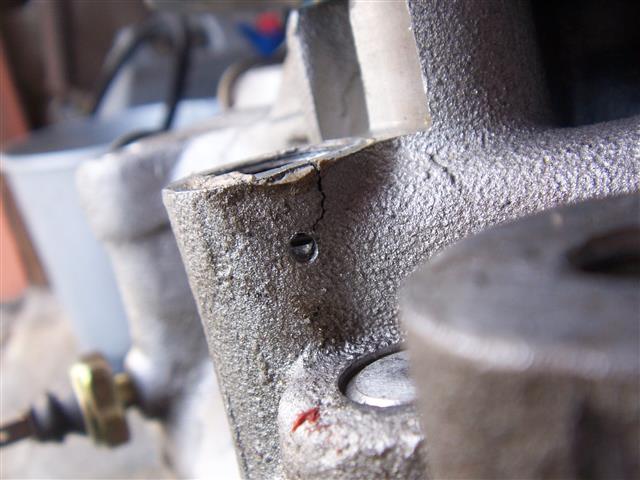

As a small follow up, here are two pics.
I thought I took more pictures, but obviously didnt...
This is the crack itself. You can see I drilled a hole to stop the crack in its tracks....
for those who dont know, if you dont drill a hole into the end of a crack, it will keep going even after you have repaired it and welded it closed. The hole stops it dead in its tracks and then you can repair the crack by grinding out and welding.

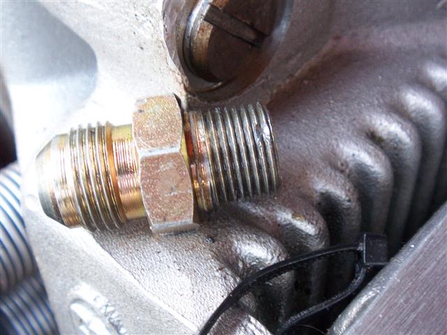

Now obviously I didnt want shavings in the main oil gallery. So I made the decision: I'll put the hose fitting back into the case and drill out the crack. If the drill misses the fitting and shavings land up in the oil gallery, then I will have to strip and rebuild the engine just to be sure.
Aluminium can easily foul a bearing and thus any loose aly inside the case needs to be removed (in my case by rebuilding)...
So as you can see in the picture below, the drill hit the fitting nicely, with about 1mm to spare.
1mm away from a rebuild.... so even though I didnt appreciate having to pull out the engine and fix it, I was lucky to spot the crack while I was in my garage and also lucky to not need to do a full strip and rebuild...
