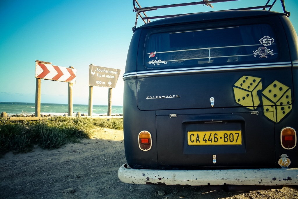

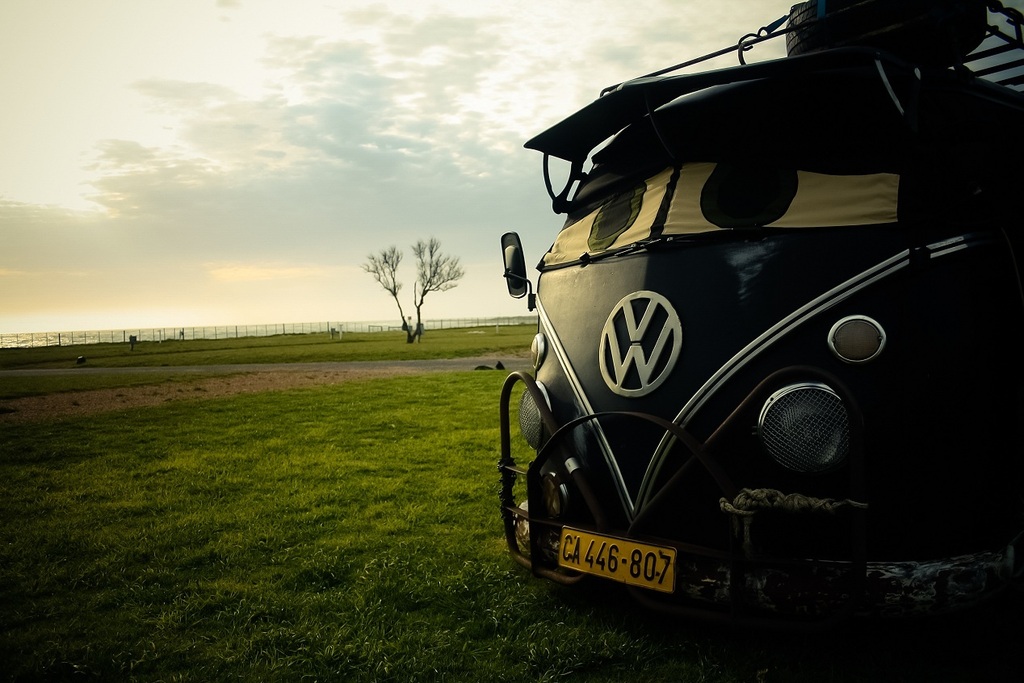

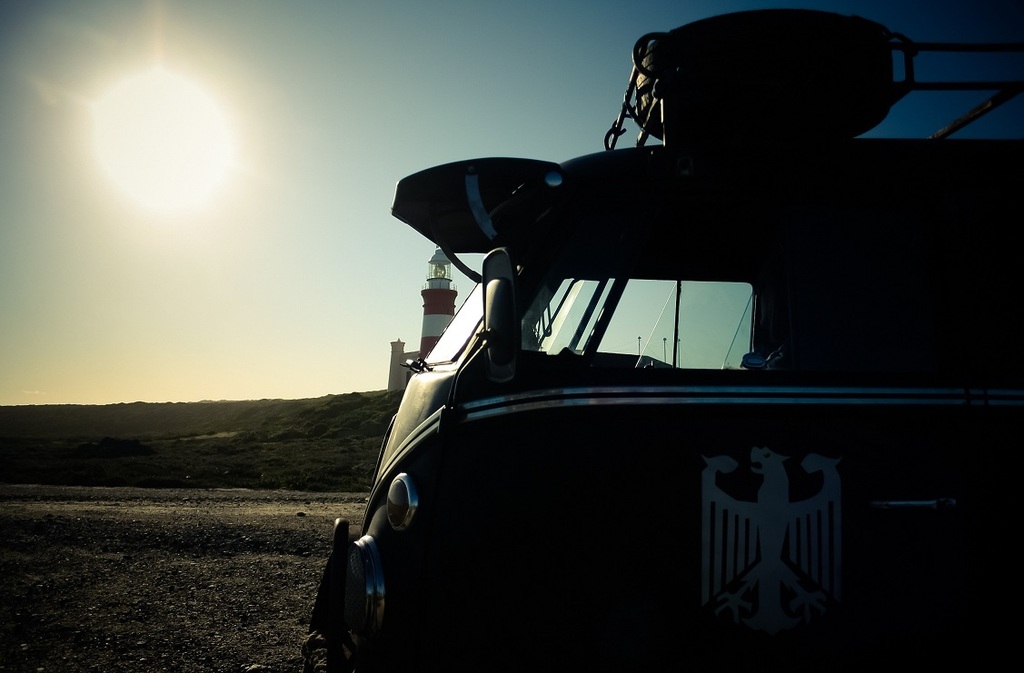

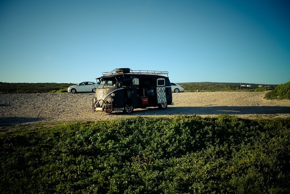

Did a trip to Cape Agulhas this weekend. Drove through the Saturday morning and came back the Sunday afternoon. The wind going up Sir Lowrys pass was insane. Luckily there was not much other cars on the road, and it was just that first stretch going up that we were crawling. After that it was a smooth drive all the way.There is also a very nice scenic road between Gansbaai and Bredasdorp. We camped over at Struisbaai, not much going on except the wind. I worked out the fuel consumption and got 12km/l, driving back we went through Bredasdorp - Napier - Caledon with the wind behind us. Some photos:

Nice road trip, well done D
- Posts: 15008
Re: 67 Panelvan
awesome!
The way you are posting pics and the quality of your pics, we need to start a "Donovan D's pic forum"
