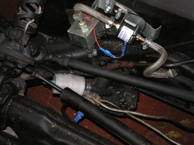

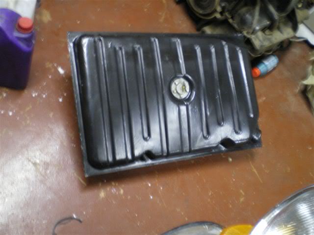

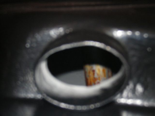

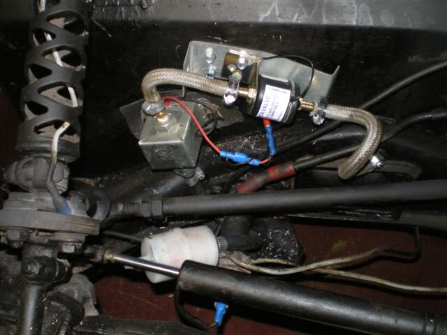

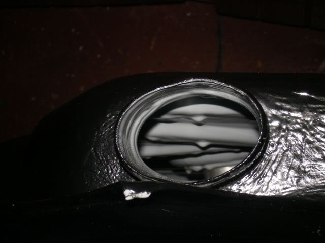

So the Tank has been cleaned inside, de-rusted, epoxy coated, and cured for a week.
Also fitted a Electrical cut off solenoid into the fuel line, so that it can be used in 4 ways.
1) to shut off fuel when not running, so that I will not have leaking into the engine,
2) will shut off fuel when there is a fire, as all aircooleds burn out because the fuel gravity feeds the flames.
3) to link it to the burgle alarm, to stop the guy driving it away.
4) with an added concealed switch, I can control the pumping of fuel when servicing the car.
You will note that I have placed the pump on a rubber pad, to reduce noise, and the Fuel Solenoid on a plated raised plate for cooling.
Here an other view
Here are the photos of the epoxied tank, inside and out, but the outside was covered with rubberrize, to stop chipping.
