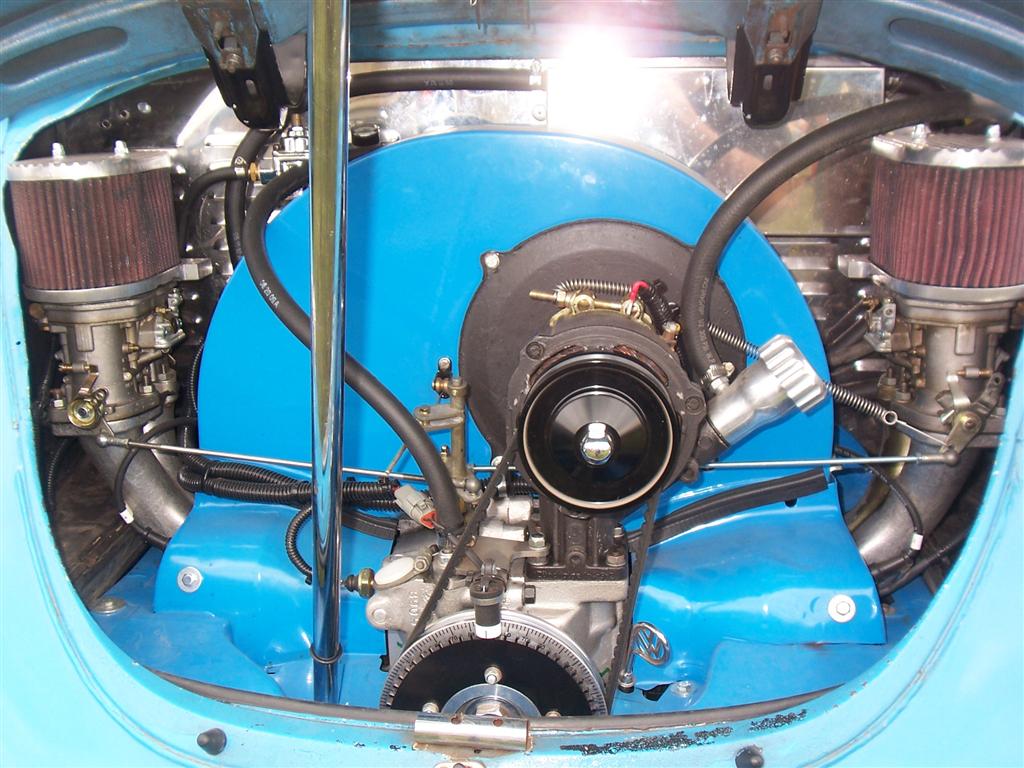

I found a pic of the engine as it stands now. A little neater than it was a few years ago...

Tony, THAT LOOKS SWEET!!!! So flippen neat... We must talk. Will arrange a time for me to come visit!
