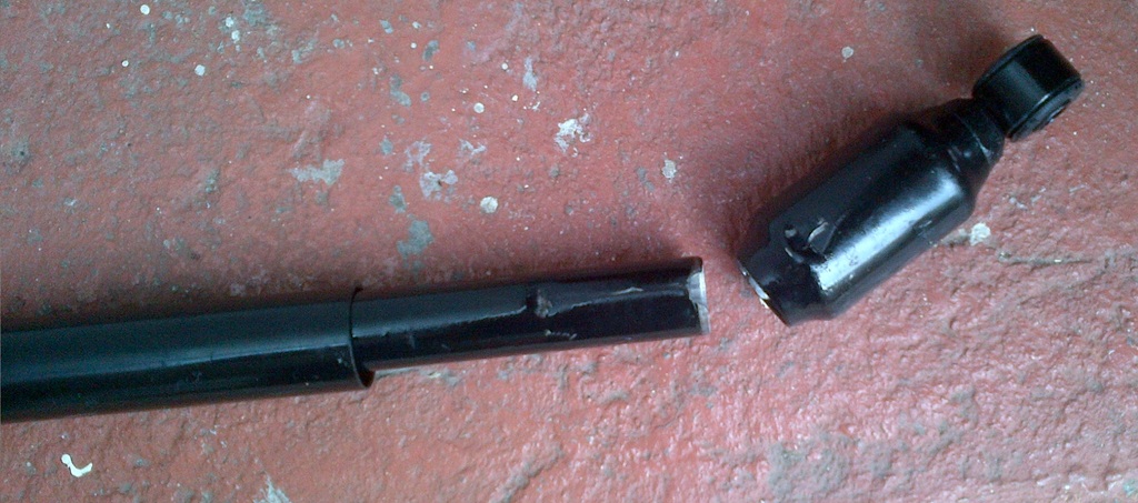

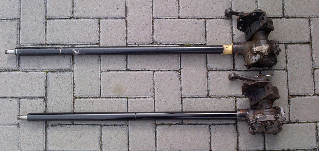

Finally managed to shorten the steering shaft. Reason for shortening it is because my steering box sits 4cm higher up, which means my steering wheel has been 4cm higher than what it should be.
So while jacking up the kombi to get the steering shaft out the exhaust hit the ground. Jack out and started to lift the rear of the kombi to clear the exhaust. With a big bang the kombi front came off the jacks and hit the ground. My steering damper did not make it, luckily no one was under the kombi. Just hope theres no other unseen damages.
Quick trip to Dave and a chat there and back in garage with new damper.
Steering shaft came out easily and I didnt have to jack the kombi up too high up. New shaft in and realised my steering wheel is out about 90 degrees to the horizontal position. After a lot of head scratching my dad and I realised that when they welded back the inner shaft that the woodruff key and worm gear is on they didnt align it with the line we made in the shaft to ensure the key opening would face the same way. :evil: :evil:
I do have a spare split steering wheel and wondering if I could make another key groove in it so that the steering wheel could be in the correct position. Would this work ??
Damper
Shortened shaft

Yes D, it will work, as long as the two grooves are not to close to each other or they will break through.
The most twist is taken by the tapper of the shaft and wheel.
But you can weld up the old groove if you so want, but be careful for the tapper.

Trying to get a place that can get it done.
Took it for a drive on Sunday and what a difference !
The kombi drives soooo much better now. The play is almost gone and its a lot more responsive when turning.
Really happy and should have done this years ago.

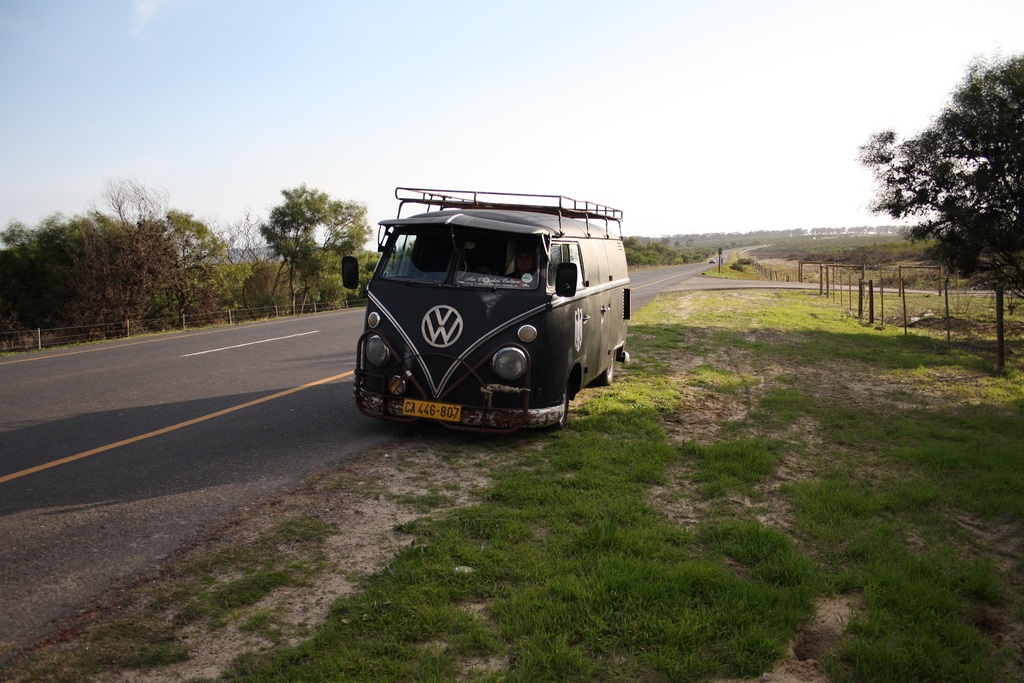

Managed to get the steering wheel broached to get it aligned right, so while trying to remove the old steering wheel the hooter wire tore in the shaft, the steering puller chowed through it. What a way to wake up the neighborhood on a Sunday. Got the new steering wheel on and a week later when I drove it I noticed that I managed to put it back on the original key :evil: . So took it off again and managed to get it sorted.

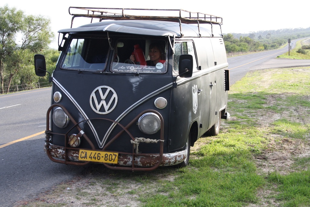

Took a trip to Saldanha last weekend. Cold early morning start and Stopped in Yzerfontein and Langebaan on the way. Fuel gauge showed empty on the way back so we pulled over for some coffee and a fill up from the jerry can. Really need to get the rubbers for the pedals, my feet were freezing.

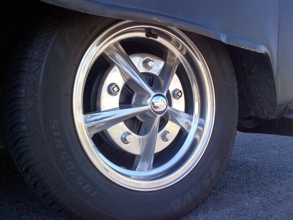

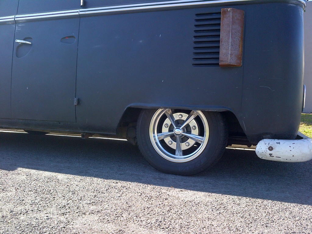

While checking the valve clearance I took the oppertunity to paint the rear wheel drums.

Drums look good D - subtle so it isnt noticed - the way I like it.
