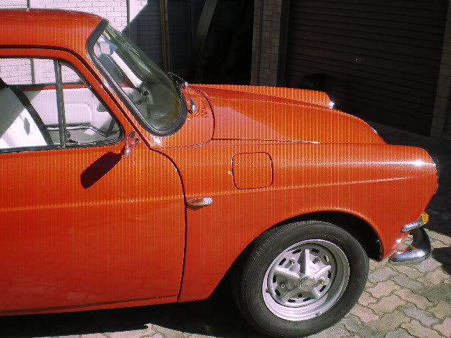

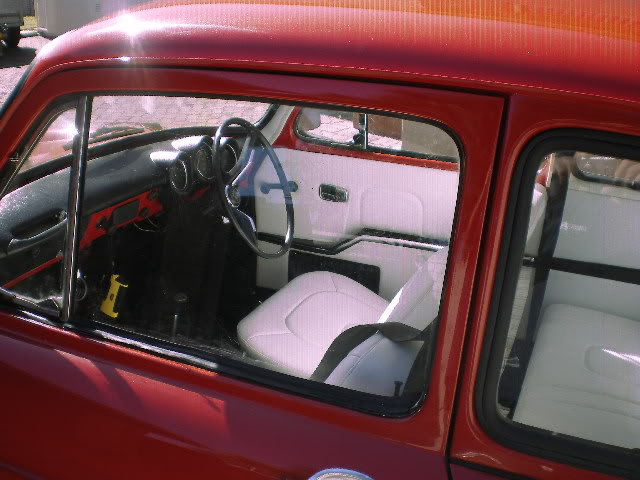

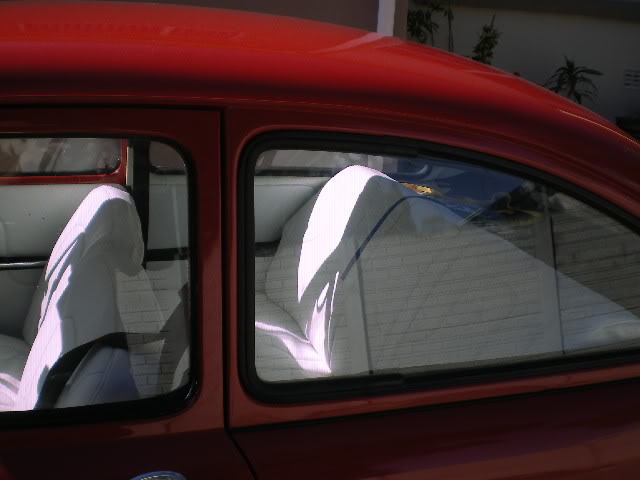

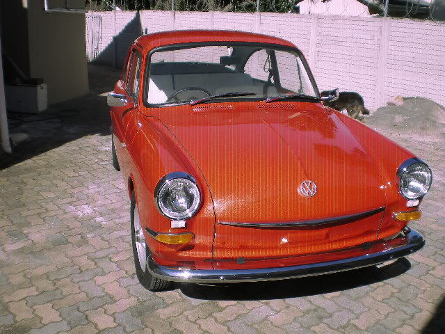

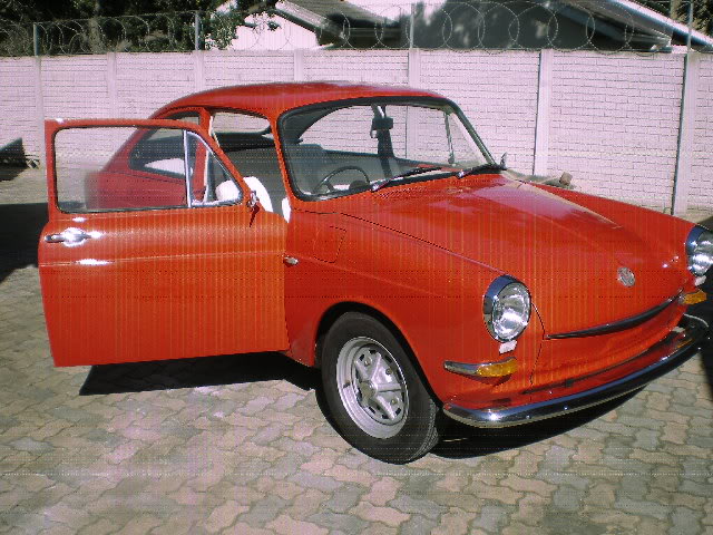

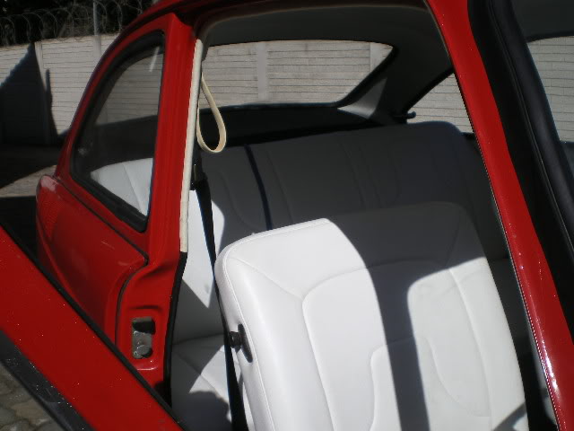

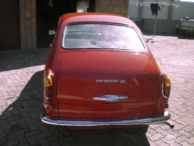

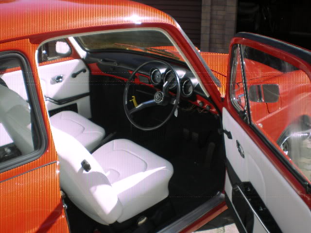

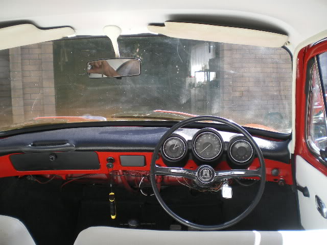

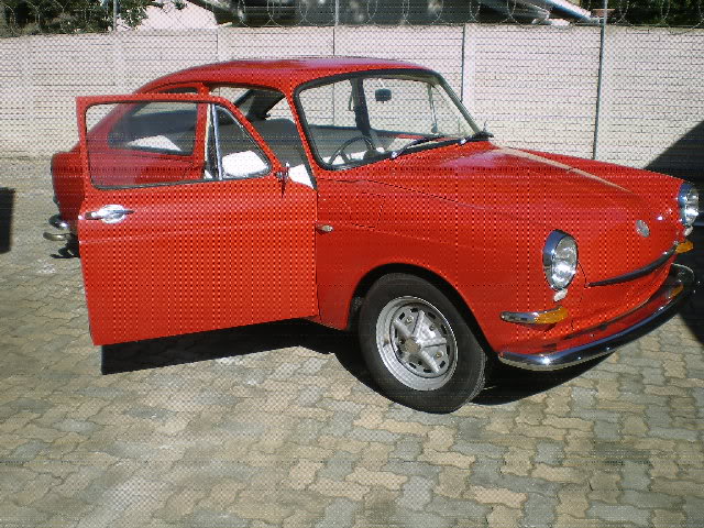

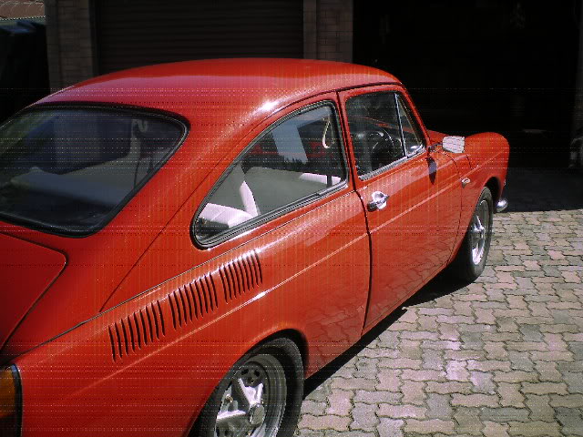

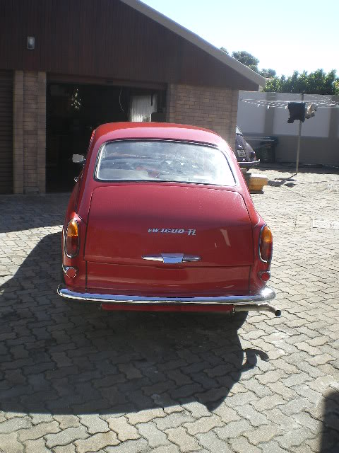

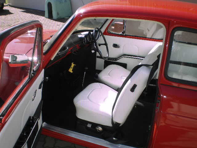

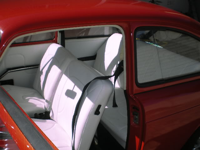

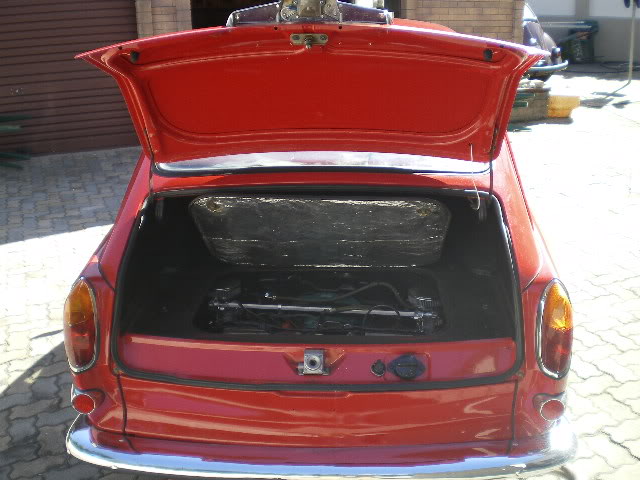

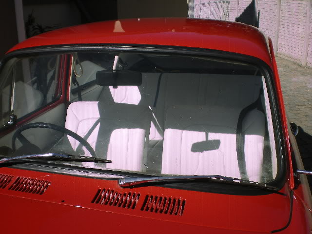

Well guys, its been a year, and then some, the
hit the fan a few times, other times things went very well, BUT at last the Fastback is on the road, and driving well.
Went on the 1st outing today, for a 80 Km round trip breakfast, Ran like a dream, what a feeling to run the thing that you have worked on for so many hours, man this was great.
For the guys with 20/20 vision, (HR) you will find that the back storage compartment is still awaiting the carpets, the arm rests still await the arrival of the rest pillows from the Upholsterer. Also the under dash cover, Yes, they do not come out with them, but mine will have a white one, with a parcel shelf, ( note to Santa.....)
Well here goes, the Photos of the (more or less) completed 1968 Fastback
Well will let you know when she goes through roadworthy, and gets her new number plate,
Till then...........

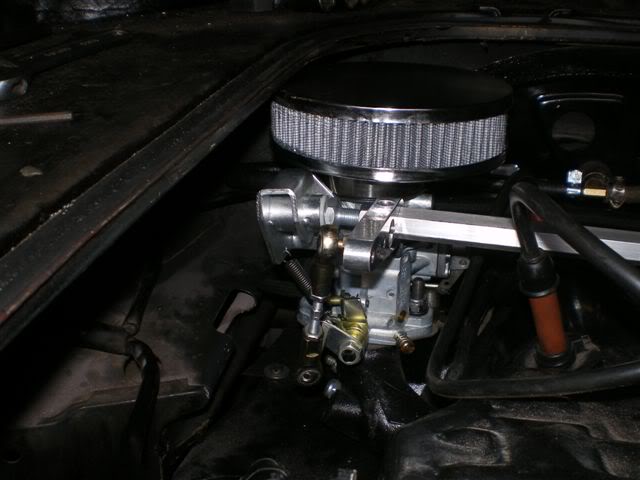

Mooi man. Looks very cool. Whats with the strippy paint work??

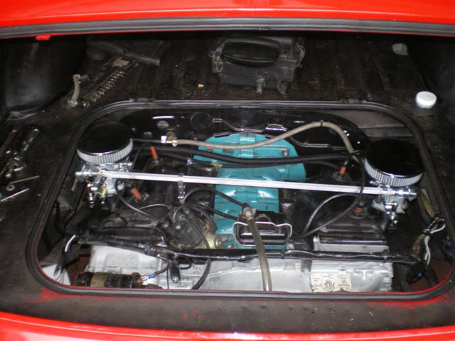

Can you post a closer pic. Showing the carbs. Just one side will do. Ans what carbs are they??

Thanks guys, I am sure with out all your help, this would most probably not have been possible. Thanks again ALL OF YOU.

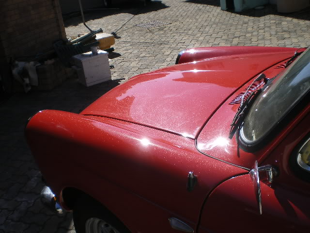

Hey, HR, Did you not know stripes are in this year.........
Good paint job,
camera.
What confuses the camera, is that there is very fine metallic in the final clear coat, which looks brilliant in the sunlight, but confuses the
out of the camera.
Thanks for the compliment, I think.....
The carbs are twin 34 ICT Webers, work fantastic on the 2000 type 4.
Good paint job,

Re: Not 1967 but 1968 Fastback now with twin weber 2000cc mo
Cool.Thanks, mine is running Dellorto's and I have a modified engine cover. Was wondering how you were using the original.
Obviously the dells are taller than the Webers.
- Posts: 8710
- Been thanked: 541 times
Cheated a bit.
Got a set of short manifolds from Rui, skimmed them down a bit, and got supper thin cleaner.
still have the short Empi Manifolds here in the box.......
Also no heat spacers, also in the box...

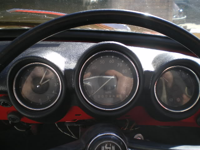

Had to find the cause of the jumping speedo, Removed the cable, re-greased it, but found no fault.
Then I removed the speedo, and found the magnet drum axle was to thigh, striped the speedo, cleaned the shaft's, and re-greased it, re-assembled it, and yippy, it working fine.
