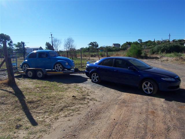

A pic of the departure to the George show

Tony Z wrote:A pic of the departure to the George show
I did not know you also stayed on a Farm

Its only a little farm.

Its one of those new Posh 4 x 4 areas.............
You get your own SAND ROAD.

not a farm, but a small holding. Not too far from Klapmuts.
No 4x4 here, just careful throttle work, especially in Winter when I need a decent run up to get the front wheel drive through the uphill mud patch. In summer its all gravel
