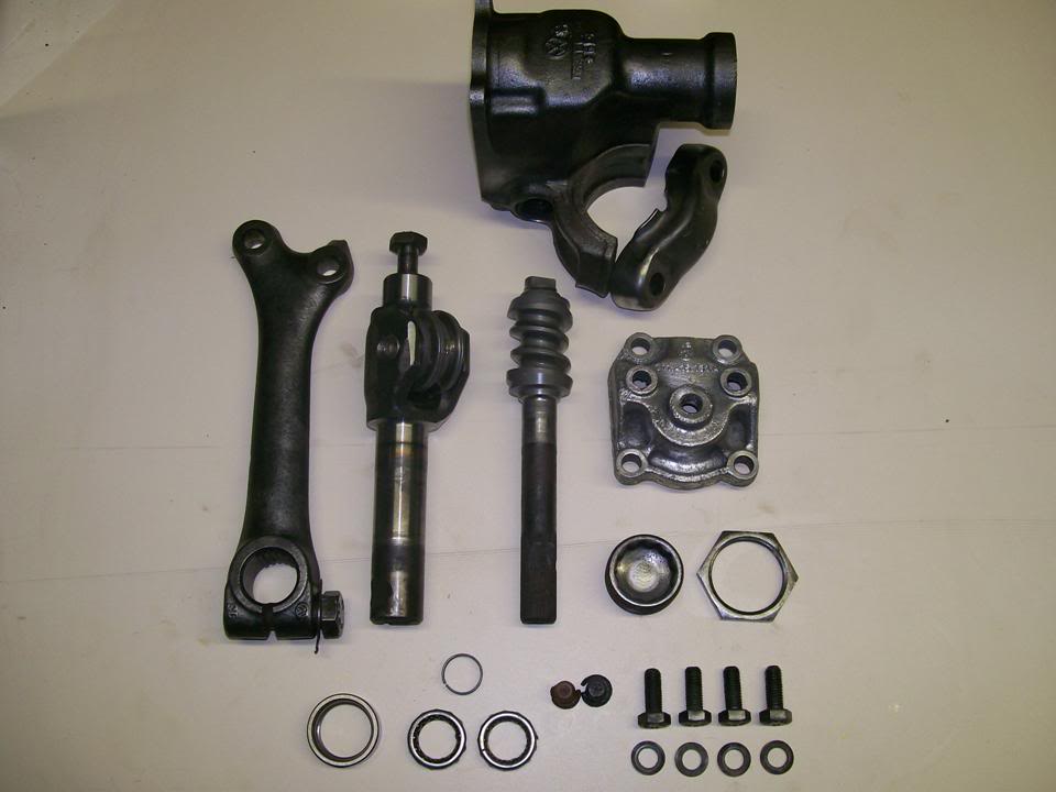

Update 10/11/2008 - steering box:
There is a popular song by Depeche Mode called 'Behind the wheel' - the lyrics goes something like
My little girl
Drive anywhere
Do what you want
I don't care
Tonight
I'm in the hands of fate
I hand myself
Over on a plate
Nice song indeed, but two things I surely won't do with HW2, namely 'leaving it in the hands of fate behind the wheel', or let a little girl drive it
So thorough attention will be paid to the suspension and steering systems of the buggy in order to ensure that everything works 100%. I am currently working on the front suspension, the beam has been removed and stripped, and all the parts on it cleaned. I have decided to go the dropped suspension route, in spite of my previous posts, but the purchase of the beam adjusters will have to wait a while.
To be honest, I did not have a lot of hope for the existing steering box on the buggy, and if you look at the picture below, you will see what I mean
So I thought 'what the hell' and dropped the entire steering box in the caustic soda solution two weeks ago with the other parts. When I took it out last week, it was a lot cleaner, but had a rough 'grinding' feeling when you turn the steering shaft. I opened it, and took it apart, more out of curiosity than anything else because I have never seen a steering box inside. You can't imagine the disgusting caramel-coloured grease it had inside, and the foul smell. I thoroughly cleaned everthing with a mixture of hot water and Handy Andy and Sunlight Liquid and Cleangreen. Spent the evening wirebrushing all the outside parts, and I am actually pleasantly surprised that it seems to have no wear on the inside
So, for the first time on ACVWSA I present to you a real-life exploded picture of a steering box

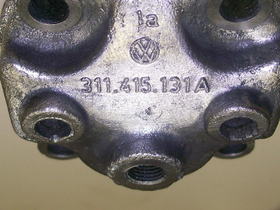

It turns out that the steering box is actually from a Type 3, if you look at the part number on the cover
Sometimes it feels like VW has gone the 'Da Vinci Code' route with their parts, look at the clamp bracket of the steering box for example - what the hell does that mean?

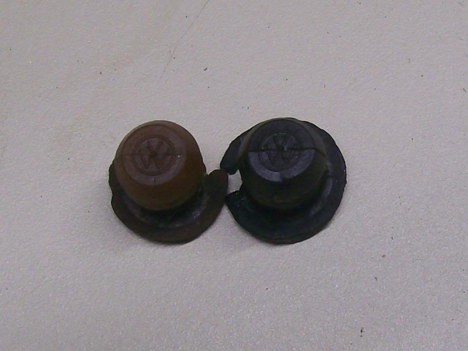

Oh, and don't they (the Wolfsburg guys) just love their own badge?
These little rubber plugs that fits in the steering box cover have VW logo's on the inside (where no-one will ever see it). They will also be replaced, as they are broken
I want to have the rubber seals and bearings replaced on the buggy's steering box, can anyone perhaps suggest a place in Gauteng where I can have it done? (I'll also leave the re-assembly to the experts
) Don't think I'll paint the 'box, just leave it au naturel so that the magnesium can gradually oxidise and loose the shine, unless someone else has a better suggestion? Were Beetle steering boxes originally painted?

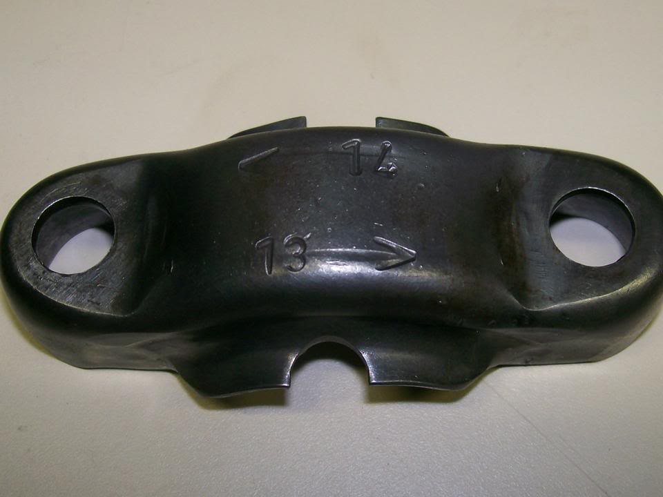

the 13 and 14... well maybe its to indicate a mounting position. Ships are generally (not always) built with odd numbers indicating stbd side (right) and even number indicating Port side (left).

Could be, but that bracket is pretty much 'all side, same side'
I wonder if it could be an indication where locking plates must be used, but then where would the other 12 be?
