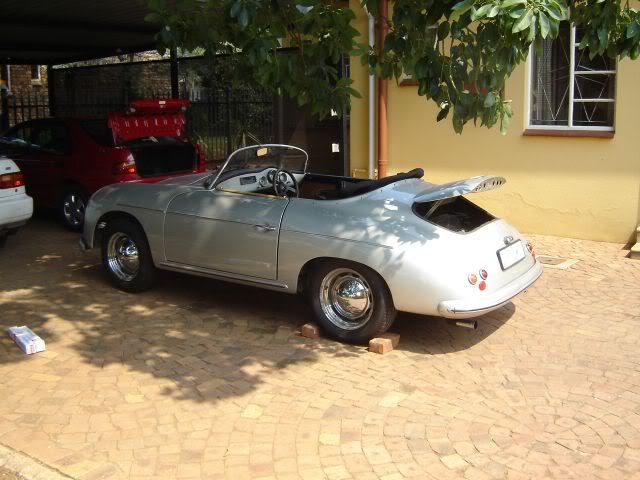

Update 24-02-2008

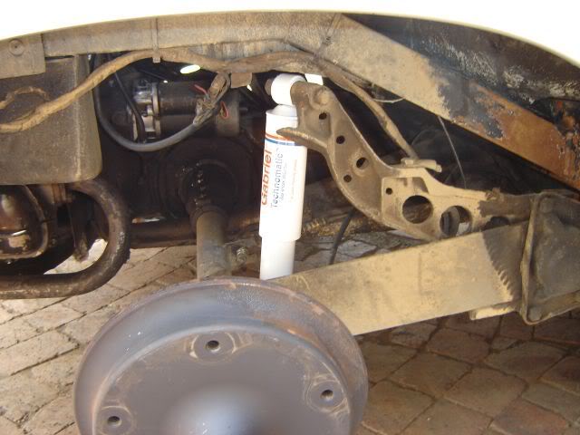

This weekend I finally got around to doing the shocks, I went gas riders all round and while this amounts to a pretty hard ride all round, the handling on the car around corners is a million times better than what it was.
I'm going to be taking off the gas riders up front and putting the old ones back on as the no weight issues up front makes the nose very hard and very unforgiving. We're going to modify the chambers on the old shocks to use a different kind of oil that will allow for the nose of the car to be a bit softer, this is a bit of trial and error and I'm more than willing to try a few options.
Next we're going to be taking a spring plate out of the front suspension to get the nose down a bit, by a bit I mean 50mm as it's way too high and this is resulting into only the shocks being used and not the upper and lower torsion bars on the front beam.
As I'm too high up front, the torsion arms that are connected to the leaves in the front beam is not being used. Not a good thing.
Next on the list after the suspension is a new generator and fitting the 36hp fan shroud and making a new engine compartment seal.
The car has been booked for a new dash pad, new guage cluster fitment as well as the rear hood latch and getting rid of the yucky lock for the engine lid. Some minor fibreglass repair work after that and then hopefully paint if all goes well.
During this time, the car will be 100% driveable........I don't want to yank this motor out until the other one is ready to go in. I want zero down time on this car, I don't care what it looks like, it's summer and I want to enjoy it as much as possible with the roof down.
This little exercise pointed out a new thing as well.............I need jack stands as well as a decent jack......Using my honda's jack and bricks to jam up each corner takes for ages, I could have done all four shocks in under 20 minutes if I had a decent jack & stands.

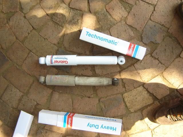

Nascar in Silverton...............R150-00 each for gabriel gas riders for a beetle.

Are those Technomatic shocks adjustable? What's the difference between the Heavy Duty and Technomatic?

oil vs gas

Sorry on the blower to bugger and I screwed up.
The gas riders only come in heavy duty, I don't know if it's all hype, but that's what the packaging says. The normal oil shocks for the beetle are also listed as being heavy duty.
Sales ploy........?

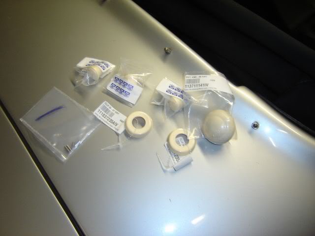

A little bit of an update with some parts that I finally got my hands on. (all my fault)
Firstly two people must be thanked. (smokingbus) for going to the states and giving us the oppertunity to order some small stuff through him and (lowlight) for picking up the items for me and holding onto them as I was swamped at both work and home and couldn't get out to smokingbus to pick up the stuff.
What we have here is new ivory dash knobs, door handle collars, pins for the door handles and a new shifter knob, this whole lot cost me R150-00 which I think is a total bargain. The quality from wolfsburg west is very good. And I can't wait for the car to be sprayed so that I can fit this gear.

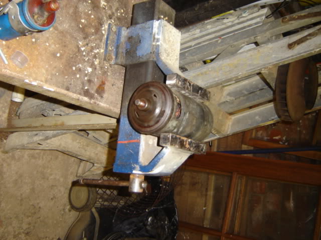

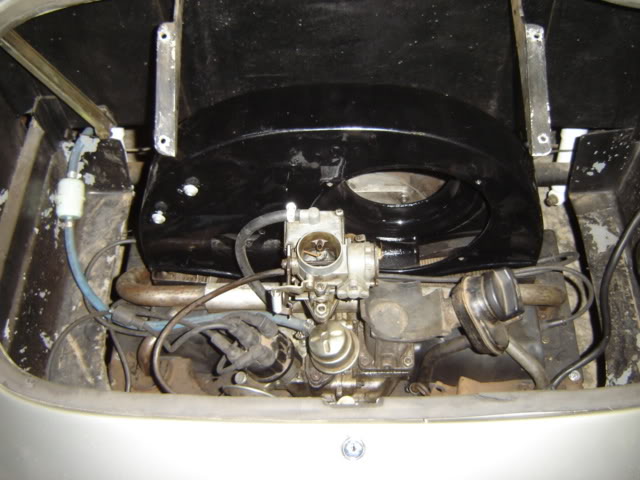

Last night I was bored, so I went out into the garage and started work on pulling the generator as the armature was knackerd and wasn't charging.

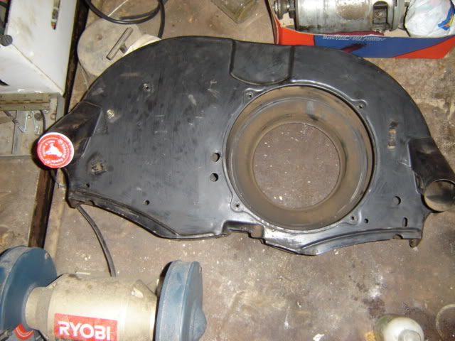

Took off the engine lid and pulled out the old fan shroud as I'm going with the 36hp one with no heater holes, this is great as now I can finally get rid of the purity lids that I was using to block off the vents...... :lol:
Genny out, fan off and pully almost removed. Now just to go to Dirk to do the exhange for a new one and then do it all over again.
36hp in to see how it fits, thanks to Rui for selling me this, they are getting pretty hard to find nowadays. The plans for the engine bay are simple, to seal it off properly, this involves removed the lower cowl that fits around the engine and modifying it so that it fits more snug, when the engine is out, I'll stone chip the whole inside and paint it the same colour as the car, which by the way has changed yet again........... :lol: :lol:
Even though this is only the temp motor, I'm still going to do some work on it. Twin carbs on type 3 manifolds that I'm getting from IMPI, centre mount oil filter from a 356B Porsche, basically a porsche 356 look a like. Once my 2.0 is done, I'll be doing this one over totally, so that I have a reliable spare that I can fit quickly if I have any issues with the 2.0.
I want the car to always be mobile.
