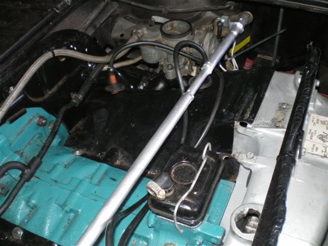

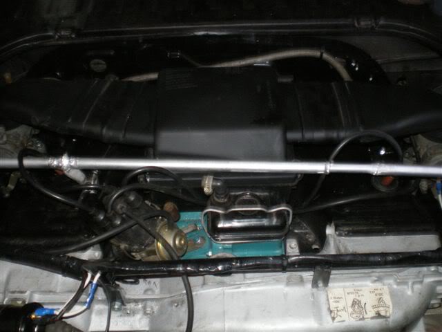

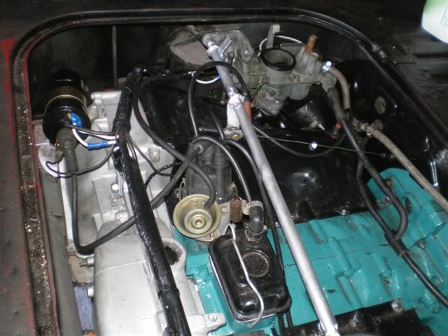

Having cleaned up the wiring, I started fitting the bus filter box into the Fastback.
the dust box had to be reduced in hight, so that it would fit into the engine compartment, with lid closed.
Here is the dust box before modification.......
And here it is after modification....( in hight)....
Here is the engine bay before fitting the filter box.......
And here the filter is fitted......
Now I can hear the two schools of thought shout loudly........
Where is the Bling.........
OR Why not back to standard....
Well I want to have it look near normal, and should the average Joe look at it, he would not know the engine is not correct and that the type 4 does not belong there.

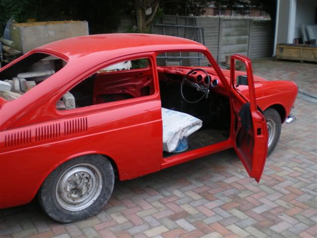

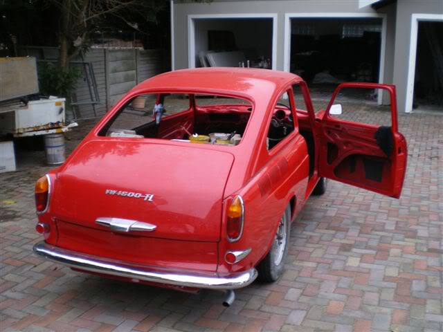

Well the "Road" test went well, no arrests, no tickets, no points off my licence, .... the car ??? oh sorry
Some pic's from return of road trip, note the "seat", and the "Rag trade" door locks.
Till next time.....
