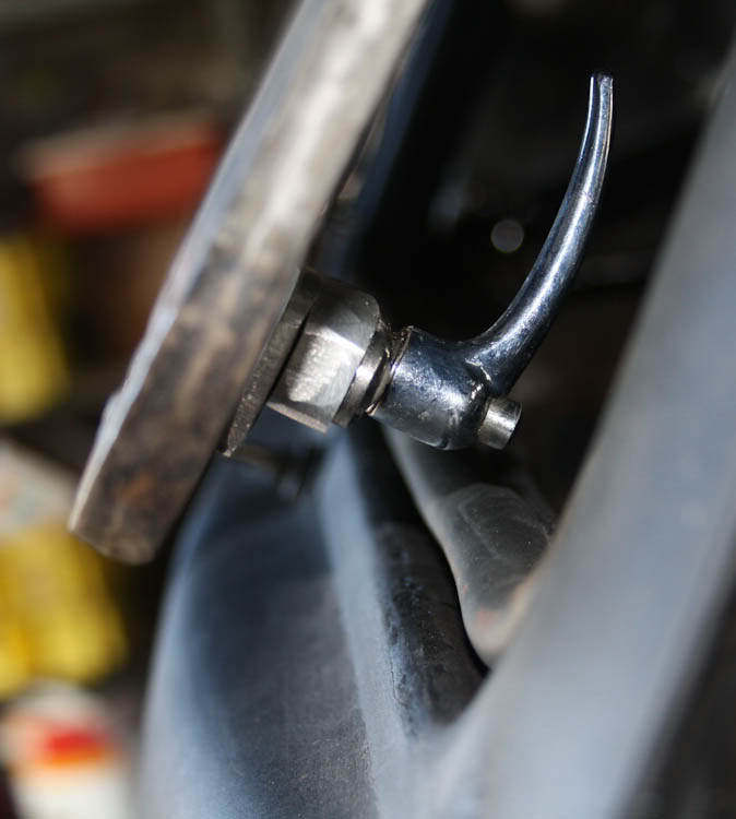

Spent the weekend sorting out my safari windows, the frames are a bit quirky and the one did not even want to open when it was installed, the problem seems to be with the location of the hinges which are not right on the frames. Because of this I had to get different rubbers for the front windows. Although the windows are not flush with the body when closed it looks to be a good seal on them, I will test it tomorow with the hosepipe. While doing this I had to "fix" the holes on one of the front windows on the body, which I did with a wire brush,rust buster, a small strip of fibreglass and some paint:
Because of the rubbers pushing the windows out, the latches and catches did not align so I had to move the latches upward and outwards. Had some alluminium about and made these:

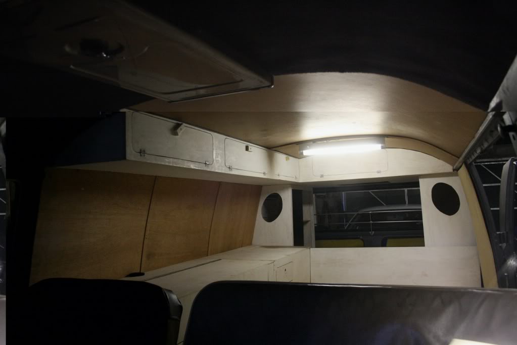

Going to start with the back this week. I have the table/bed a few drawers and cupboards.
First thing is to pull it all out and get some 100mm pink aerolite all around, for soundproofing and insulation. Then get it all back in again and just change a few stuff.
Not sure on colours or fabrics. I am going for a different look than the cabin.
Sorry for the dodgy pictures, something wrong with uploading to photobucket
Some pics of what it looks like now:
Table up:
Table down:

"camper box" is looking good Splitz
