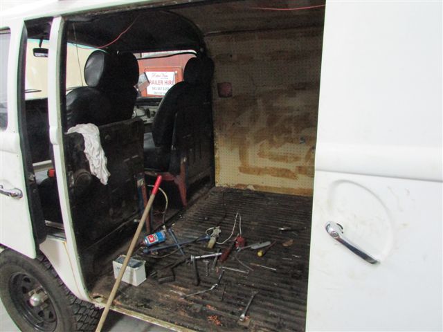

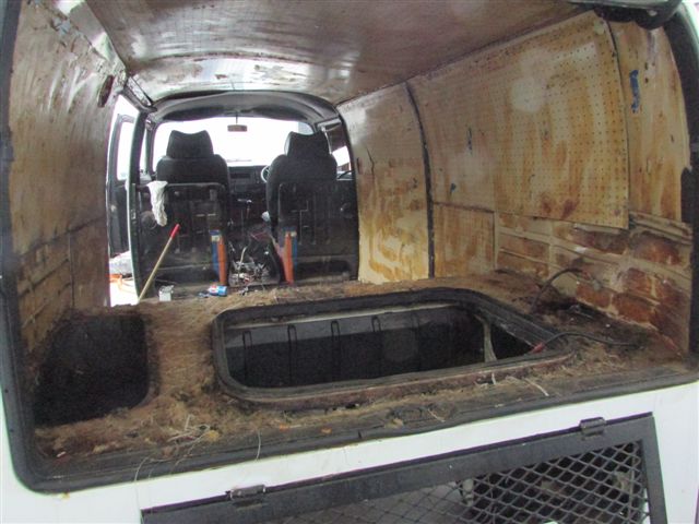

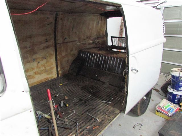

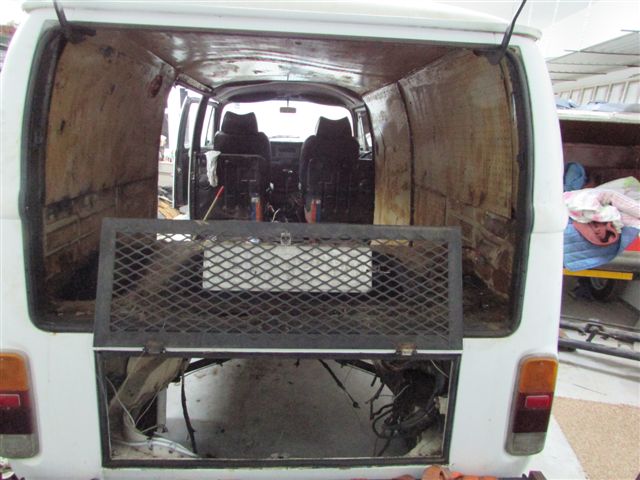

Started stripping her as she looked like the Black Hole of Calcutta. Every thing was Black, Black and more Black.
Not sure what the bus was used for, but it had the strangest hidden compartments, a hidden spare fuel tank, an home built air conditioner, and 3 layers of black carpeting,
It must have enough extra wires to redo Eishkom, and little buttons and secret switched everywhere.
The total weight that has come out was approx. 500Kg. all 50mm solid wood and 5mm sheet steel.
Well thats all striped out now, so now we will start to have a look at the original wires and reroute them to where they were to go in the 1st place.

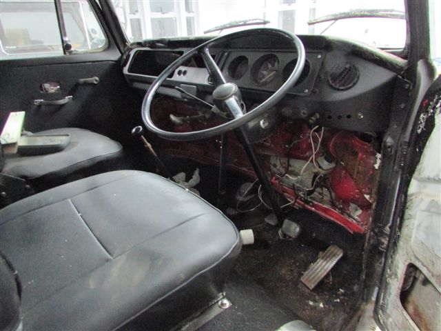

Well the wiring has turned out to be more then I thought, but have spent over 50 hours on it so far, and it would seem that I am getting somewhere.
Once the wiring is all working I will be replacing the front beam, as I still have the one I restored years ago.
Then the rest of the list.

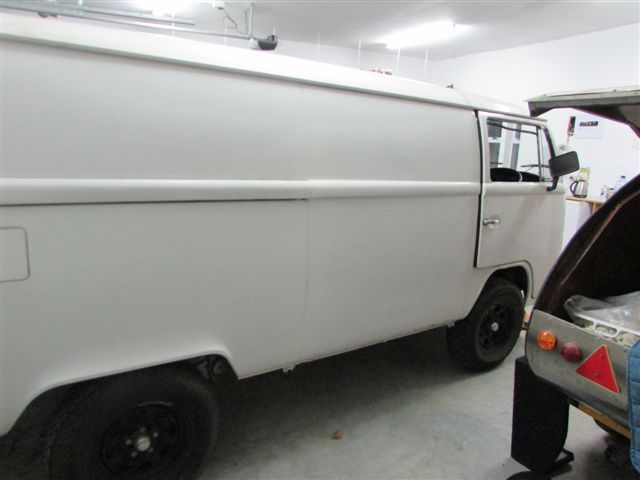

OK, so if you go to the top of this post, you will find the before photo's, and here are the follow up photo's as I have been striping the inside to start the make over.
Well till next time.

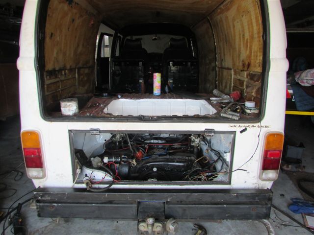

Well a lot has been done, but little to take photo's of.
Started by stripping out the unwanted.
Then I got stuck into the wiring, and cut out the "add-on's"
Managed to get all working, but will need original parts down the line to replace the temp. parts used to get her up and running.
Then I replaced the front beam, with one I reworked some years back......
If you need to see something funny, you need to see a 64 year old Toppy replace a beam by him self........
OK, so that went in, and sommer fitted new draglink at the same time.
Adjusted the steering box, and now the "Play" is gone.
Serviced and renewed the disk calipers, and had the disks skimmed.
Replaced the back wheel slave rubbers, and re-shod the brake linings.
Cut out the old Ford conversion re-rout of the clutch cable, and re-welded a new tube for the clutch in the old location.
Fitted brake booster and vacuum line with Non-return valve
Cleaned out the rust and dust from the light fittings and taped them with aluminum tape. for better reflection of the lights, front and back.
Made parts for the gear lever and fitted to 2lt box, set gear lever to get all gears.
Cleaned up the engine bay, fitted new rubbers, and transferred the Fugly 2lt motor into the Bay.
So officially as from now, the Fugly wil now become a donner car. and run no more on her own steam........... still a very sad day ........
So heres hoping that the Bay will make it to George and the KKK,
Will let you know......
