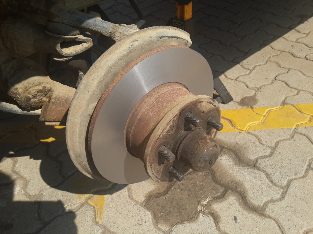

Just dropped off the brake components at Centoria.
Re-sleeve master cylinder, new slave cylinders, new drums, recon calipers, rebond shoes and skim the discs.
All flexible hoses will be replaced.
Wheels are in for sandblast and powder coat before new shoes.

jmvv
Posts: 714
Location: centurion
Been thanked: 24 times
Re: 1972 custom crew cab
Post by jmvv »
I love it when a plan comes together.
I am trying to address all the issues that might affect reliability on the way to Stellenbosh
This week we got the wiring sorted. Even the hooter works - though it sounds like a very frightened lamb.

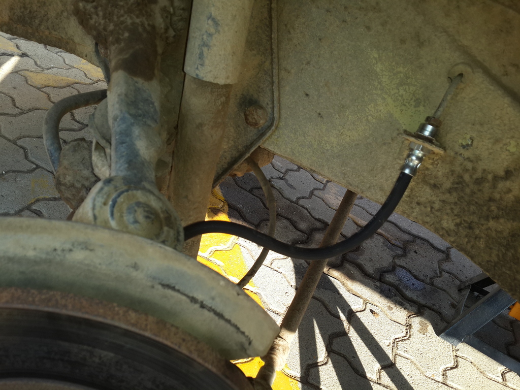

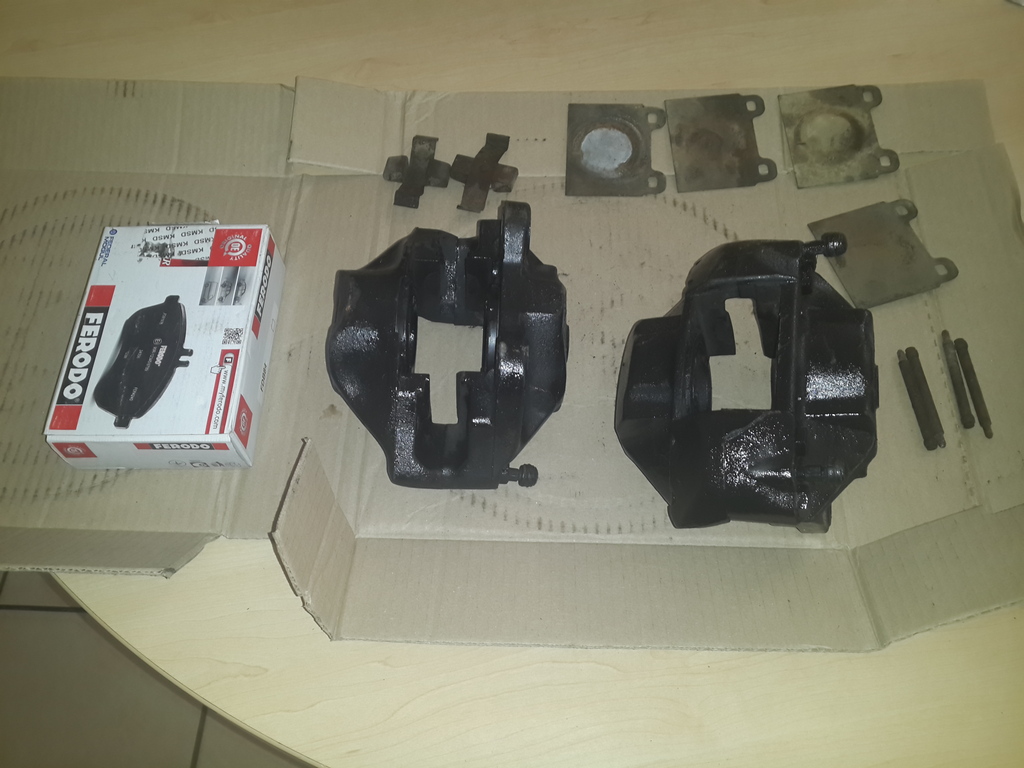

We got the brake components back:
New rubber brake pipes
These I had made up by a hydraulic shop, as my local spares shop did not have what I needed.
Rebuilt calipers
new pads
new slave cylinders
re-bonded shoes
new drums
We had the discs skimmed and now everything goes back together.
The sideshafts came out to have the CV's cleaned and inspected.
(What a mission to find the bolts under many years' mud)
They will go back next week.
