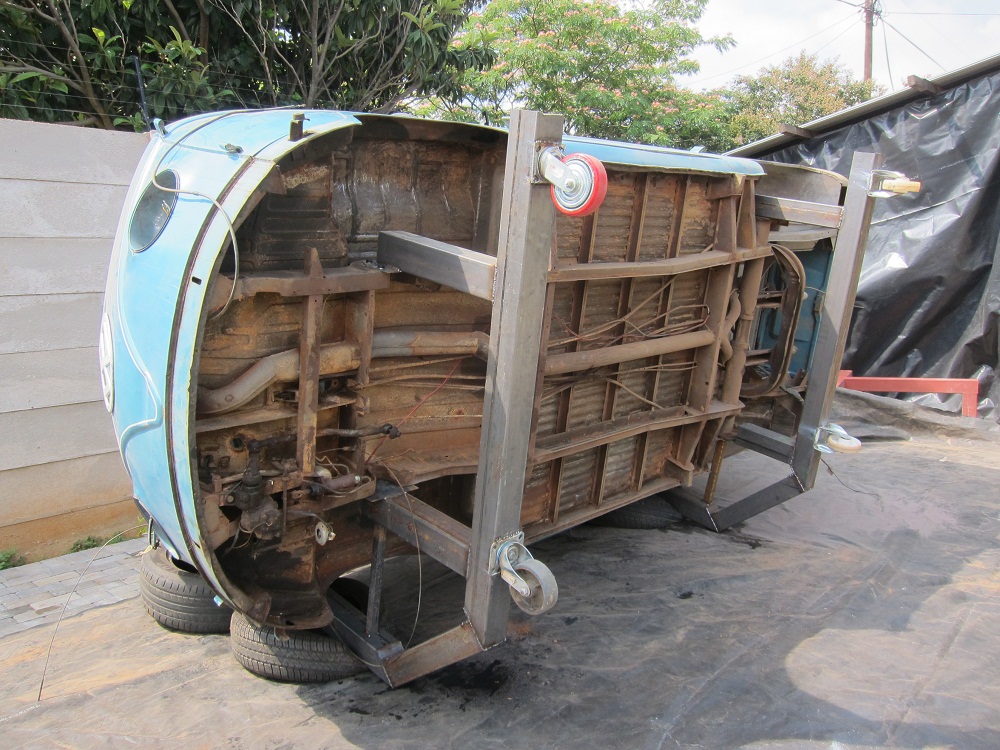

I build this pretty simple "roll on it's side" frame for the bus today. This should make life easier to work underneath the car. I'll know tomorrow how well it works.

Neat.
Please do let us know... That's almost exactly what I've been toying with for mine.

I like the simplicity of this construction. The 2 "nearside" castors are going to take quite a bit of weight once you start tipping the bus, do you think they can handle it? It might perhaps want to "slide" or slip away at this point, they don't look like they have brakes. Some wooden blocks or similar might be an idea so that when you start tipping, the frame (and weight) immediately comes to rest on these blocks or chocks ?

I think Paul has made the correct call.
Love the simplicity of it, but....
Think you need to fit a sharp "drop Pin" on the 1st corner, that can be locked in place, that you can set to bite into the ground when rolling.
Then lift it out when you have polled it back on the castors. for wheeling about.
just my ten trillion Zim dollars worth.

Use some conveyor belting when tilting it on its side,I would say turning it over might be OK but when you tilt it back on its wheels is going to be more challenging as when it gets passed the pivot point it is going to land very hard unless you have some sort of a anchor point that you can control the lowering of it .

Thanks for the advice guys. I know this is not the ideal "rotisserie" , but I needed something simple and quick. I won't be tilting it over that often, well hopefully only once
I'll use all your advice today and let you know how it went.

I think what Herman says makes sence, you need to either lock the wheels ( if they can handle the weight, remember the weight will shift to the side walls of the casters thus putting pressure on the bearings and centre bolt at an angle not designed for) or take pressure off it alltogether with the popout stands once you start rotating.
When rotating get someone to pull on some nilon straps from the top of the rig whilst you roll it over, for a smooth roll.
I would go one further and complete the the entire frame somewhat resembling an octagan similar to Buggers.

Just like you guys I had my concerns as well. I used some bricks as stoppers and tires to break the fall if necessary. Only needed 3 people to turn it and to my surprise it went smooth and effortless. I think I got lucky on the length of the kink on the frame. It worked perfect and in my opinion very little stress on the wheels. I would not do it any different if I had to do it again.
