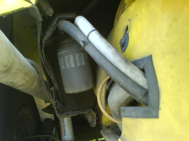

O ok...but wouldnt a 1835cc be nice aswell?for daily driving?search wentzel and just give him a pm...maybe he'll et them go for cheap...use dont use it...he offerd me them but didnt mention a price,seriously what can it hurt??anyway watching carefully to see what you do so i can follow suite, any pics of that filter setup yet?later edmond

I haven't forgotten about the pics of the filter setup

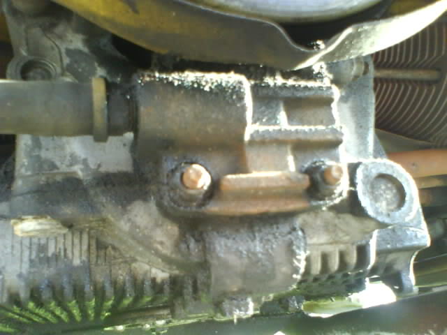

Thanx alot edmond!what exactly do you need to do it?that oilpump coverplate with the oulet,the case taped for the return pipe,the adpater for the filter and a filter and pipes?

Dude, I hope thats proper oil hose.

TonyZ its proper oil hose can withstand high temps and 300psi pressure got the hose and fittings from Hyflo.
Ive had the hose on the car for almost 9 years never had problems or leaks despite it being pushlok hose
Dubster what you mentioned is all you need its really simple.
The oil pump cover plate and filter adapter ive got is Dave Ingle DICE items its really good quality stuff dont know if theyre still
available though
available though

Running the same on the Speedster and it really is that simple. The beauty is adding a external oil cooler, just a couple of pipes and you're on your way. I'll be adding this shortly into the setup!! As far as i know, Dave R. can sort the cover plate. If you need a blank, let me know, i might have one on my spare casing!!
