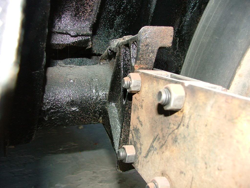

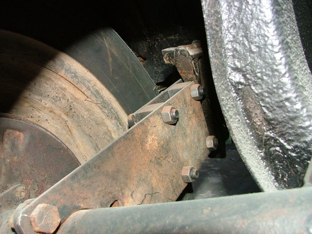

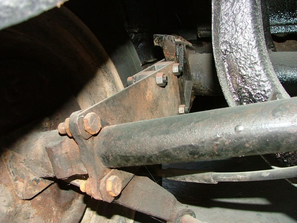

regardin your spring plates , i put a spacer between my spring plates, i will post a pic with what i mean,
hope these pics help !!!BAB

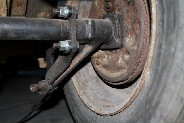

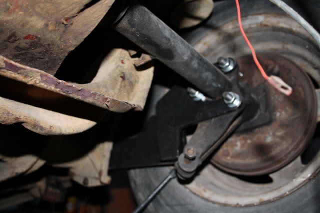

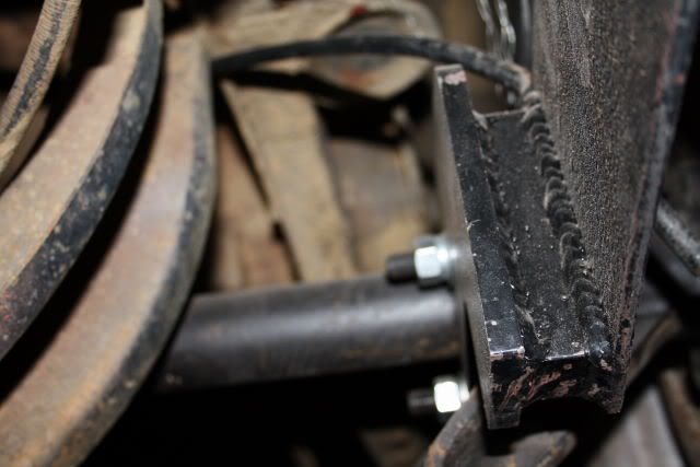

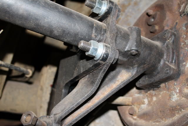

It was a very tight squeeze to get them in and the holes to align with the axles, but saying that its the first time that I have ever removed the spring plates and axles off of a car.
I have notched spring plates with the "spacer" welded in. With the spring plate in the original position it should give me a 3.5" drop at the back without using splines of the torsion bars, difficult to see from these pics:
